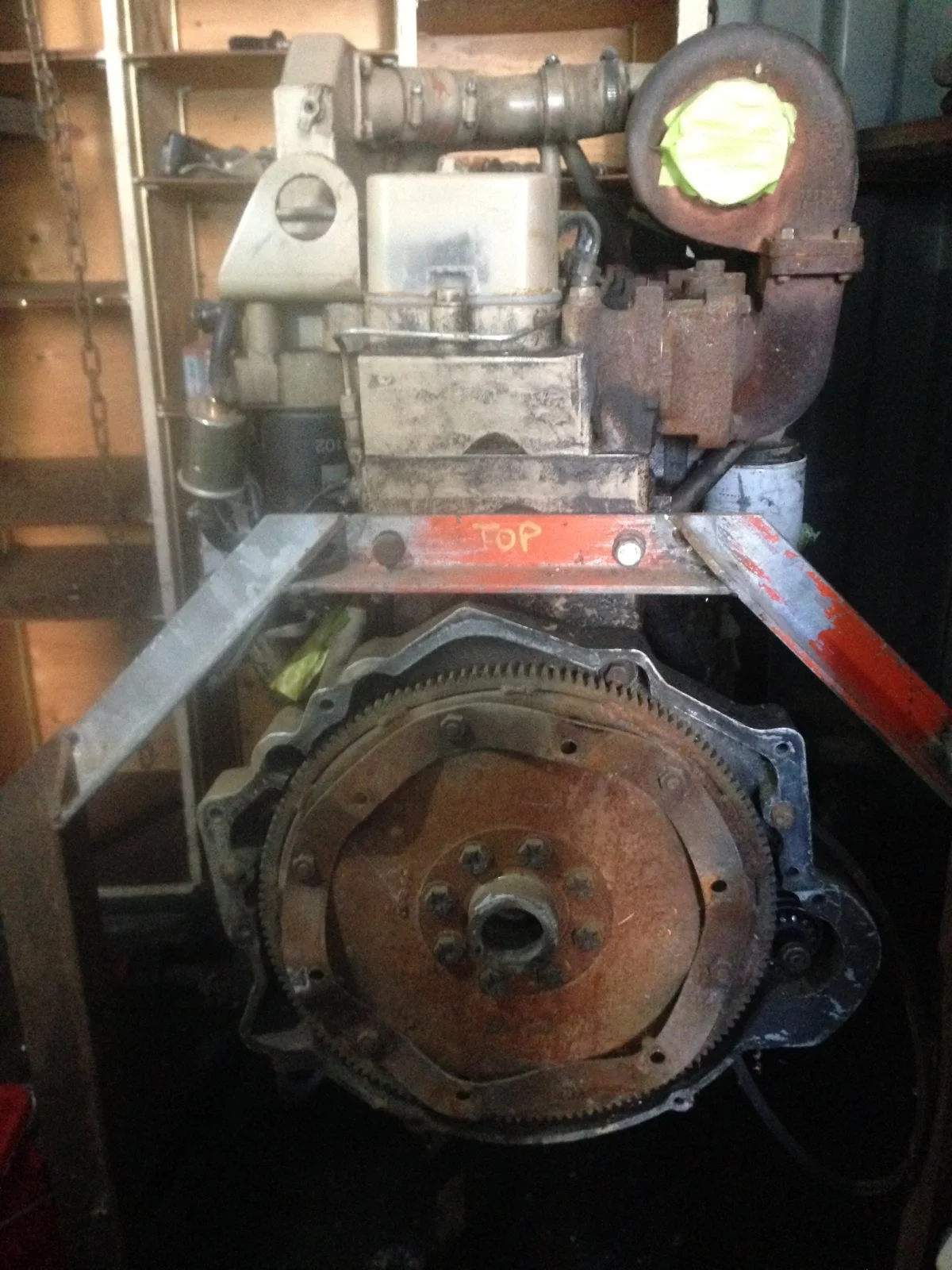

I started collecting parts for my upcoming CUMMINS -swap
-Anyone with information as to where to get a adaptor flex plate between engine flywheel and the torque converter of my 4L60e tranny
- as it shows in the attached pic , I do have a bolted on wave-ring on the flywheel of the cummins
- JEFF Daniels staff knew exactly what I was talking about , over the phone,but apologized for not being able to supply said part
- no luck with NOVAK and ADVANCE ADAPTERS
- if push comes to shove , I'll have our local machine shop build me the part
Much Appreciate your input
