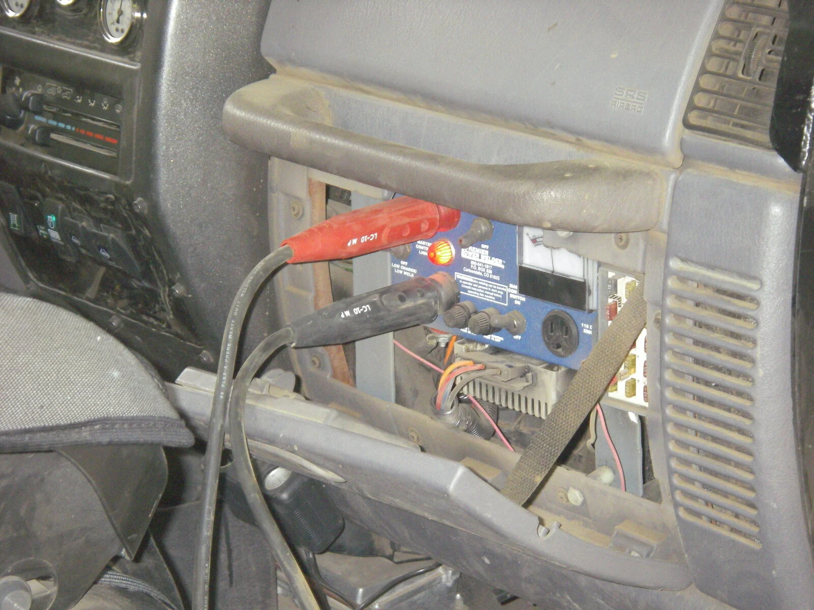

I got an email from quickdraw today and Chad said the milling should be done on my bell housing this week and should ship out next week. I got my R2.8 alternator back from premier power welder ready to go with my welder. The install is going very quickly in my sleep, now I just need to start the transplant. The 4.0 has a phantom miss that might be a bad crank sensor that has only been in for a couple of months. A very nice 4.0 will be for sale soon.

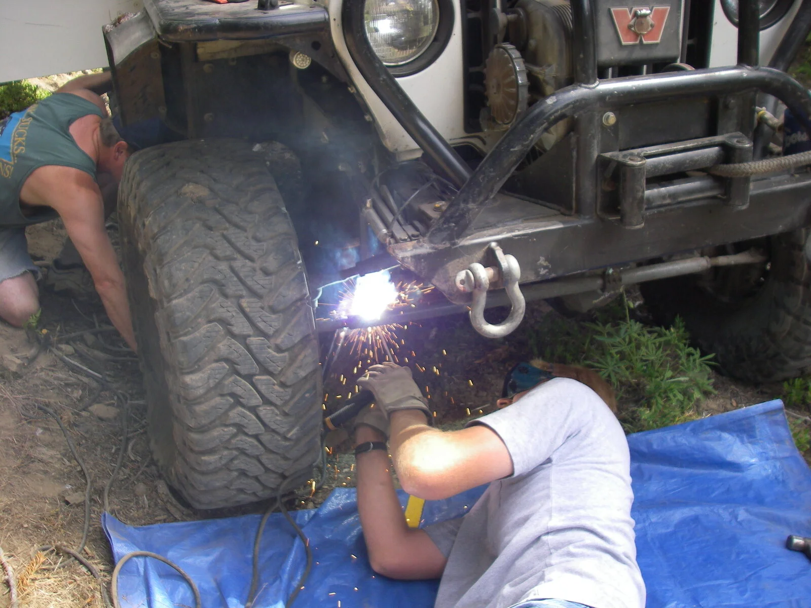

Have you used their welders before? That sounds like a really good idea. Now I'm really interested adding a welder to one of my trucks.
Flux cored wire might be pretty handy in the field for me.
I have one in my TJ.
