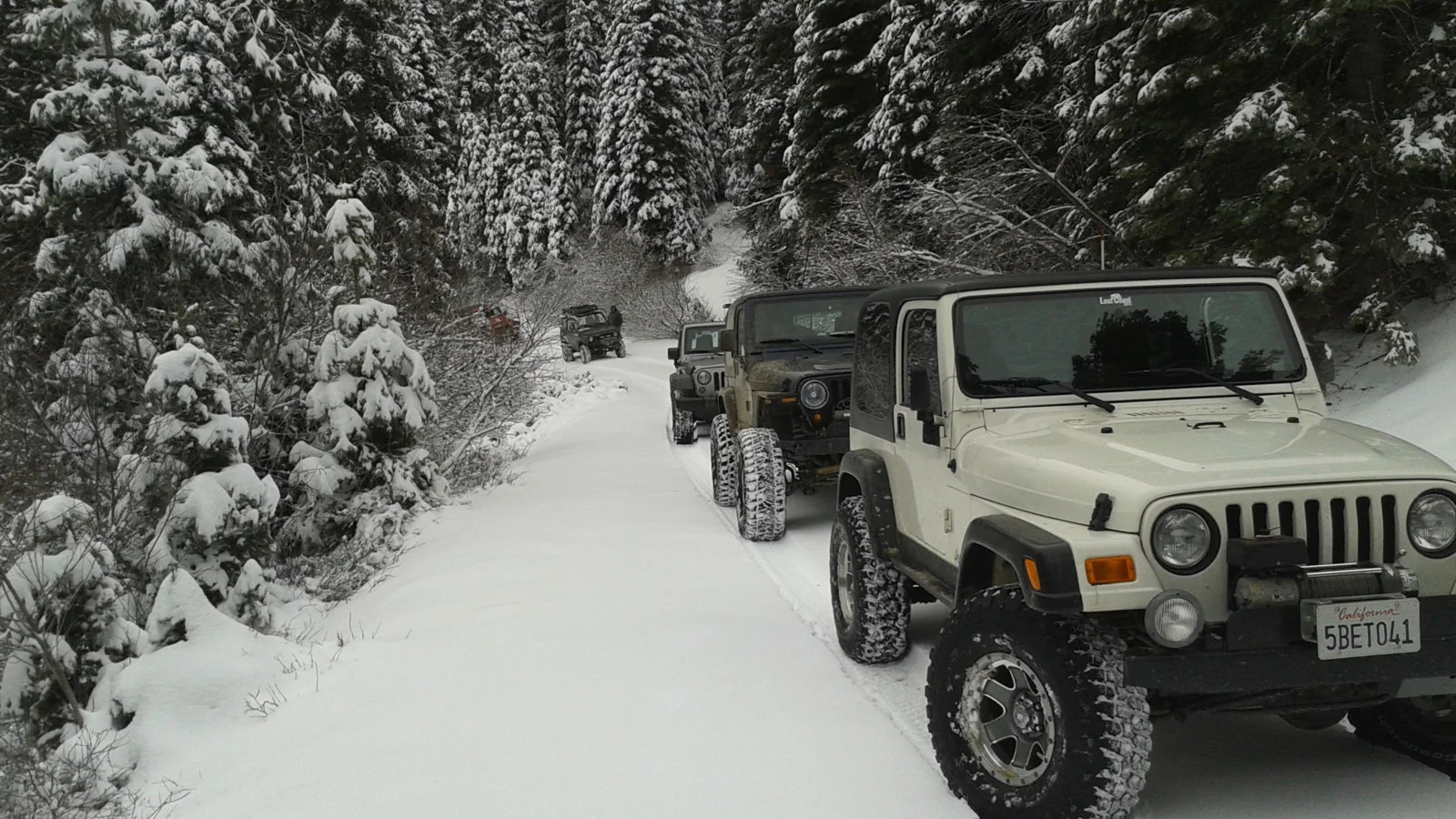

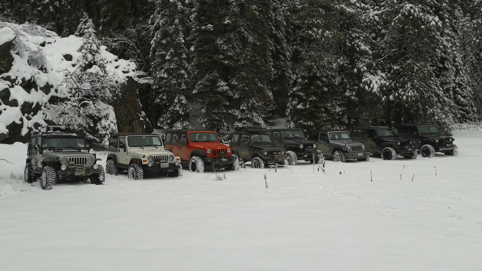

I typically steer clear of snow driving cause my rig isn't setup for it, but once a year we do our annual Xmas tree run in our local National Forest. The KM2's aren't totally useless in the snow, but definitely not ideal. Haven't needed a tug yet. No lockers, LSD rear takes some finesse.
LOVE those pics!
