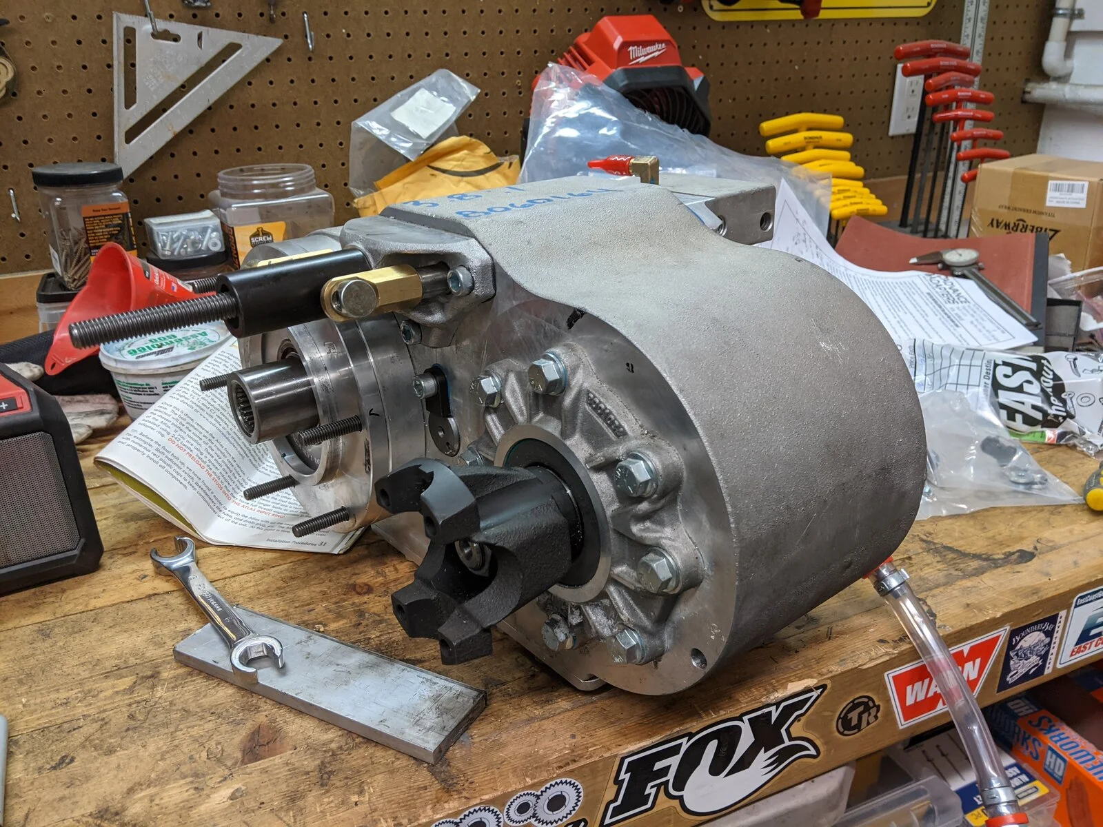

Here she is on the bench getting prepped for final install.
What put you over into an Atlas? Your tires don't look so big yet.
Are those 1330 c/v yolks? What did you use on the JK axles if you don't mind me asking.. I'm told 1330 flanges aren't available.
No they're 1310 CV yolks on the TC and 1310 yokes on the axles as well.
