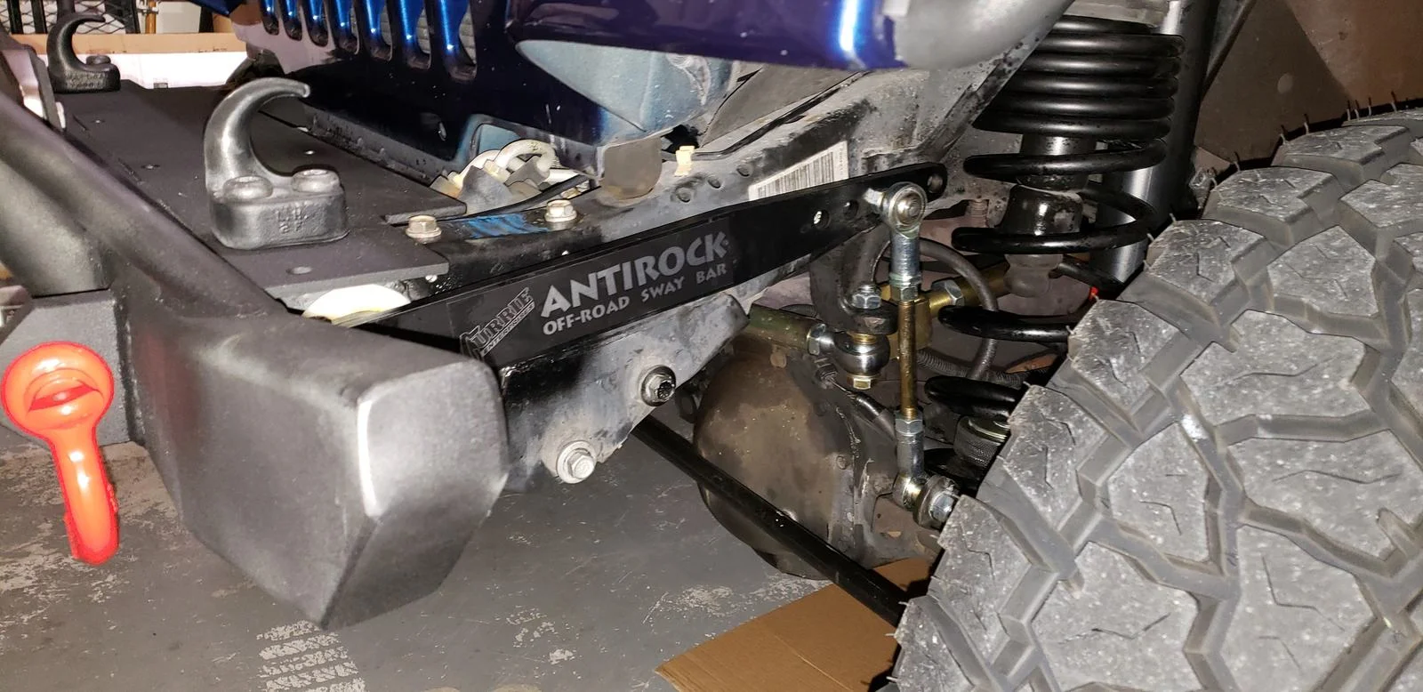

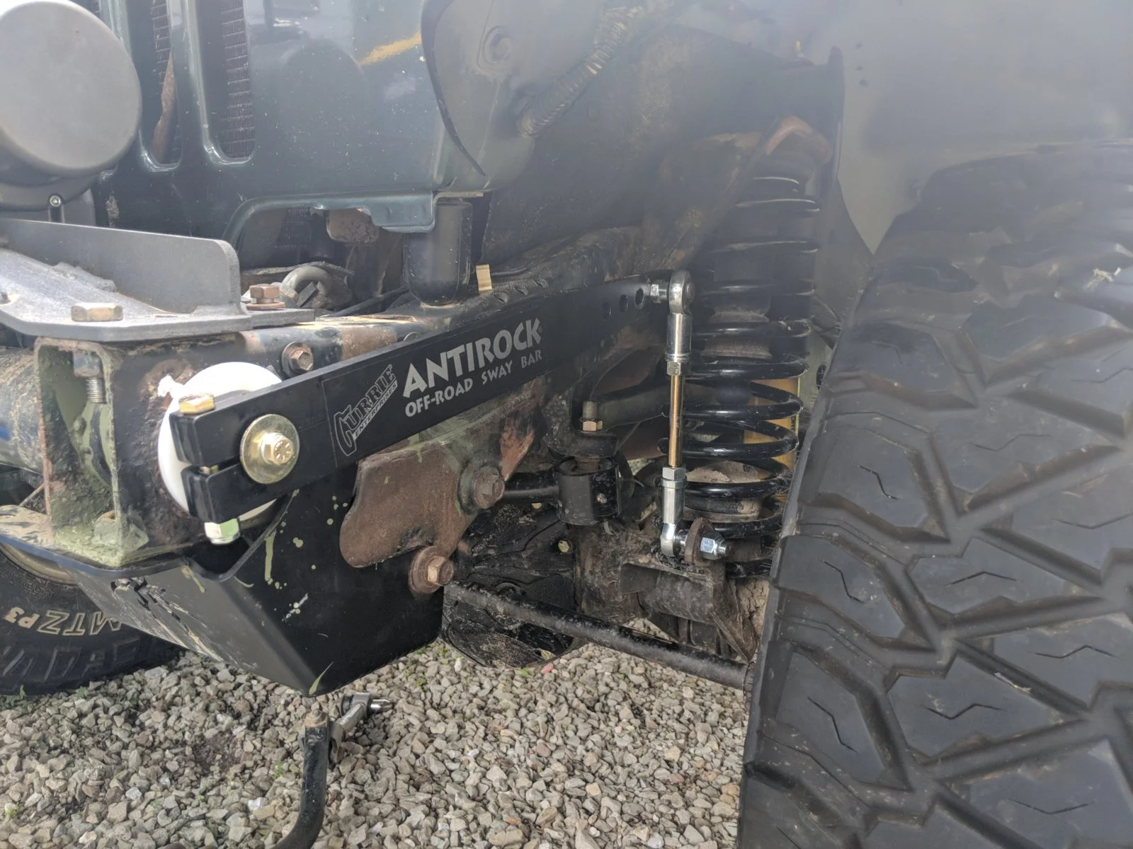

I used the stock links provided and cut down the maximum to allow the jam nut, in short, it works. If I had to do it over I probably would have bought the shorter links to give me a bit more options on the angle. I have the 2.5" OME HD springs.
