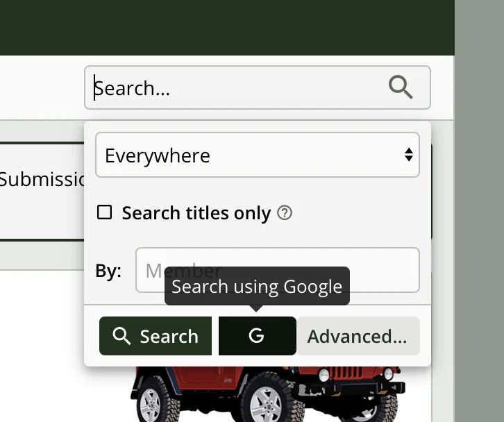

Yep, that is what I'm saying. I spend a lot of time making sure that this forum indexes very well with Google, I'm glad you've noticed it.
FYI, if you want an easy way to search this forum using Google, use this feature:
See that little "G" button in the search container at the top of the site? If you type in your search term and then press that button, the forum will search using Google. The results are always much more accurate I find, plus you never even have to leave the site.
Well I'll be damned, never noticed that before.
