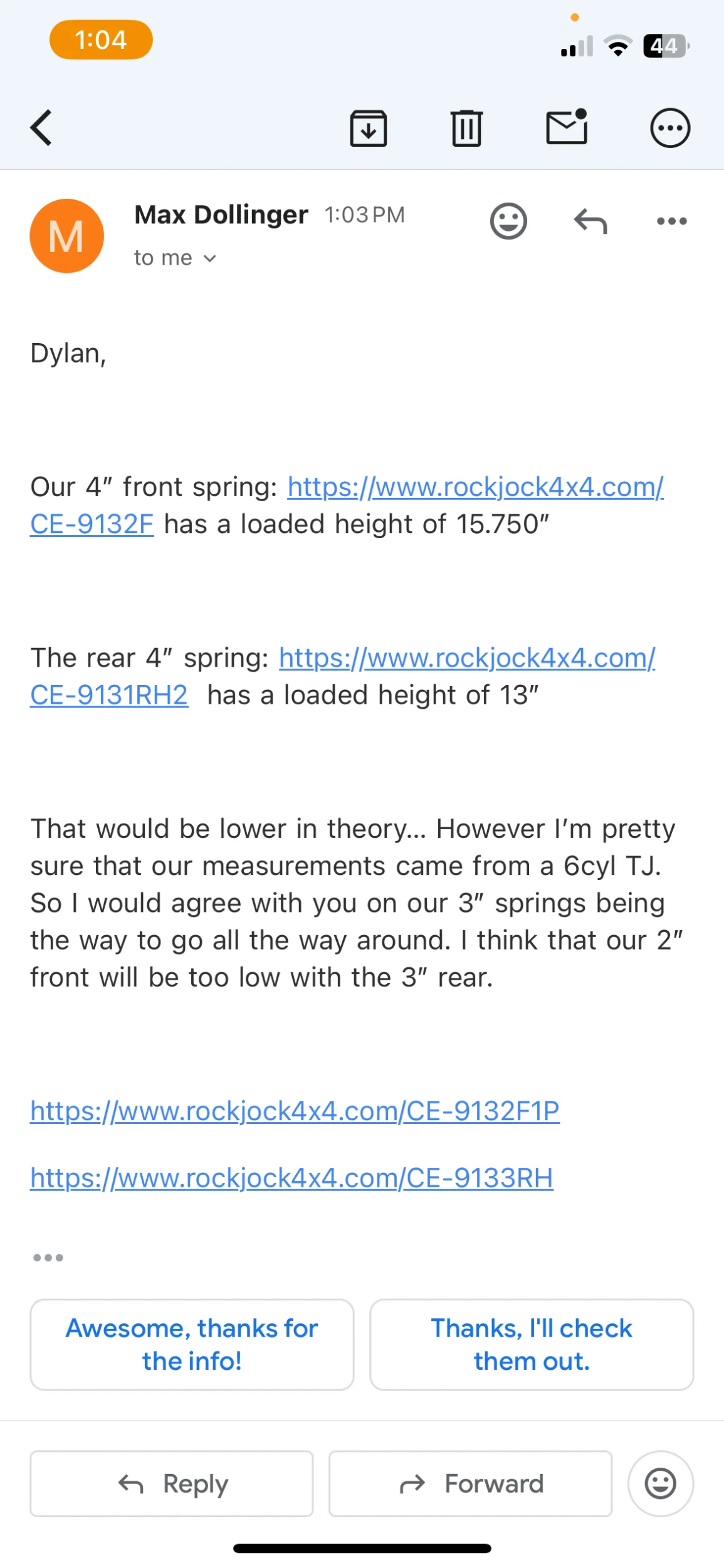

Oh sweet I havnt seen that sheet before so that definitely helps. I also sent an email to max at rock jock to get an estimate. He responded asking for the measured lengths of the coil at ride height which I forgot to do. I have now measured and my front coil is sitting at 17in at ride height and the rear is at 12in. So I believe I’m getting 5in of lift out the front and 4in in the back. I would like to outboard one day thus the concern of travel the spring can support but I’m also not dying for 12in exactly since I know only the 4in Currie can do that. I post what ever max says and a follow up up on what i actually install.

Ya I was a little disappointed in maxs response. I am more inclined to do the 3in front (21.6inches uncompressed) and the 3.5in rear (17inches uncompressed) since they’re only 1inch shorter than the 4inch. While this might be taller than I want the ultimate goal it to have that 50/50 split with outboards. Let that be 10/11in travel rather than 12 and live with the height. I wanted to go a little lower since I’m wheeling less but my goal of the jeep is still as capable and built right of a jeep as possible and not sacrificing up travel for looks.
