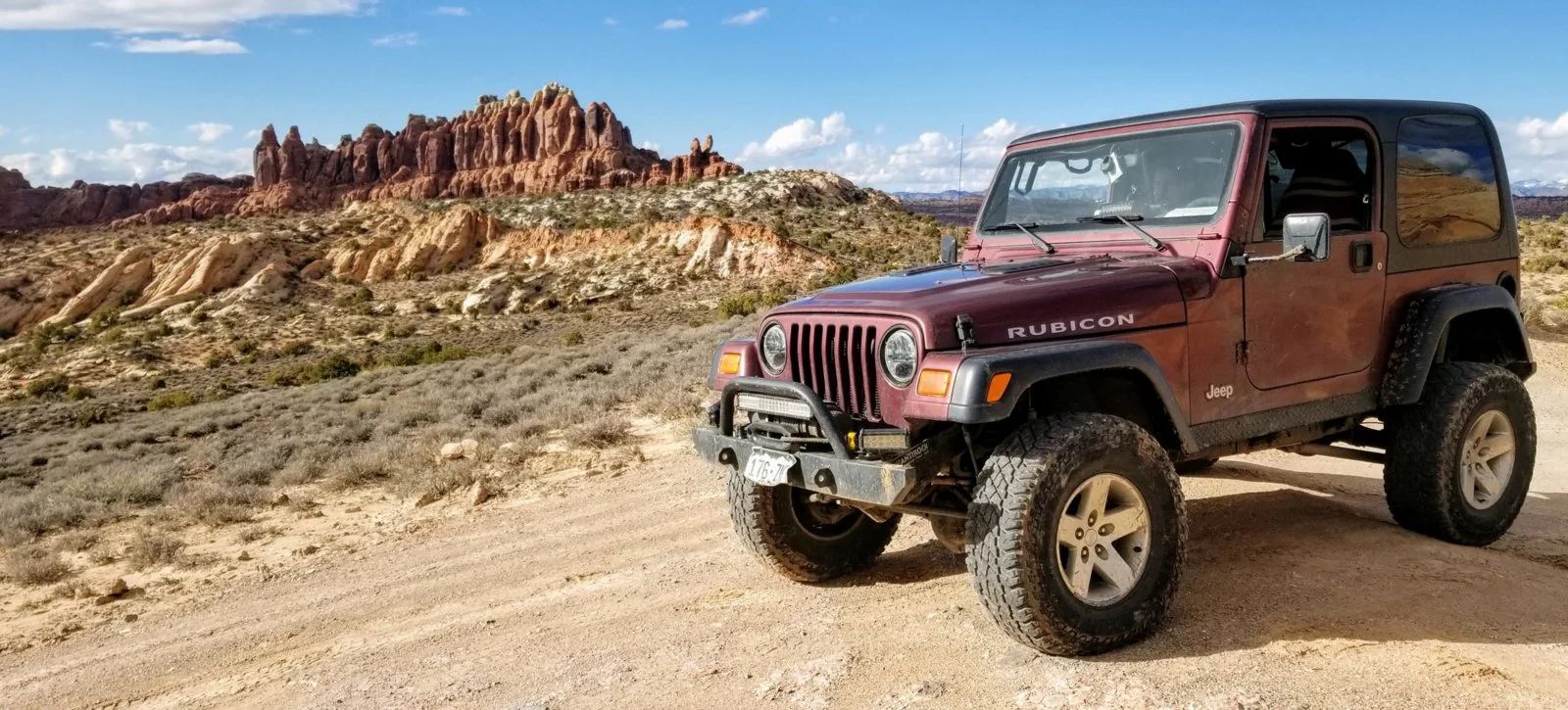

I am looking to replace my front springs with Currie. I currently have 3.5-3.75” of lift. I have a lighter 4cyl. What are you getting as far as lift from either the 3” or 4” spring. I’m guessing they will both run tall on a lighter rig. But figured I would ask around.

I have a 4 cyl, stubby bumper with winch up front and aluminum fenders.
Rear is fairly heavy. Hardtop, steel bumper and swing out tire carrier with 35” spare spaced a bit away from tailgate, 5 gallon gas can, second faux can used for storage, oils and such.
Because the front may be a tad lighter and the rear a bit heavy should I get the HD LJ rear springs that add like 1/2” more lift?
