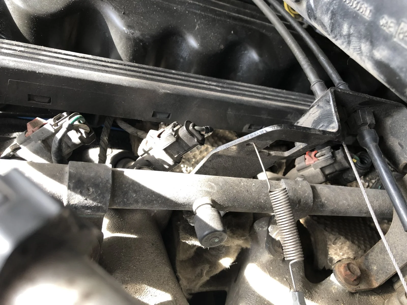

Can someone post a photo of how this shield gets installed, please? I really don't see how I'm supposed to put it on there. Trying to avoid taking it to the dealership. Thanks so much.

Just ordered this insulation due to the exact issue happening to us recently. This forum saves the day again!
Dumb question, how are they numbered? Is it injectors 1-6 starting with injector number 1 engine front?
One more question; the service bulletin states to place the injector at the 2 o’clock position from driver’s side. Should all of the injectors be placed at the 2 o’clock position?
I read that too in the bulletin and found it interesting. Honestly, I would not touch the other injectors, I would just insulate #3 and adjust as they point out to shield from the heat. I'd have to double check, but I believe only #3 on my 2005 is oriented differently (assuming they did this at the factory, but who knows!)
All of my injectors were facing more like 10 o’clock from the driver’s side. I did adjust them all to the 2 o’clock position, which would be 4 hour positions clockwise. Does anyone know their proper orientation?
