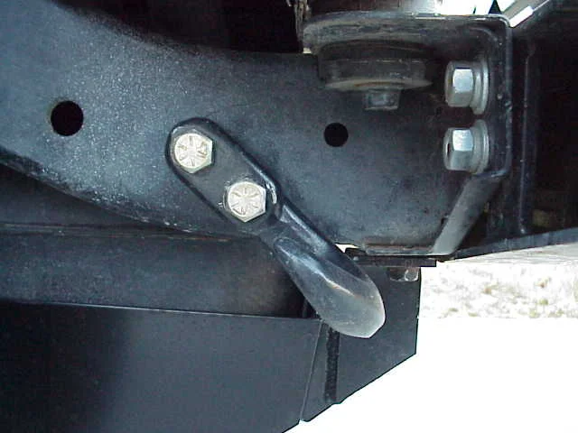

This is how to install tow hooks in the rear... you only need to drill one more mounting bolt hole as one is already there. Do NOT drill-through both sides of the frame, the washers and nuts go inside the frame. They can be inserted via a factory slot on the bottom of the bumper under the hook area.

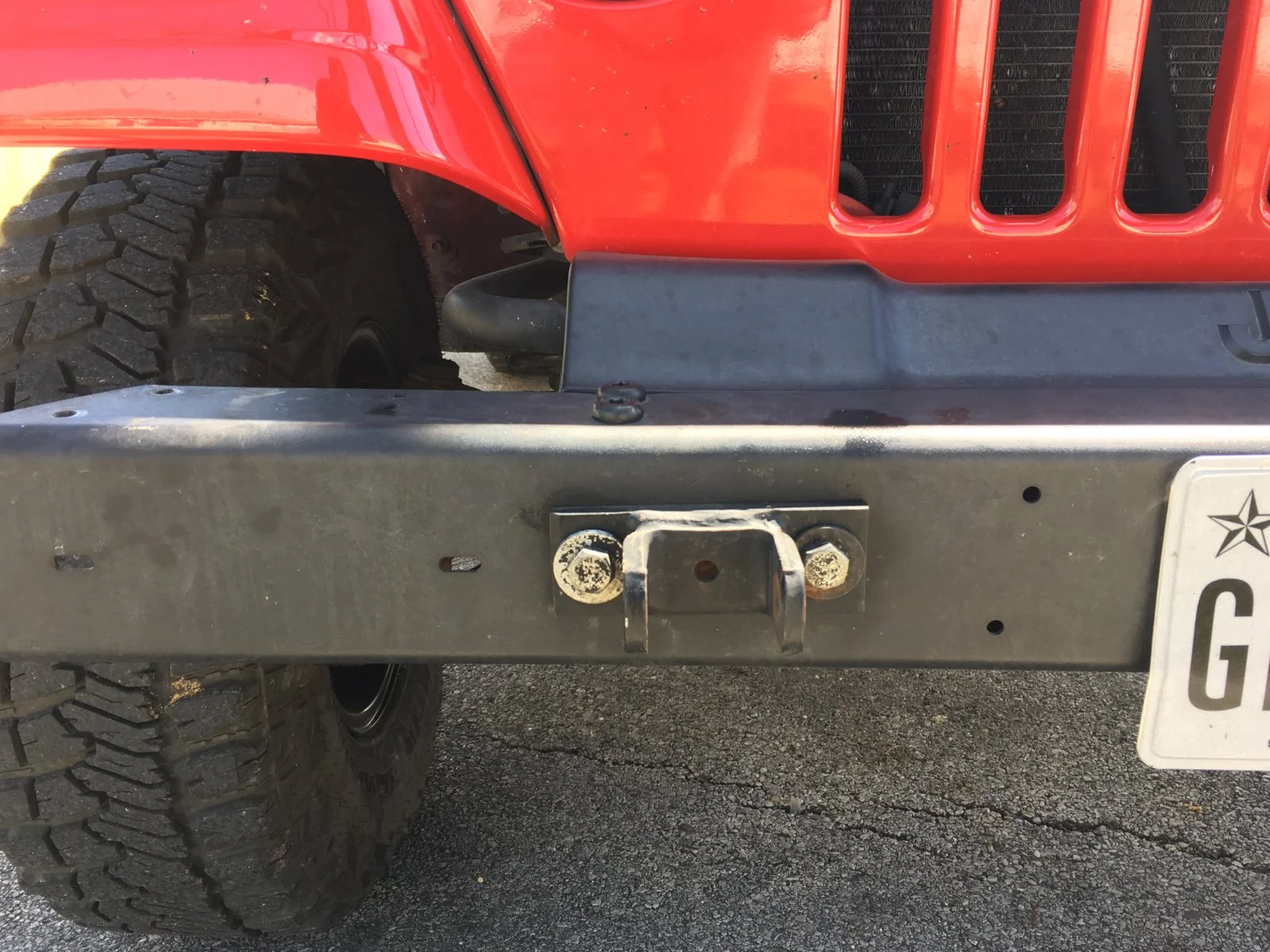

Here's what I have on the front bumper. The two bolts go through the front sheet of metal on the stock bumper but not into the tube behind it. This would not support working DRings, would it?
View attachment 12514 View attachment 12515 Here's what I have on the front bumper. The two bolts go through the front sheet of metal on the stock bumper but not into the tube behind it. This would not support working DRings, would it?
No. That is not for a D-ring, that is for a tow-bar which would exert nothing even close to the stress that a D-ring could during a vehicle recovery.
Just use a T-55 torx adapter to remove the top bumper bolts and install a tow hook or two on top of the bumper. They mount where the top T-55 bumper mounting bolts go.

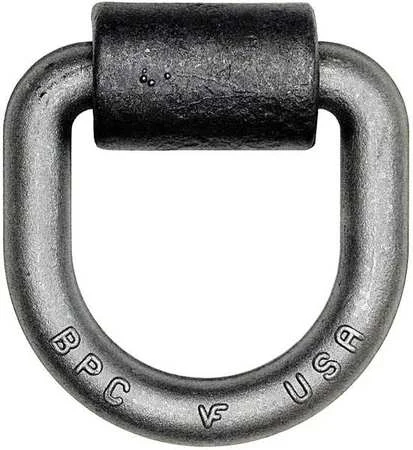

Correctly, this is a D ring.
This is a D ring tie down

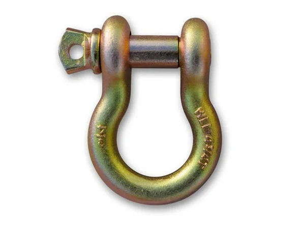

This is a D ring shackle
And this is an anchor bow shackle or bow shackle which comes in the following flavors
Screw pin
Bolt style
Clevis pin
We use the screw pin style the most for what we do.
Over the years though, I've noticed that the tail is wagging the dog more and more and it really screws up searches for stuff, parts, etc. because the folks doing the SEO put every term they can think of that gets the results even close so their client's product. You could probably type in a search for a graphic of the capital letter D and it will pull up a bow shackle.
When it comes to shackles though, my favorite bit of bullshit you can use to find out if a company knows anything about rigging and recovery is if they advertise a tight fit of the hole for the pin in a weld tab or other not rotatable mount so it doesn't rattle.
The number one rule of shackles is you don't side load the pin or pull on it at an angle. If the hole is a tight fit so it doesn't rattle, that means you can only pull straight ahead. Who does that? No one.
