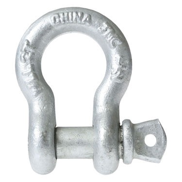

What they refer to as a "D ring" is not a D nor a ring at all. The correct name is Bow Shackle or Anchor Shackle and they come in at least 3 styles, clevis pin, screw pin, and bolt pin. Most common style for our use is the screw pin style.
A bow shackle looks like this-

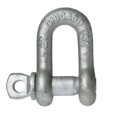

A chain shackle or D shackle looks like this-

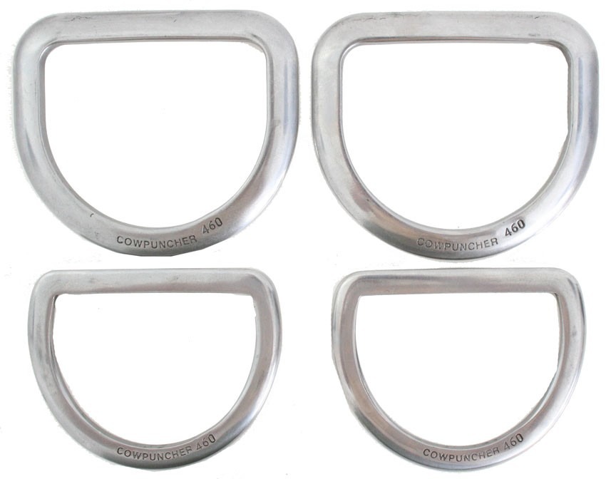

A D-ring is an entirely different animal and looks like this and is typically used for straps and such in rigging, harness, belts, etc.
You can also find D-rings bolted or welded down to trailers and such for tie down points.

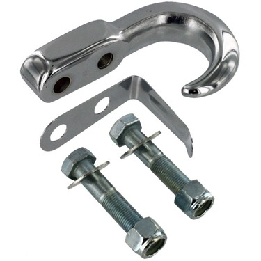

What you need is just a plain old tow hook that will mount on the front part of the frame where the front bumper bolts on.
They look like this-
If you don't have a receiver hitch in the rear, you can find some factory rear tow hooks that bolt more correctly to the frame under the rear bumper and those will suffice to meet most trail requirements.
A chain shackle or D shackle looks like this- View attachment 3304
