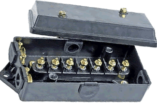

I've got some wiring to clean up and have been looking for one that is small, sealed, and looks like it belongs. The only one I've seen thus far that looks okay, with 7 studs, is from Texas Industrial Electric Company. Their website sucks, but here it is:
[URL]https://www.texasindustrialelectric.com/_junction_blocks.asp[/URL]
JB7-C
7 - #10 Stud Covered Water Resistant Junction Block
These Studs are Insulated from each other.
With Nut & Lock Washer
Corrosion Resistant
Molded Cover & Housing
(5) Terminal Openings
L= 8.059in / 204.7mm, W=3.201in / 81.3mm, H=2.250in / 57.1mm
$33.50 ea.
That looks like a pretty standard junction use on semi trailers that you can get at any truck parts store for $20 or less.

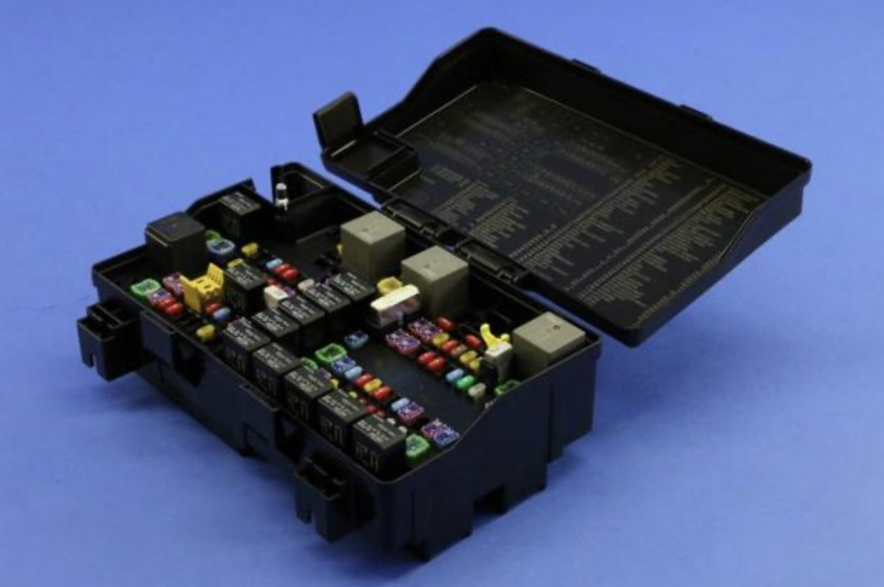

Would it make sense to swap to a larger MOPAR PDC?
https://www.moparwholesaleparts.com...nt-power-power-distribution-center-68322377ad~
The solution for those of us who deal with this all the time is something that looks like it belongs there, comes in various sizes so you can wire up a few things and then have a couple of spots left in case a few other things need to be added. I would never do a larger PDC for several reasons but someone may opt to in a personal rig. I already don't have enough real estate for the standard PDC, a bigger one would just be a nightmare for us.
