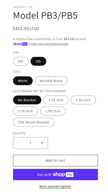

The one I would buy to replace the old one is $750 šŸ¤£
Whoa, how!
edit - the cost for the mount! I did not realize the mount was that much.

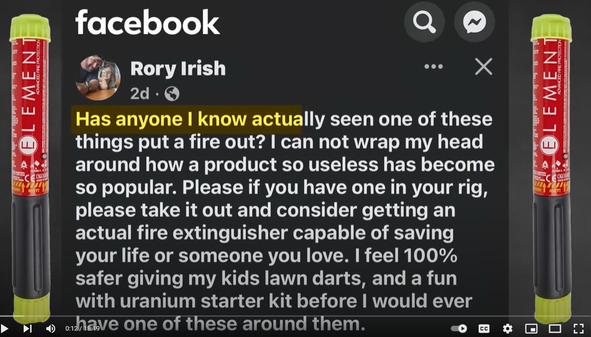

I have been eyeing those element ones but not now. It didn't really do anything and he really got in there. Looked like the 5lb or the b/c worked the best in the video.
Here's Rory's comment
Tested at 5:47 in this one and at 11:03
Element sticks are no good. You are going to want to keep a real fire extinguisher close by.
If I were to stay with my 5lb ABC extinguisher, I see no reason to move it elsewhere from the front of the driver's seat where it has been nearly forever.
That means I still need a mount. All the cheap mounts I see are copies of the Drake mounts.
I would lean towards the Drake. Unless there is another option I am not aware of that isn't multiple latches or Velcro straps.

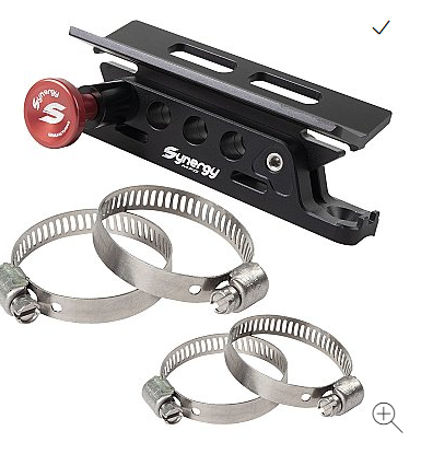

Synergy may or may not be better than the ones you posted, I have no experience with it, and it's $40 plus shipping
https://www.synergymfg.com/synergy-quick-release-fire-extinguisher-mount.html
Features
  • Made from 6061-T6 billet aluminum
  • Designed with four Ball Bearings to reduce rattle between the bracket and the mount base.
  • Single handed quick release knob to easily get your fire extinguisher out when needed.
  • Various mounting options to fit almost any vehicle type.

The knob annoys me because it says Synergy. If it says anything at all, it needs to be directions for use. That alone is worth an additional $37.
