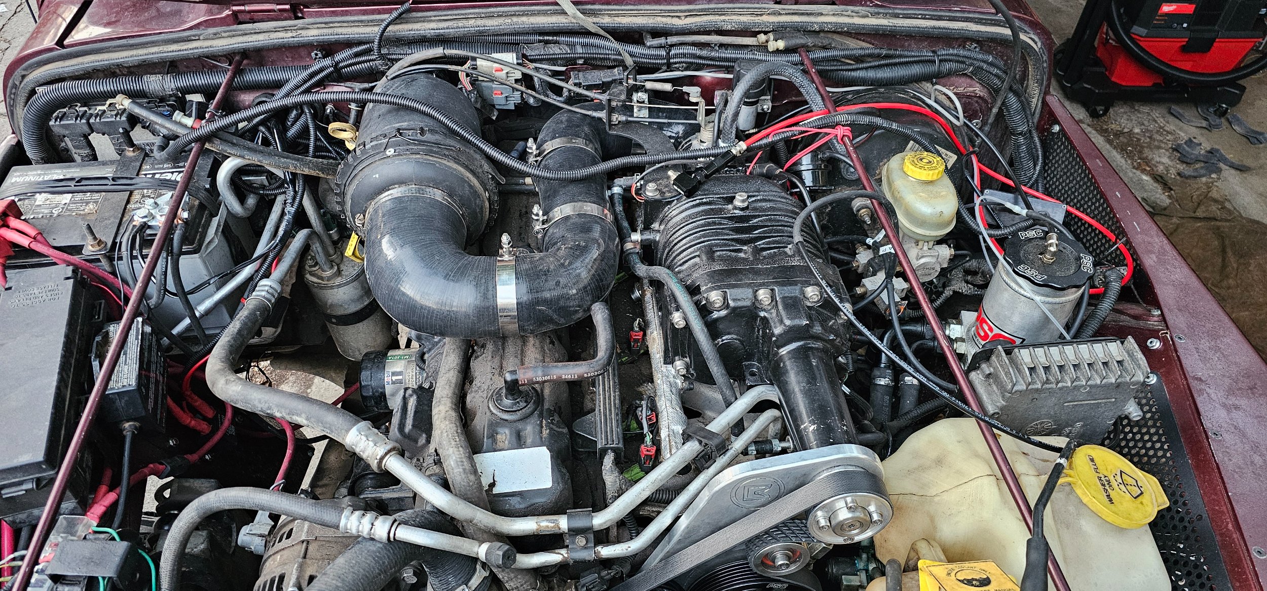

Is there any data on what the ingredients in those various products will do to an o2 sensor? Seems the less colorings,dyes and soap the better?
All I know is the SDS states 30-35% meth and less than 3% ethylene glycol.
On the occasions that I need to use something like Peak or the blue stuff, it would get further mixed with HEET 100% methanol. That dilutes the glycol more, if that matters to begin with.
Are you running an intercooler, JJ?
To be upfront, I also do not know if I need meth injection. I did it out of caution thinking it would at be at least a safety net.
Can you get 93 octane where you are? Fuel will be a big driver as to the need. As I’m sure you know, what you are guarding against is detonation.

Yes and I'm aware. Early on during the first install, there was a violent moment of pre-detonation before I reinstalled the factory fuel injectors.
