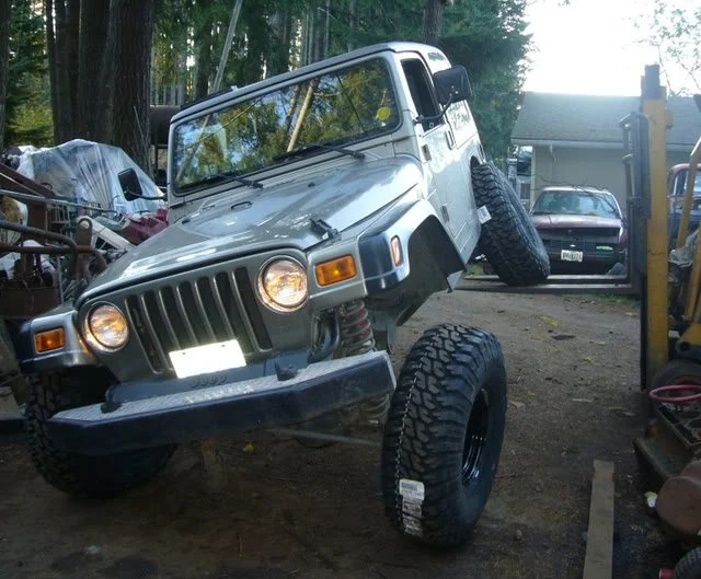

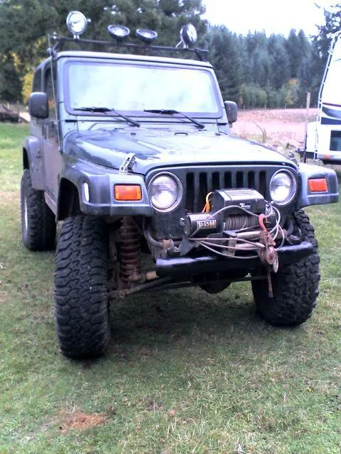

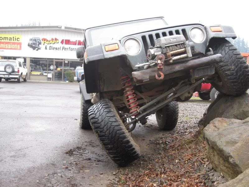

Following the highline idea, many of us are aware of the DIY highline that raises the factory fenders about 3" and also requires cutting the hood.
http://www.higherground4x4.com/Tech/Highline/HigherGround4x4_Highline_Instructional.pdf
These are effectively free highlines with a notable compromise. Take note of the gap/step at the bottom of the fender. This could be covered up with wheel well to wheel well sliders. Additionally, the flares no longer reach all the way to the bottom of the body.

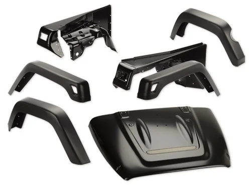

Which leads us to the much beloved and no longer available AEV highline.

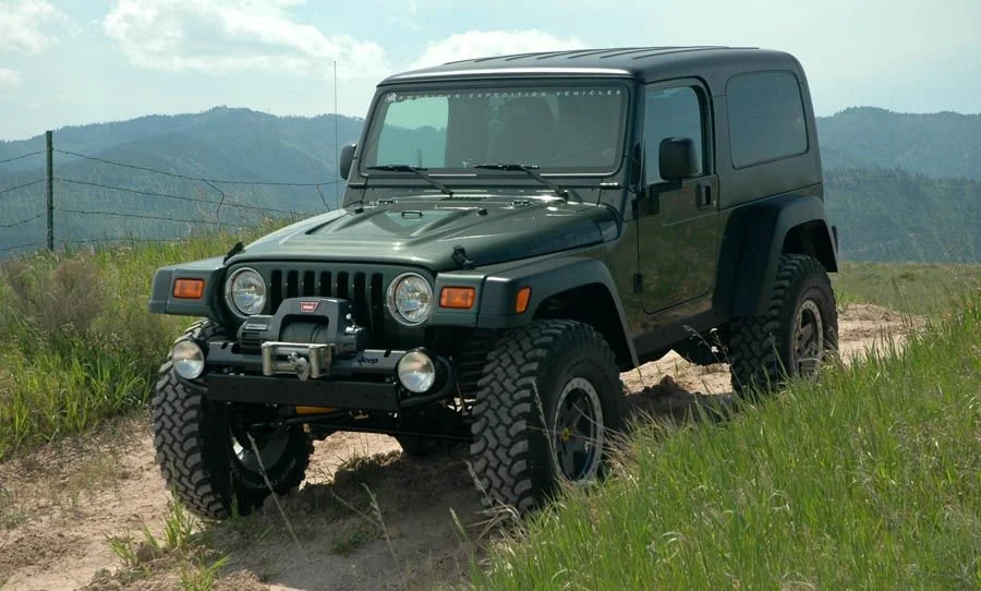

This is not a true highline, despite the cut hood. Look at the step between the inner and outer fender in this image...
The clearance gains from the AEV highline is similar to how Metalcloak and MCE get their respective gains. The raised fender increases flex and/or allows for a slightly larger tire. The interesting difference with AEV is that the interference point of the hood line is further inboard because the outer fender does not need to wrap around the intact hood. The AEV method provides more clearance than Metalcloak, but not as much as a full highline.

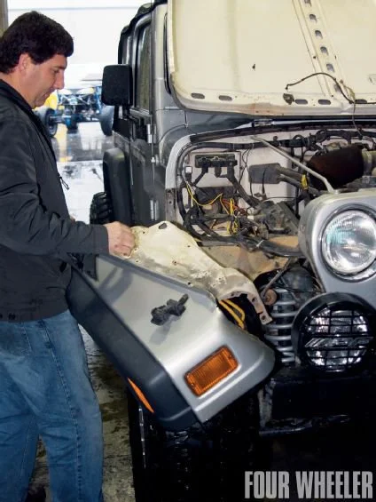

Years ago while we were looking at an AEV kit on a trail run, @UnlimitedLJ04 told me about a guy who made a DIY AEV style highline by splitting the spot welds along the seam joining the inner and outer fender.
Then he added a sheet metal step or wall, just like AEV, to create the offset. This would allow me to keep all the extra stuff I have crammed into the existing engine bay, while adding more room for the larger 35" tire without sacrificing my existing suspension up travel as much, if at all. This is a compromise that falls short of a real highline, but I don't need much in the way of gains. And the work doesn't seem any more involved that some of the other ridiculous things I've done so far.
And, most importantly, the Jeep will maintain it's understated appearance. At least as much as the AEV design allows.
I suspect that there are some required modifications to the internal bracing. But I've never studied the insides of the fender.

For that reason, I'd love a real AEV "Highline" kit if they still made them.
The Jeep West version looks good, but it looks kind of funky / odd around the grille.
