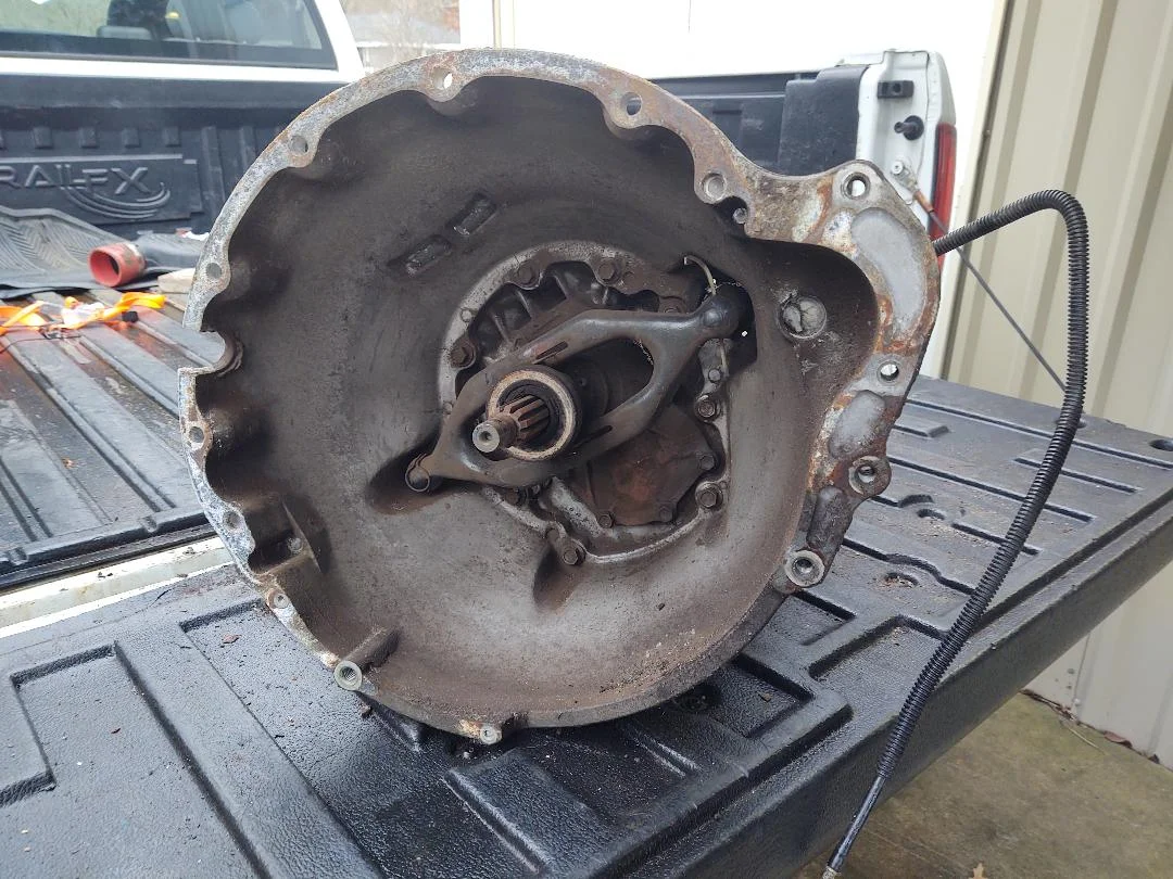

Well, this happened today. I've posted a couple of times about wanting to do a hemi swap. I even had a hemi truck for a bit until it turned out the sucker was seized solid. Anyway, I picked up a 97 3.9l magnum Dakota motor complete with AX15 transmission for $200 today. So, now I have the correct conversion bellhousing and need to sell a 3.9l Dakota motor, which is probably worth scrap value, a 2wd AX15 which should be worth $100? and a pair of headers for the 3.9L. Everything was attached, dust shield, clutch fork, flywheel, etc.
So, piece #1, lol....

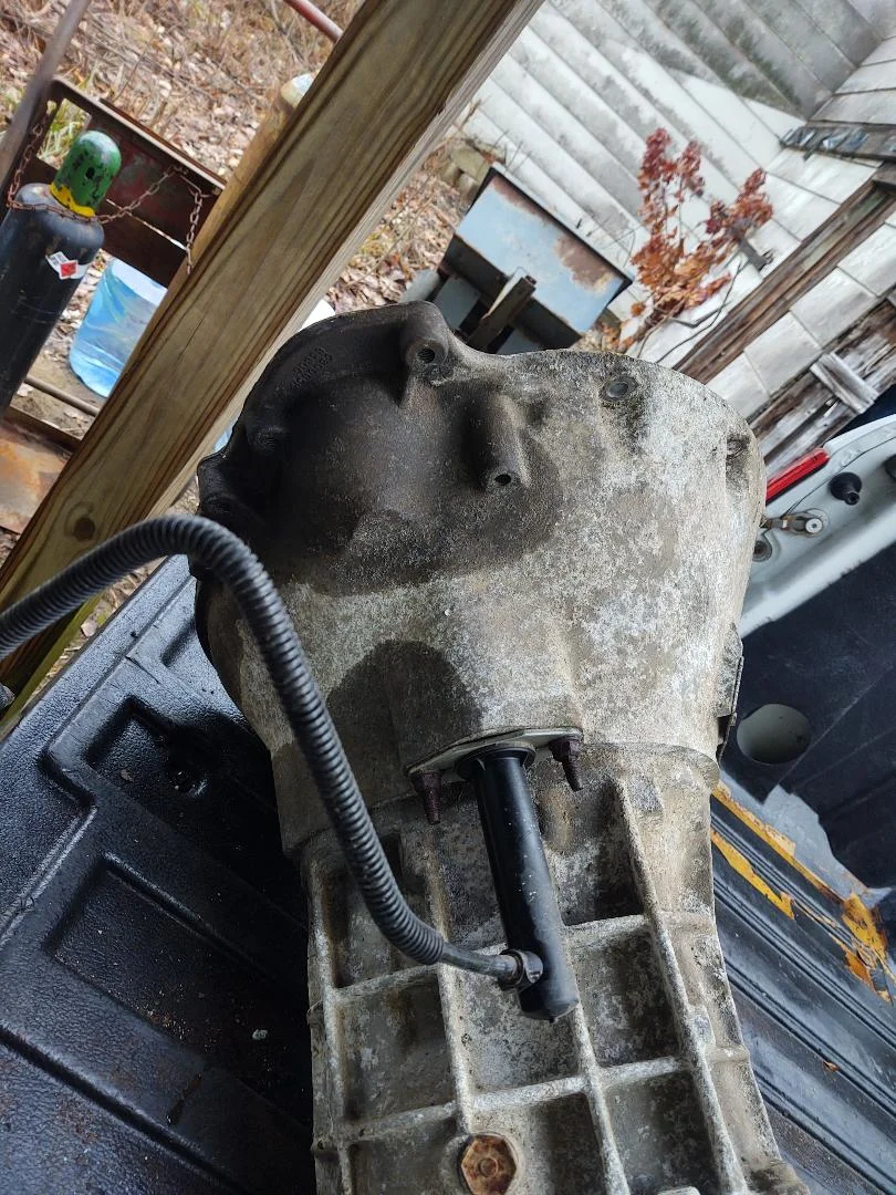

This is interesting and I don't know if anyone has done it this way yet. I think this is the NV4500 with integrated bellhousing. I don't know if this is compatible with the 231/241 tcase or not. I also don't know how much longer it would be than the stock driveline. This certainly would be a great option if it fit as the tranny is much stronger than the AX15/NV3550.
Reactions: hardtailpan
That tranny is massive. When it arrived in the crate. I knew immediately it wasn’t going in the Jeep. Then I started the search for a roll over TJ with the Six-speed in it. The entire Jeep cost me $2000. And being that I live on a military base I couldn’t keep it around long. So I lost some potential sales from scrapping it as soon as I took as much as I could from it.

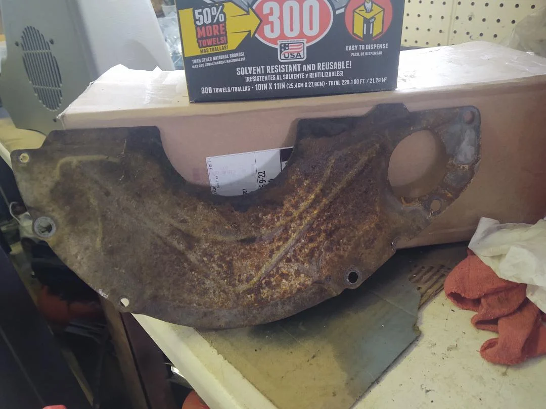

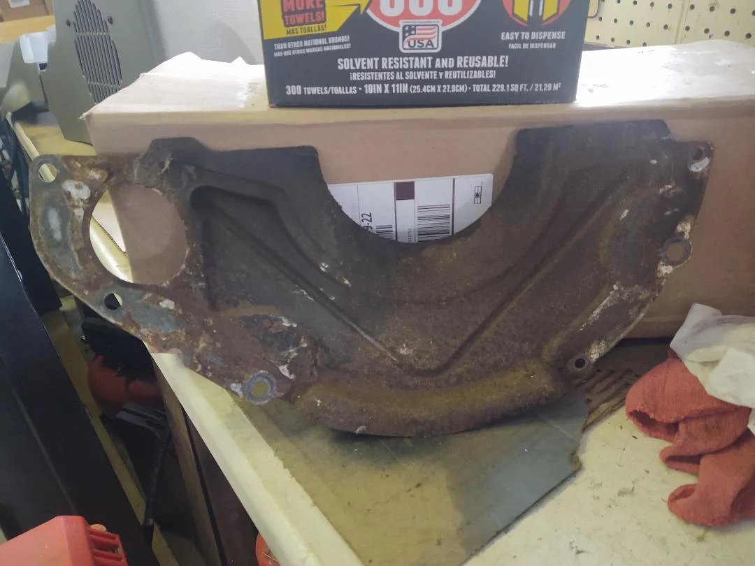

What was the part number on the dust shield? I can not figure it out... Thanks. Or post a picture please.
I'm not sure how much this will help but here are pics of both sides of the dust cover. I couldn't find a number on it but its still pretty dirty and its like 11 degrees here right now lol.

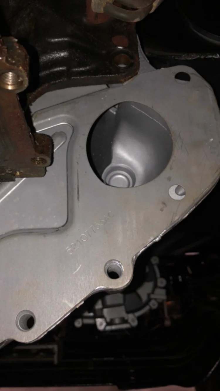

Thanks! this does help alot. I found this cover locally. It was from this 3.9L dakota Bellhousing. It fits the bell housing great! however, it does not slip between the bell housing and Hemi very well. The indentations interfere with the back of the block (Not sure why this wouldn't be a problem on the 3.9). Comparatively, i ordered this cover: 52107753AC from Chrysler for a hemi application. It fits between bellhosuing and Hemi great! however, the starter location is slightly different (wrong for this bell housing)
