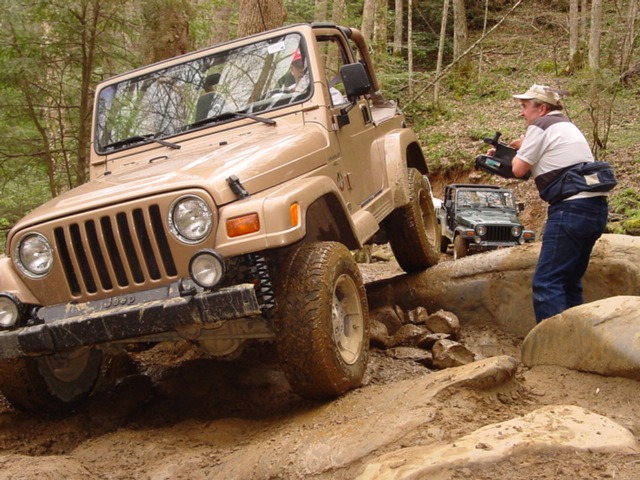

My first Love was a 1999 that unfortunately my brother totaled back around 2010. It was rebuilt and I tracked it down in CO. Hope I see it on this forum one day.

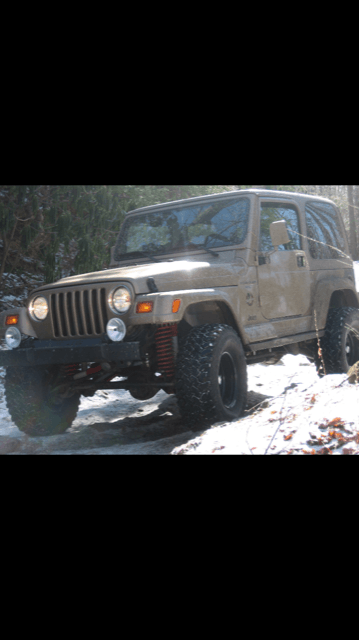

Back to my current TJ. I bought in just before Christmas in 2016. The previous owner had a budget boost on it and 35's.. See the photo from Day 1 of my ownership.
Since then, I've been slowly refurbishing and adding my own touches. The first one's were for Mrs. T's comfort and which led to more money set aside for upgrades.
The first thing I did was lose the 35's and rims and put in new Pro Comp Steel wheels and GY MTR's. I like 33's so went with that knowing I'd need to deal with the suspension at some point. I put in a Bed Rug Kit and then changed out all the seats to Best Top Trail Max seats. Swapped in LED interior lights and a new stereo system. Had to add the Tuffy Glove box for safe storage and then started saving in between tuition and other life priorities.

I really like the end result and will hopefully getting in on some trails in the next week. The Dessert Sand Jeep was the Jeep that started the whole thing for me.
