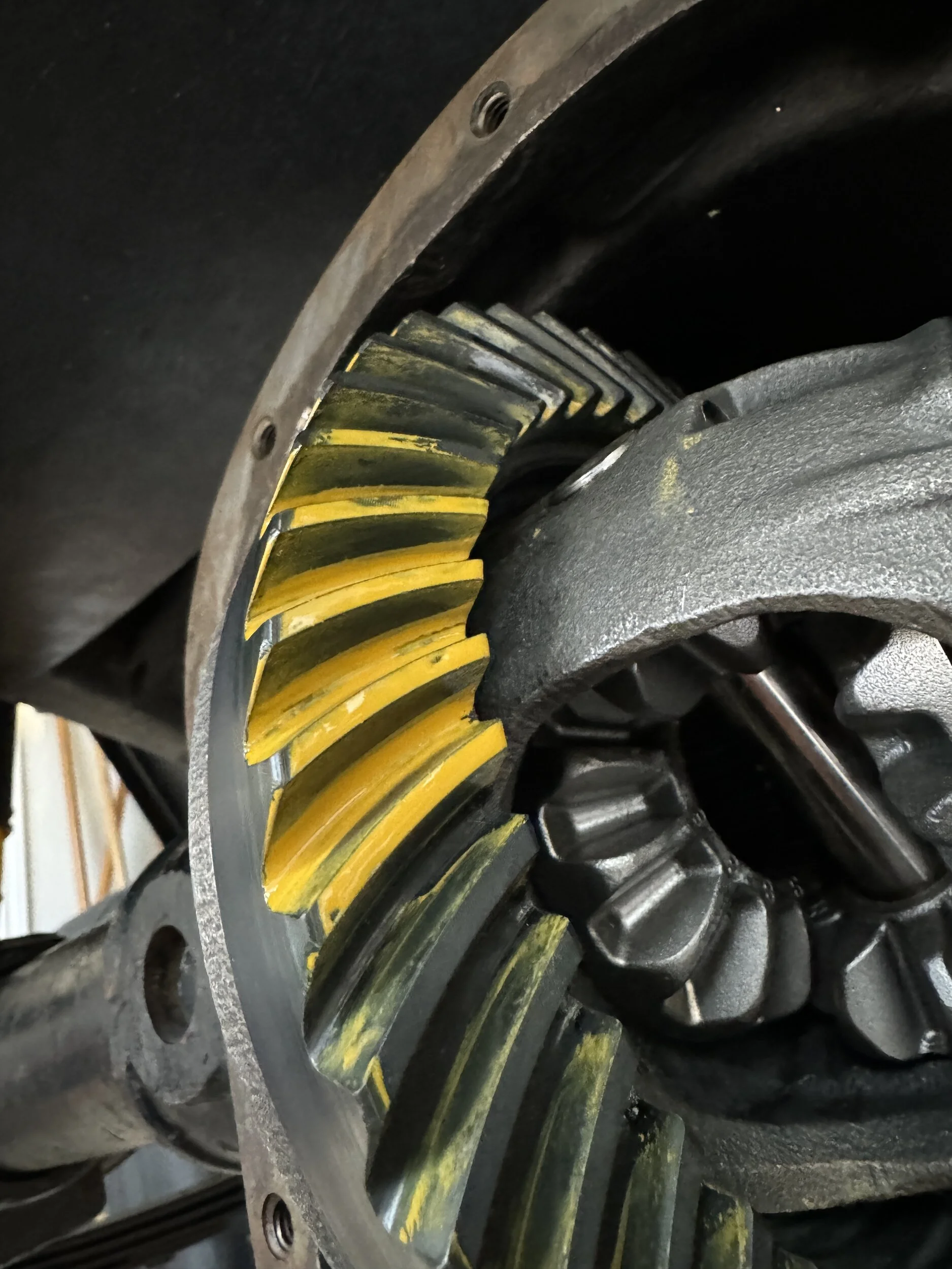

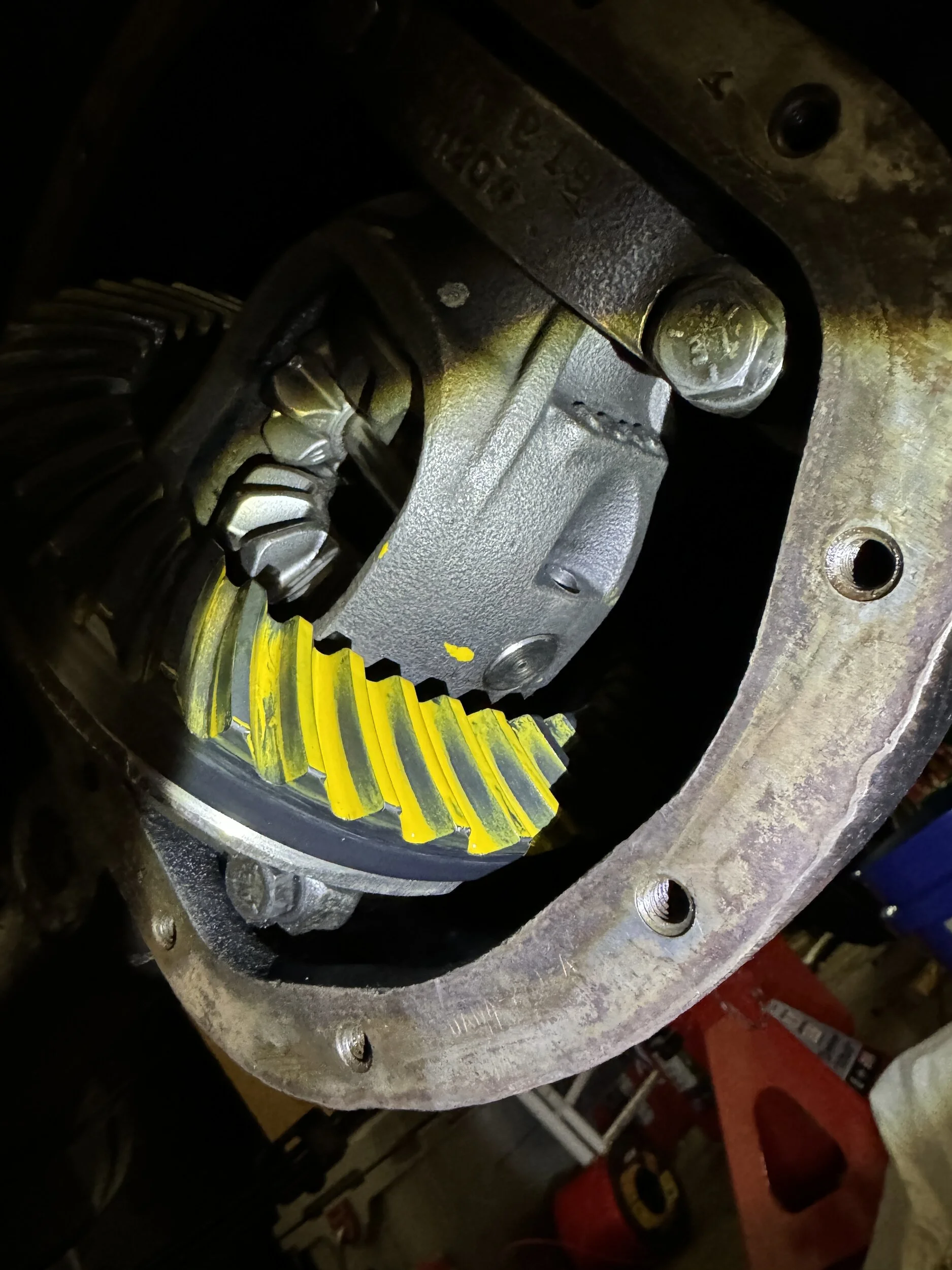

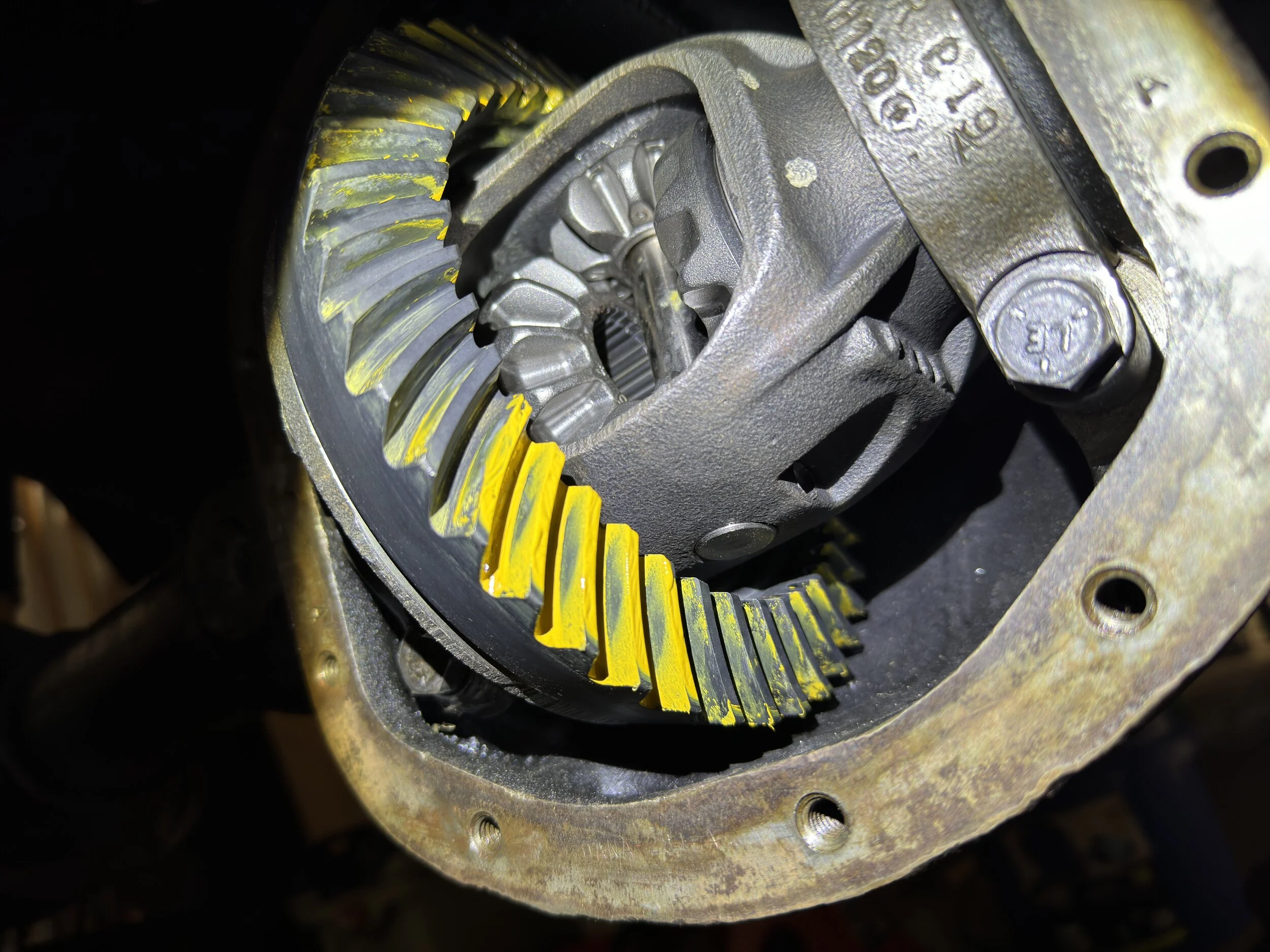

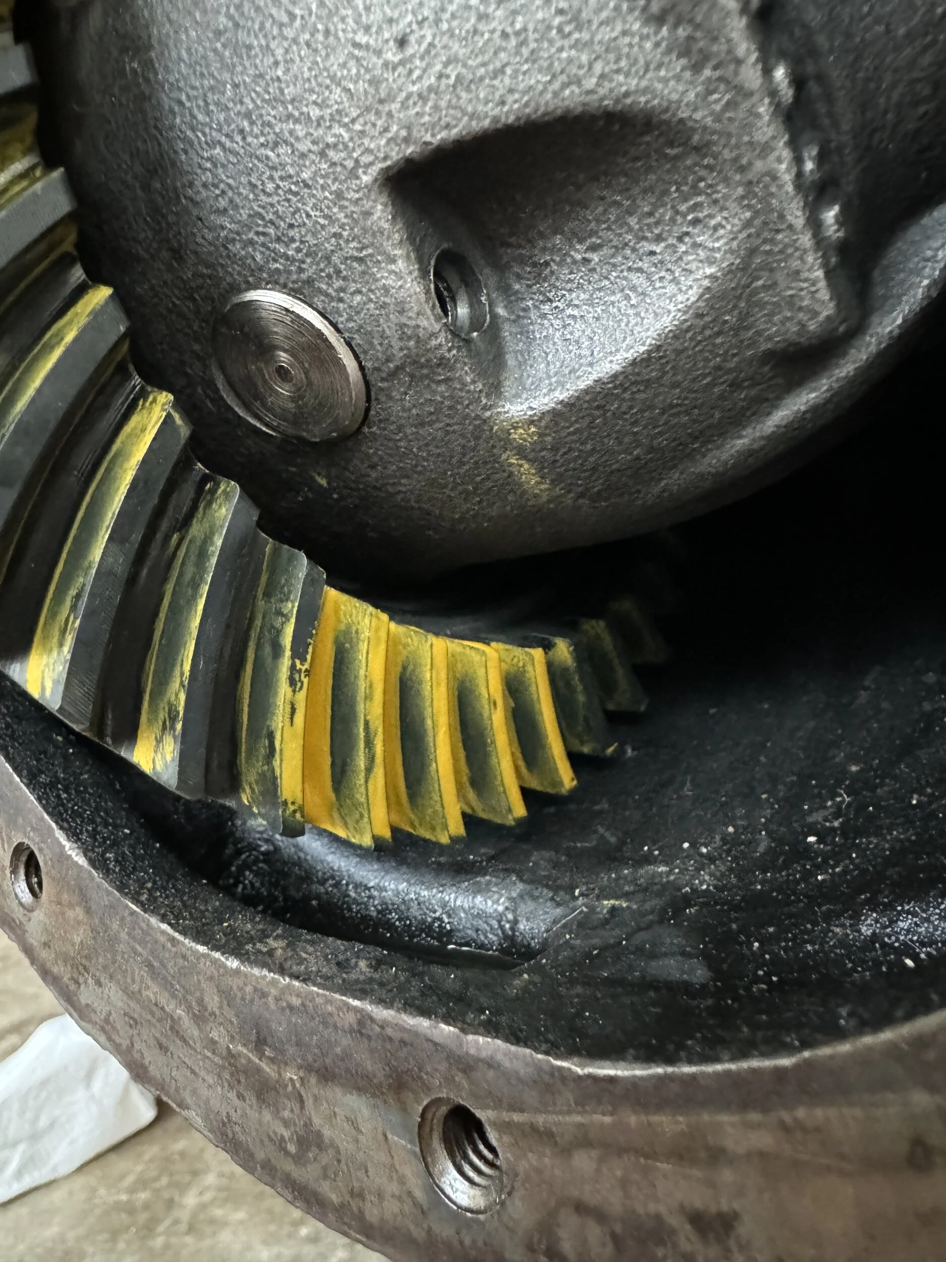

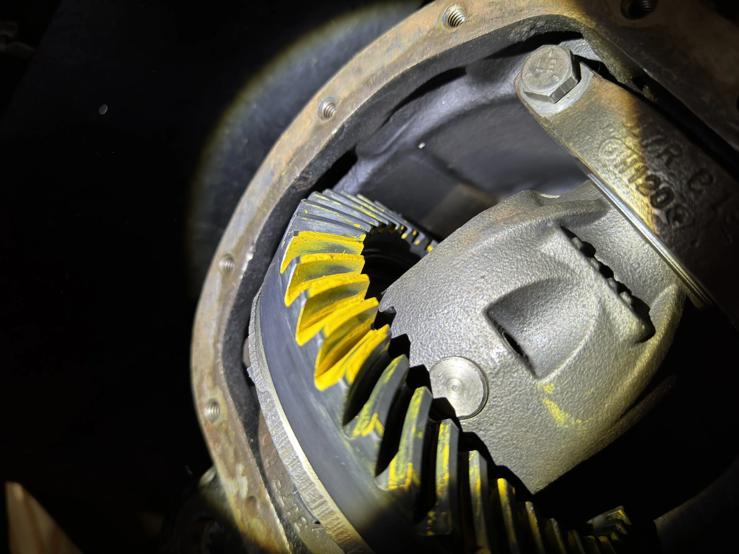

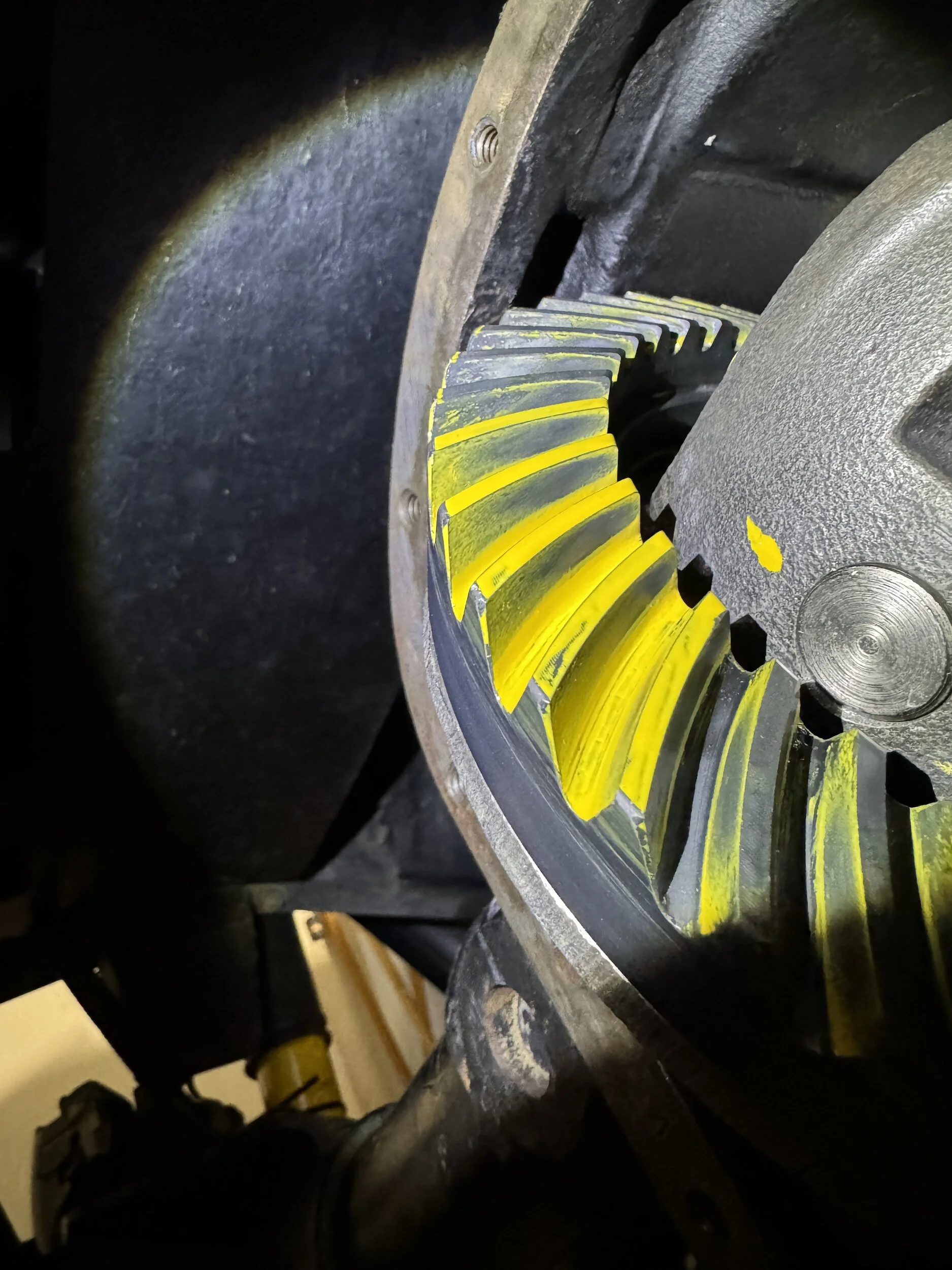

Try going in .003 more and see if the pattern flips.
Just making sure you saw both posts above - it appeared (to me) that the pattern flipped when I added the 0.004ish that I did.
By flip I assume you mean swapping heel to toe on coast and drive?
What do you think?Flipping from root to crown and watching for the hard line to appear.
That second set of patterns look close but I would try a touch deeper.
Is your paint thinned out well? Lots of force on the ring gear getting the patterns?
It seems like it flipped significantly for only .003" deeper. But before doing anything I'd make sure it is a good pattern.
Take your time bud. you'll get there. Whats the saying in the seals? Slow is smooth and smooth is fast?
You are a tiny bit deep.
You have the formation of a fairly hard line at the root and I try to avoid that as best as I can especially if driven on the street. If you cannot pull .002 out of the pack just go back to the previous stack and call it good.
That will run.
