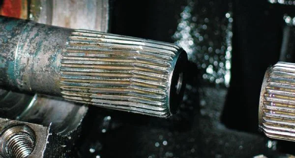

Pretty much agree except a Dana 44 is only kinda-sorta ok with stock shafts with 35" tires and a locker. This shows what happened to my OE factory Dana 44 shafts with 35's and a Detroit locker. Granted that didn't happen with gentle wheeling but it wasn't anything death defying either.
Where 35's are concerned on a front axle, a Dana 30 vs. a Dana 44 is not really a big deal, a Dana 30 holds up fine when with 35's and a locker with aftermarket 27 spline 4340 shafts. Either would need hardened axle shafts if there's a front locker with 35's and you're going to be doing tight turns under power.

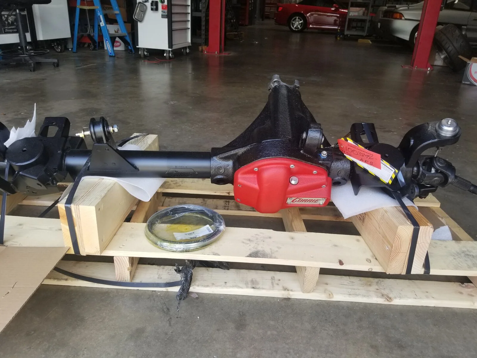

Not all Dana 44's are created equally. There's a big difference between a stock TJ 44 and a Currie 44. I priced out building my 30 front and by the time I would have gotten it the way I wanted the Currie was only a bit more.
Why though? How much did your build Dana 30 cost?
I priced building a 2nd axle HP 30 from a XJ with tubes, gusset kit, ARB locker, gears, axle shafts, "C" gussets, and cover. With labor it was over $4k. Currie dropped my 44 at the door for $4700 complete ready to go in.
