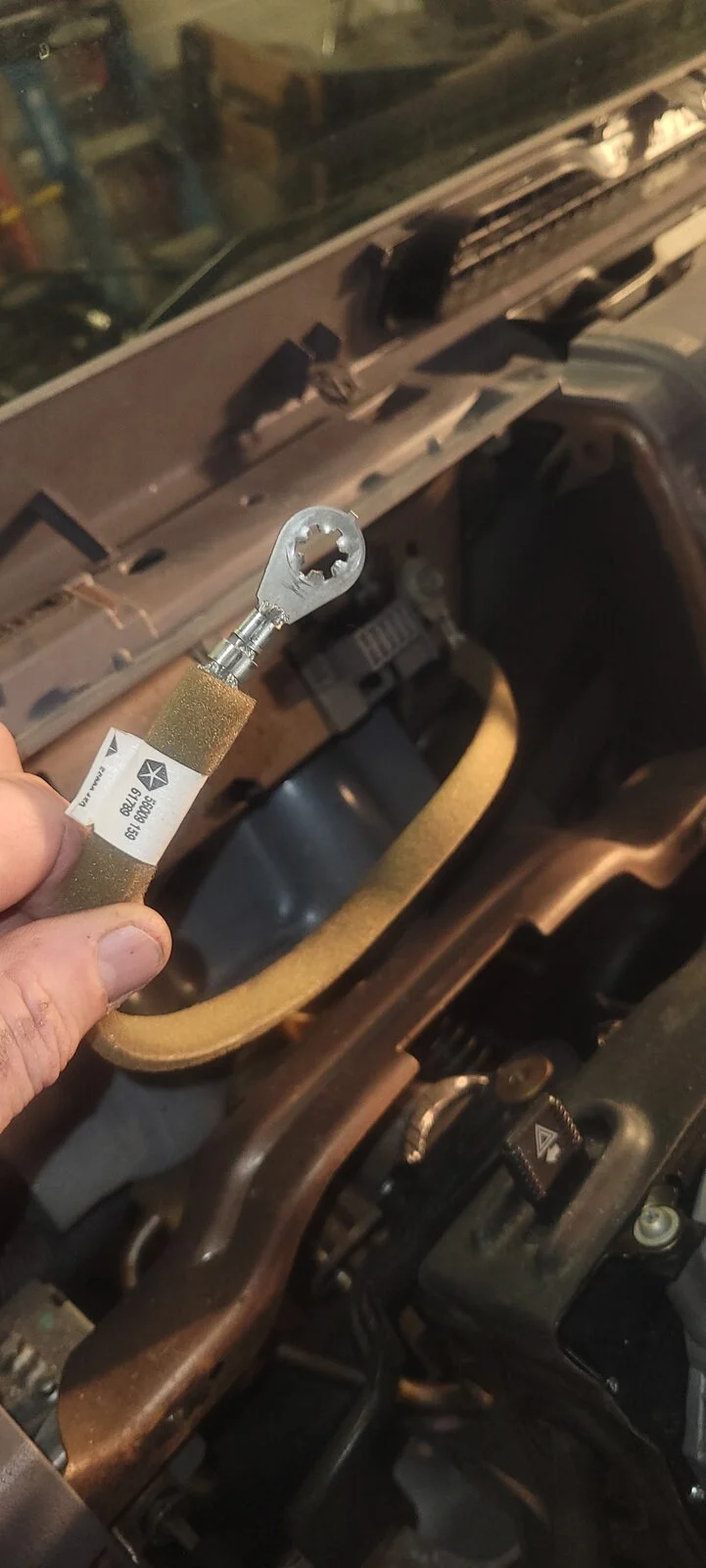

JEEP GC Member Joined Jun 19, 2021 Messages 54 Location Charlotte Nov 30, 2021 #1 1997 TJ Would anyone know where this dash ground goes. Radio?
Daryl 2004 Rubicon Supporting Member Joined Apr 29, 2018 Messages 3,065 Location 🌎 Nov 30, 2021 #2 It attaches to the upper part of the dash. See picture in this post: https://wranglertjforum.com/threads/gauges-dont-work.33315/post-543375 Reactions: D M
CharlesHS TJ Expert Supporting Member Lifetime Supporting Member Joined Mar 10, 2020 Messages 5,555 Location Jacksonville FL, Quezon Philippines Nov 30, 2021 #3 It is bolted to a stud on the firewall behind the dash panel...
SSTJ ——— Lifetime Supporting Member Joined Aug 24, 2019 Messages 3,345 Location South Carolina Nov 30, 2021 #4 What @CharlesHS and @Daryl said. Also, if you start messing around with the head unit, you'll find that it is grounded behind the dash too. (See posts like this.) You have a 97? You might enjoy this thread.
