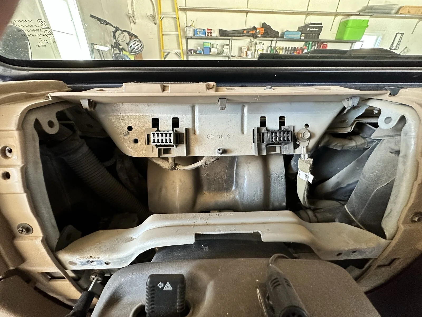

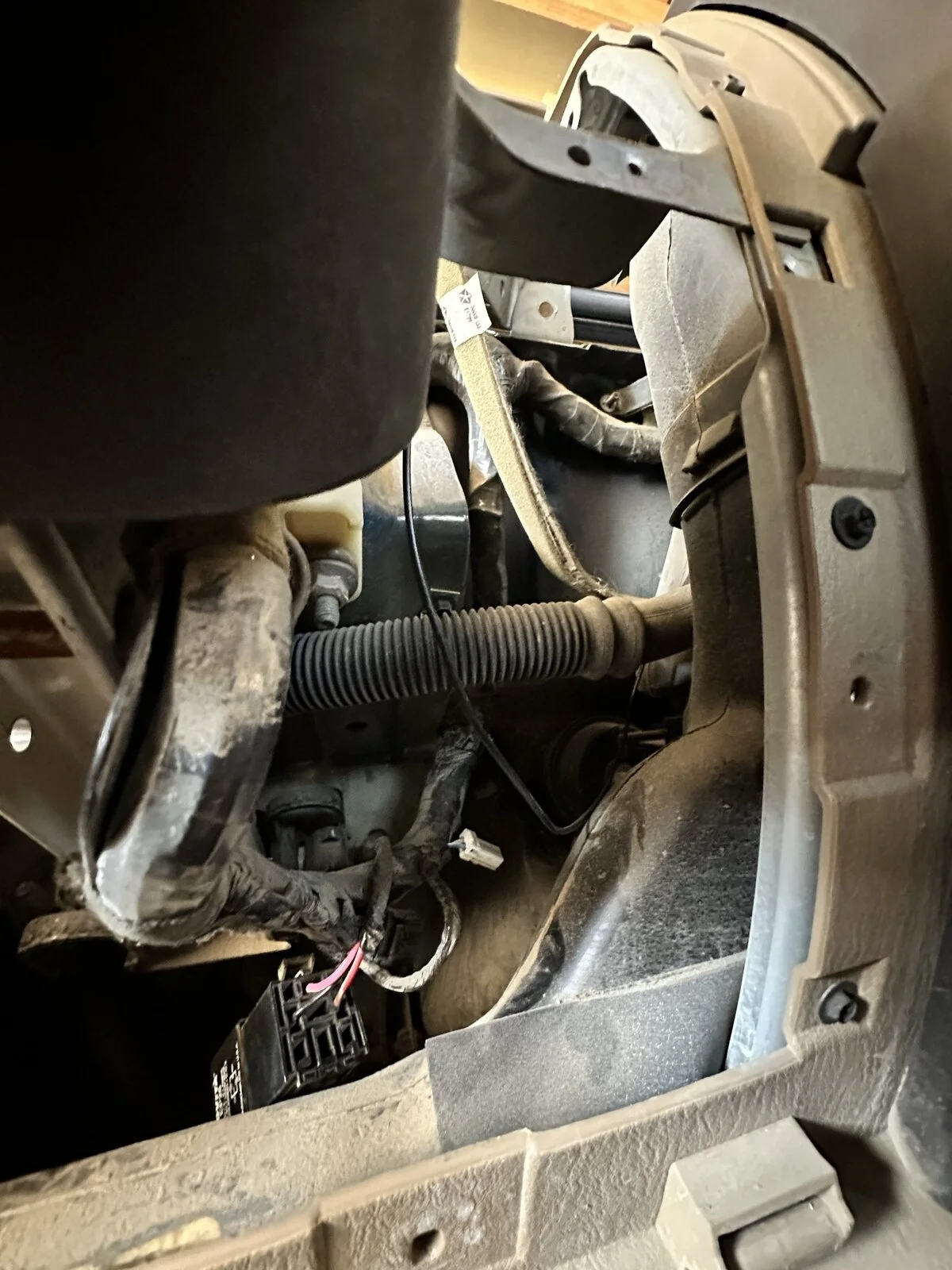

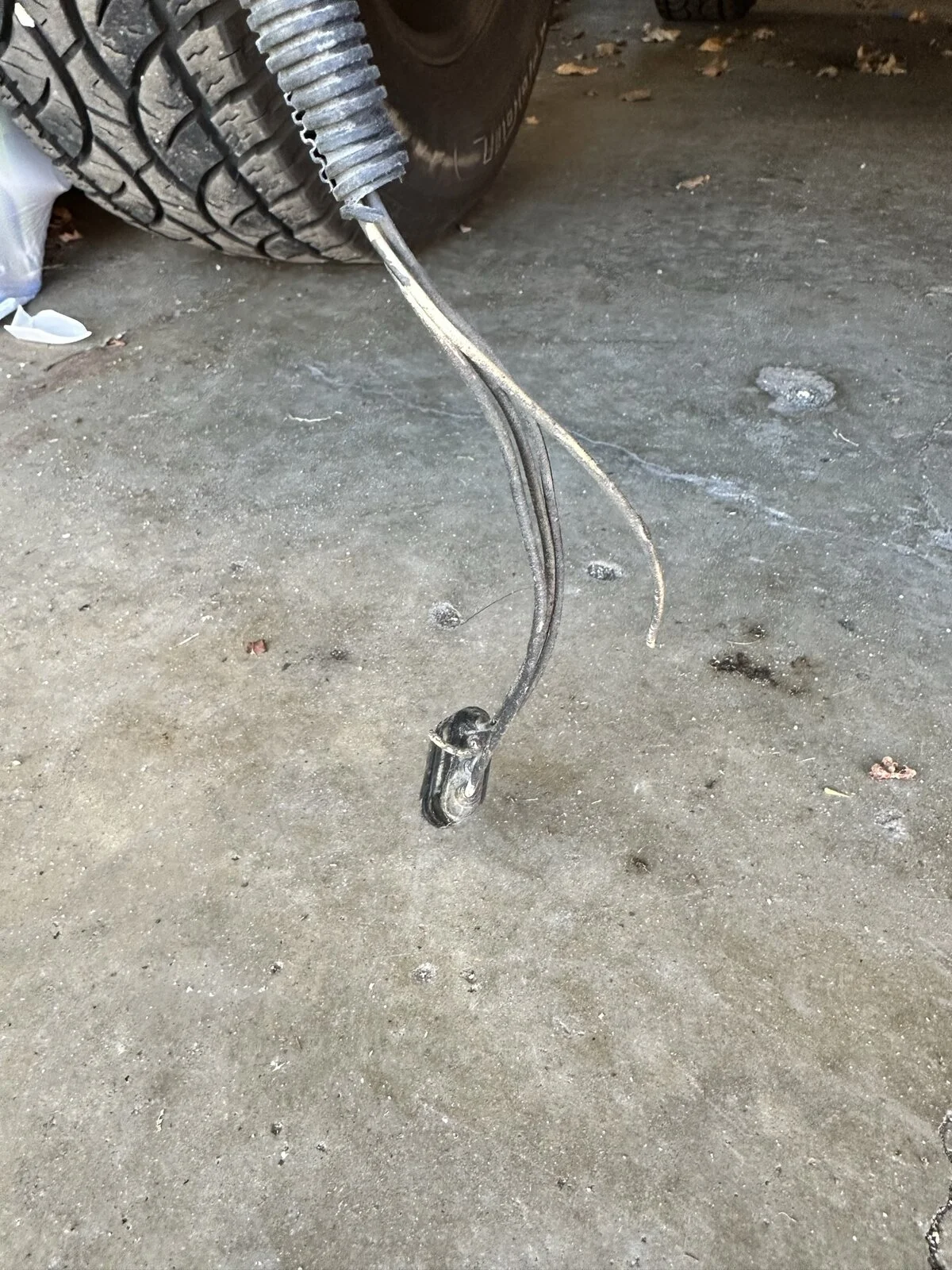

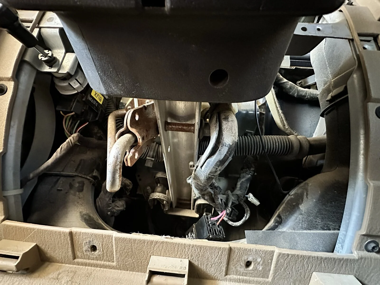

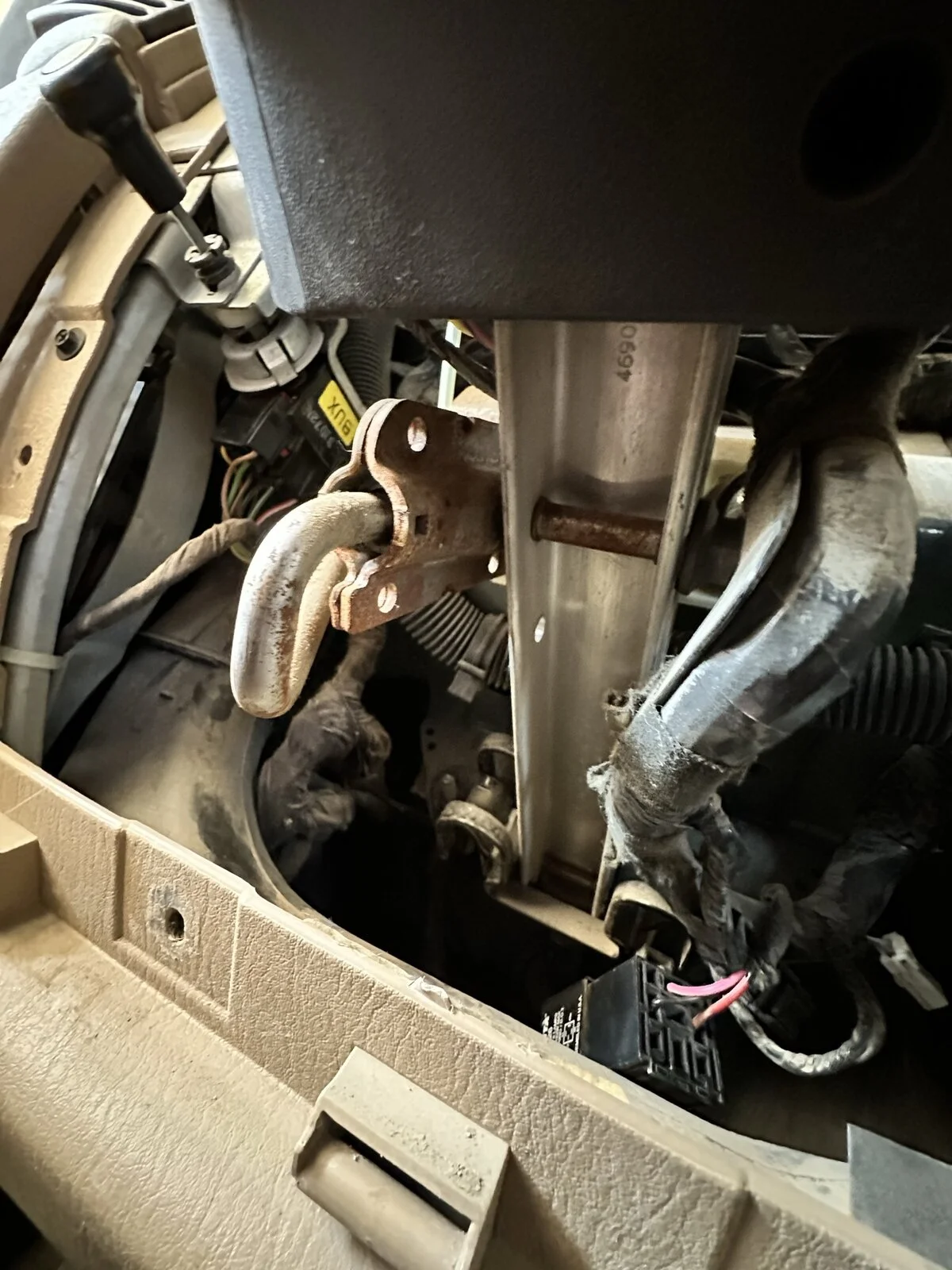

I pulled apart the dash and don't see any obvious disconnected grounds. Are there any other usual suspects? I did notice one thing which is that the trailer hitch has a broken wire. Could that be the cause of the issue?
Took the Jeep in to a shop for some other things and had them look at this, too. Turns out the culprit is that there's a wiring box for the trailer hitch that got some water in it. I'm going to have to go in and replace it and rewire the box. I just figure I would close out the thread with a solution just in case someone else has a similar problem in the future.
