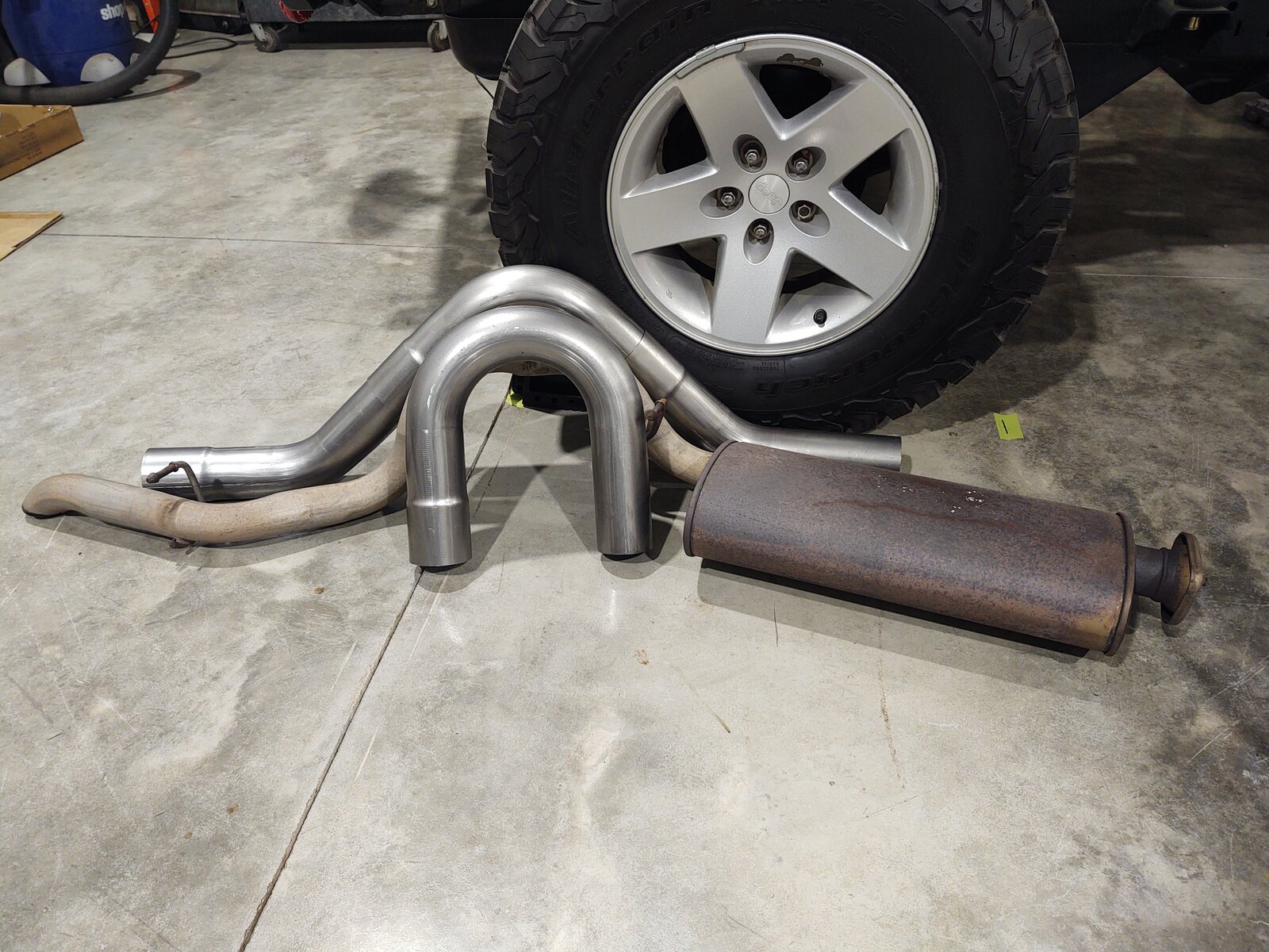

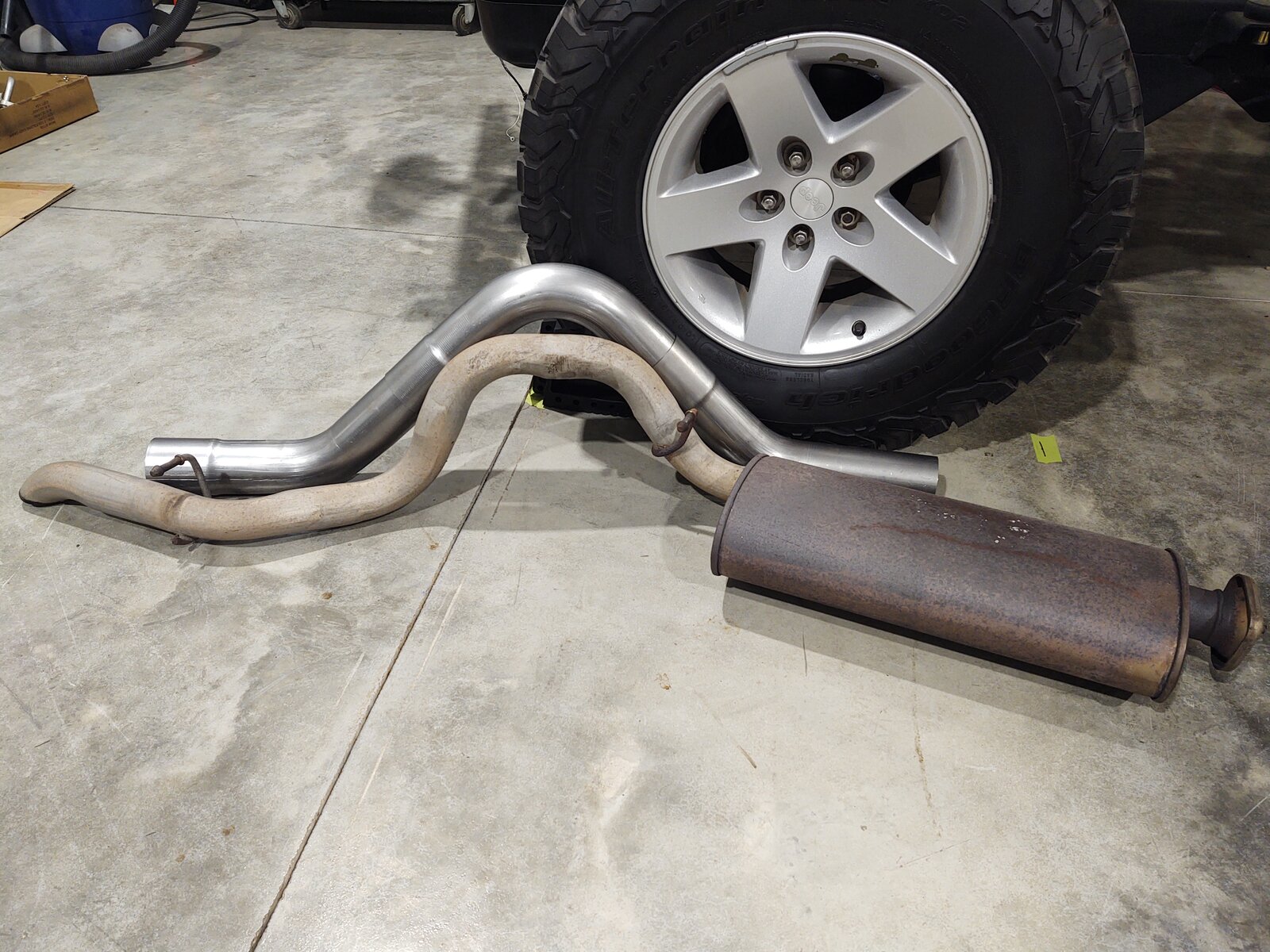

The 3" exhaust pipe bends should be here by the weekend, so I'm going to try and finish the exhaust this weekend. Also got 3/8" FI rubber fuel hose to run from the tank to the engines to replace the 5/16" that is there now. Seems it's highly recommend to upsize that to prevent fuel starvation at WOT.
Nice. 3
Nice. 3“ is definitely the way to go.
Yeah, that's what I was thinking since running dual tailpipes out one side would be very tight. I kind of mocked up duals with the other pipe and I think it might be above my pay grade to get them to fit properly. Not saying it can't be done, just not by me this time around.
