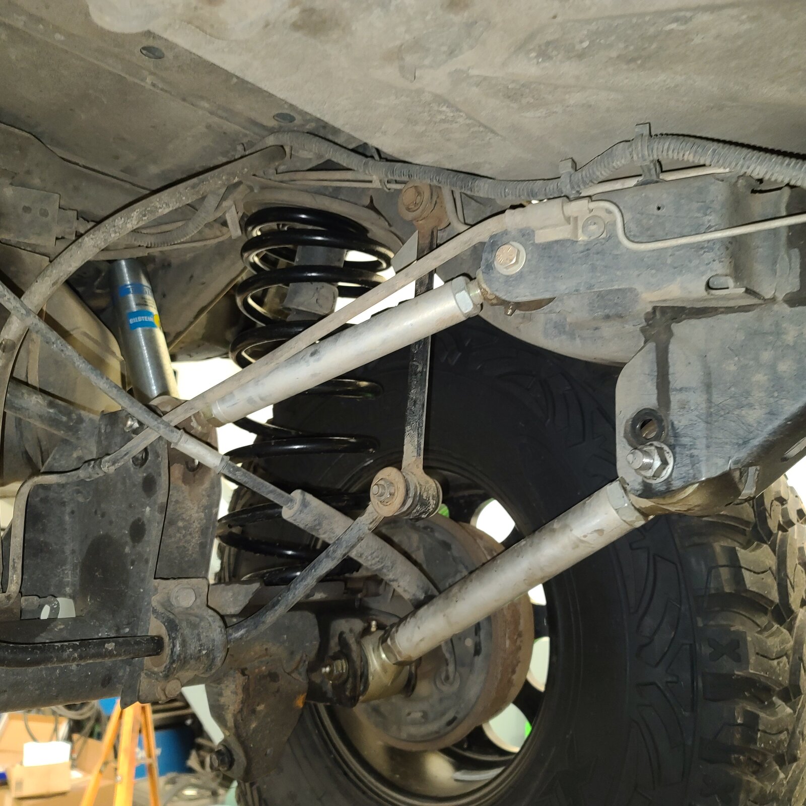

This is a currie inspired set of arms I built in 2017 but I have never had time to follow through on putting them under a rig to experiment with the upper brackets.
Reactions: Ephry73
BuildBreakRepeat
Innovator
Jan 21, 2019
3,355
Corvallis, Oregon
No, they weren't flawed, I think they were improperly used/installed due to the geometry change they created on the axle end, the upper arms also needed to be relocated.
You don’t think the loss in ground clearance was an issue? Just what I’ve heard in the past, never got my hand on a set. Makes sense that proper mounts could fix it.
They sold a short arm upper triangulated kit with the J-arms if my memory serves. I know several people who had them, but dont remember any geometry characteristics.
I never saw the triangulation kit if it existed. I do know for a fact that if a guy used the j arm with a full traction or rk short arm trilink, the result would be about the same as the geometry correction im doing because the lower axle mount relocated to the center of the axle tube 2" higher, and made the arm about 6" longer than in stock mounts.
There no loss. The arm doesn't hang below the factory frame mount and its raised on the axle end. Still more clearance than a long or even a mid arm at that point besides a bracket below the frame to run into.

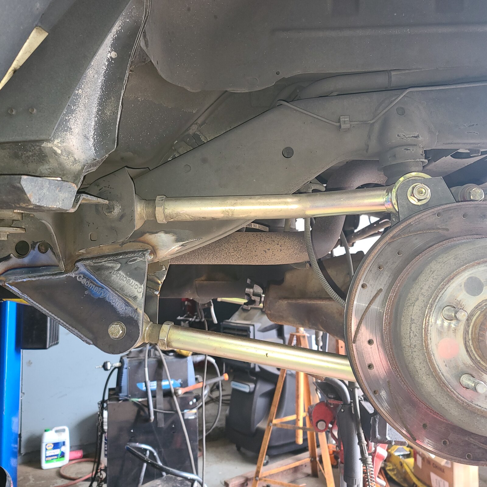

The kit comes with lower frame mounts and upper axle mounts?
Nothing for the lower as you just have to redrill the existing mounts. At the minimum you need new upper axle side brackets and Dave is also making upgraded upper frame side mounts.
Blackjack
Dec 16, 2018
1,160
Kenai
Dave the triangulation kit included a new 9inch with the brackets welded on and the upper arms were canted to still fit the factory frame sided brackets that were reinforced.
Blackjack
Dec 16, 2018
1,160
Kenai
DOH, I was in a hurry and mixed it up with this one.
Ok so that is indeed a TJ. The lowers are redrilled:
1 inch down on the frame side
1 5/8 up on th axle side
The axle side uppers are relocated up. Now David will have to tell you how much his brackets move the upper but on the Nth Degree brackets I run it is either 2.5 or 3.5 inches.
So if you look at it this way what is being done is taking the control arms at four inches of lift and returning them to operating angles about where they would be with a budget boost. This moves the instant center forward, reduces roll steer, and by flattening the links some you can in most instances move the axle back in the wheel well a touch.
