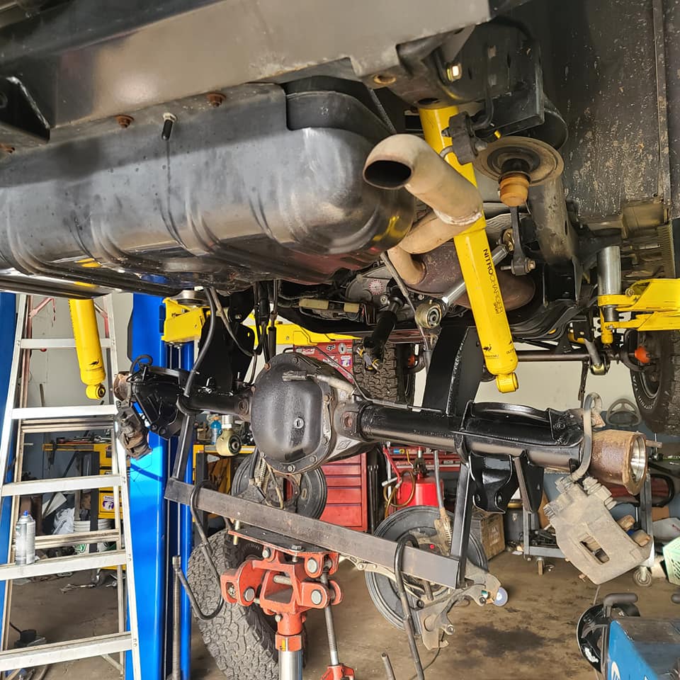

I had @David Kishpaugh install his GC to my TJ this week. I have 2 inch OME springs and notrochargers (soon to be replaced). I drove it home last night, and it handled well and rode nicely. I go back to Turkey next week so it will be a while before I take it off road.
I am on a tight schedule while I am in Oregon this holiday season, and Dave really came through and finished his work quickly.

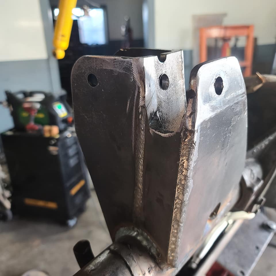

Stock is the best fit and sets the axle center within a 1/4". Rough country forged followed by jks and currie. I build a special bracket for the currie HD track bar with a 2" mount width as well upon request.
Other track bars such as rubicon express don't even adjust short enough to center the axle w/4" springs.

The only time I use the lower track bar position is if I'm working with a rig that doesn't have a body lift or 3" bumpstop extension/14.5"+ collapsed rear shock length. That won't set up on a 2" bumpstop.
The upper hole was added 3 years ago to alleviate a bind problem I had while setting up 14" travel shocks to a 2" bumpstop with 22.5" rear control arms. Since then I will rarely even drill the lower hole.

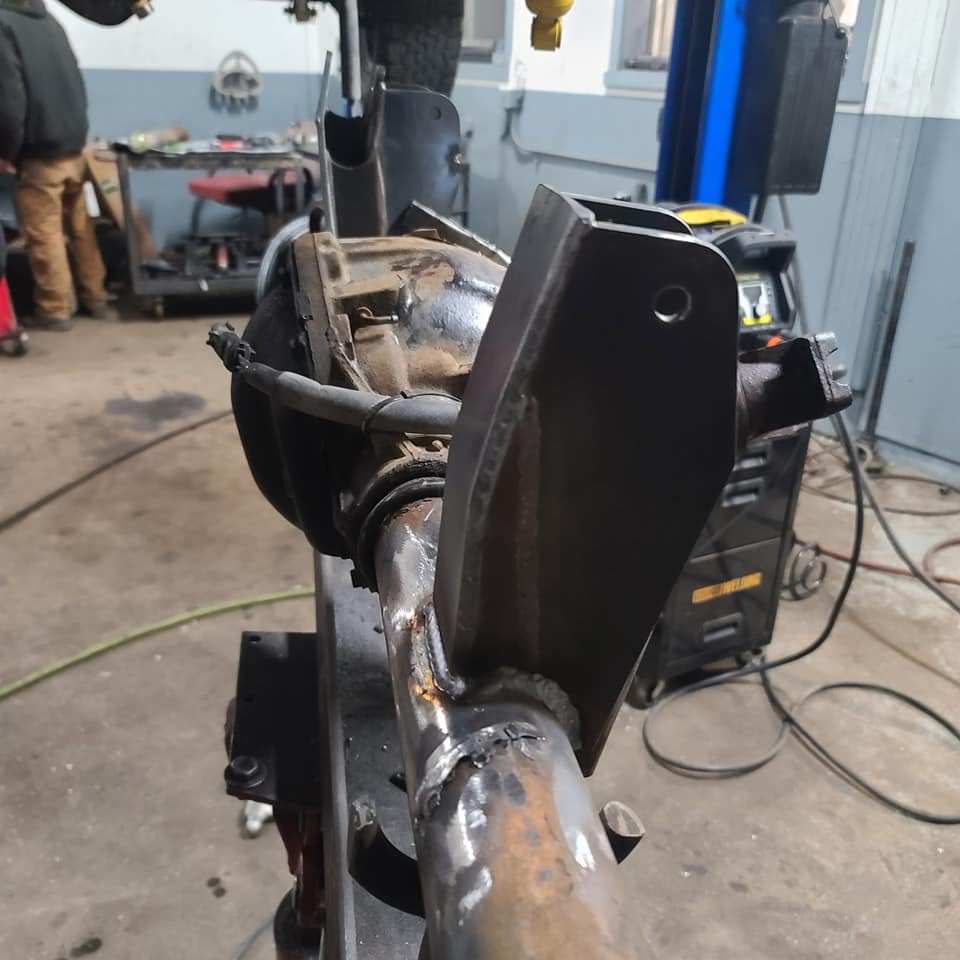

The theory is the same as any kit that changes the control arms locations. Its all about the control arms angles and how they transmit the axles torque to the chassis. On the short arm correction by drilling the lower arm mounts and moving the upper on the axle you are putting the arms in a position that is closer to the what the Jeep had before you lifted it. The track bar bracket that Dave uses as well as the one I have moves the track bar higher than a lot of the other brackets out there raising the roll center. Between the two this helps reduce roll steer and instead of trying to lift the chassis during acceleration (the infamous left front tire pick) it just pushes forward.
