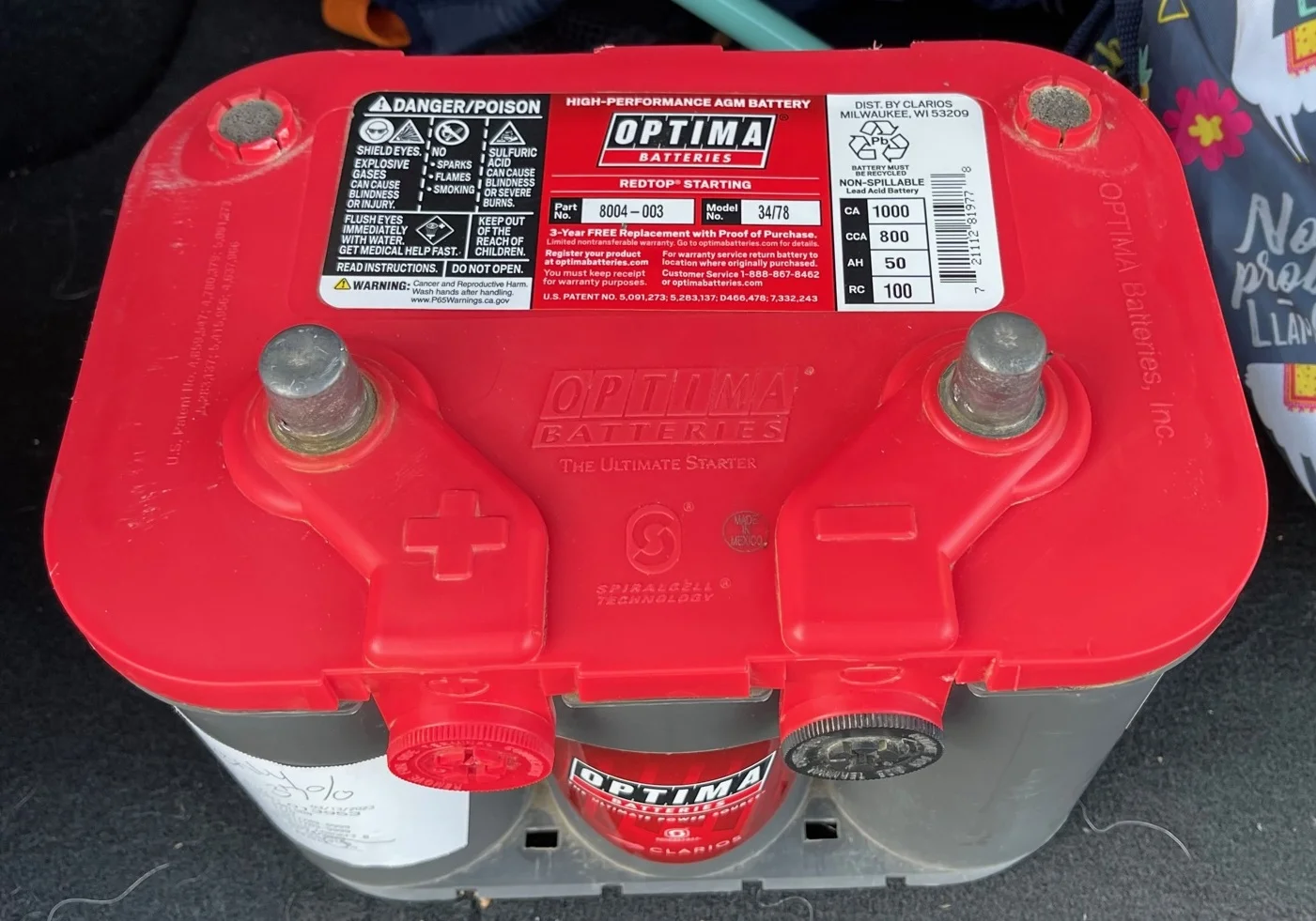

So my Jeep came with this nice Optima Battery when I got it. I expected it to last longer than the cheap batteries from Costco, but I guess I was wrong.
Optima Warranty is only 3 years and this one is just under 4.
I have never left electrical stuff on inside the Jeep to kill it, and I have charged it before multiple trips to make sure it was topped off.
I would swap to something else, except the PO installed a Nemesis Battery Tray that is 'Specific' for this style Optima Battery.
So I either buy another $300 battery or I have to ditch the top of the battery box and find a new way to hold a different battery brand.
Any other suggestions?

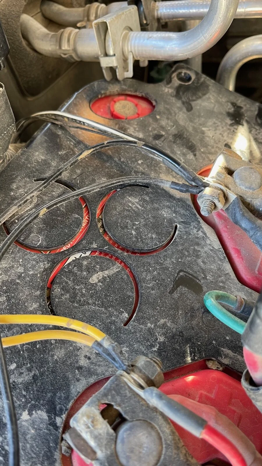

Its hard to see in that photo, but with the fender mods, the battery is pushed up against the firewall and literally under the (AC?) lines.
Its a TIGHT fit.
