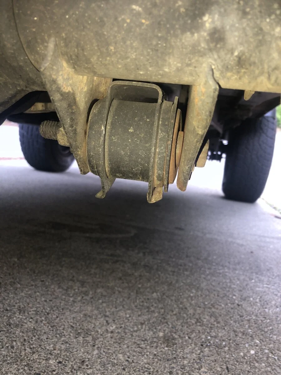

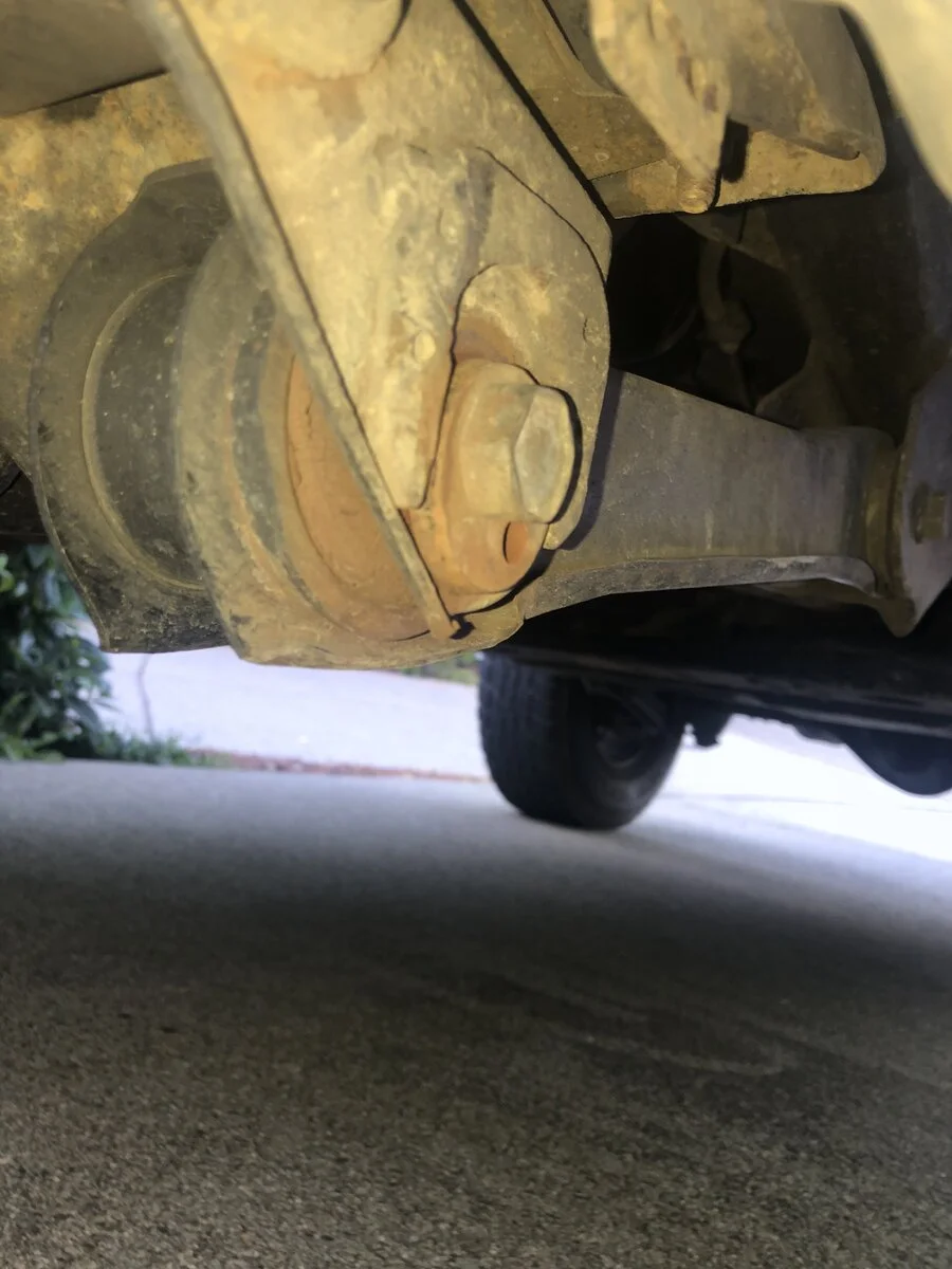

I took my Jeep to get my tires balanced and they said they could not do it because I run spacers on my Jeep?! They also said I am getting this wobble because my bushings in my control arms are shot. Would my control arms cause this wobble?

First off I would make sure you have a stock steering setup. Stock pitman. Steering joints all tight. Trackbar bushings good. Try rotating the tires front to back. If it is a tire problem that should help. If it's still the same then it's more than just tires.
If you can post some pics of the front steering you have there are guys here with eagle vision that can notice the smallest problem.
It's possible bad bushings could make it easier for DW to develop. But bad bushings never actually cause DW, they just let it develop more easily when it is triggered by something else... like imperfectly balanced tires.
The spacer thing is when, to use a famous Blaine term, the shop's lawyer fucktards are too liability conscious to allow them to touch spacers. Find a shop that doesn't care or get rid of the wheels that cause you to need spacers. I had a local Discount Tire store refuse to work on my tires because I had a 1/8" wheel spacer up front, it wasn't even one of those big huge 1" spacers some like to install. Then they got a new manager and he had no problem with that my 1/8" spacer. Fortunately I was able to stop using that spacer.
I'd sure focus on tire balance. Every single time my TJ developed DW over the past 24 years it was from a bad tire balance.
