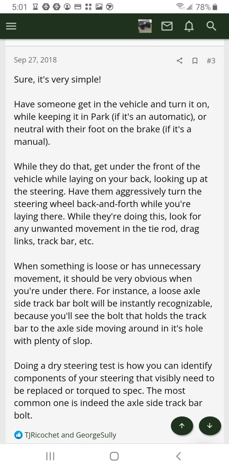

Welcome to the forum! Dry steering test can help you identify the issue. Also be sure everything is torque to spec, like track bar and steering linkage. A steering dampner is not a fix for death wobble, as some youtubers might tell you. I'm sure others will chime in as well with some advice. Screenshot is instructions on a dry steer test. Nice Sahara btw!!

Do the dry steering test!!!!!! It will show you what is moving that isn't supposed to be moving!!!!!!

yeah I did that yesterday and everything looks bolted up correctly so I’m thinking it has to do with running a stock stabilizer on a 2.5in lift
