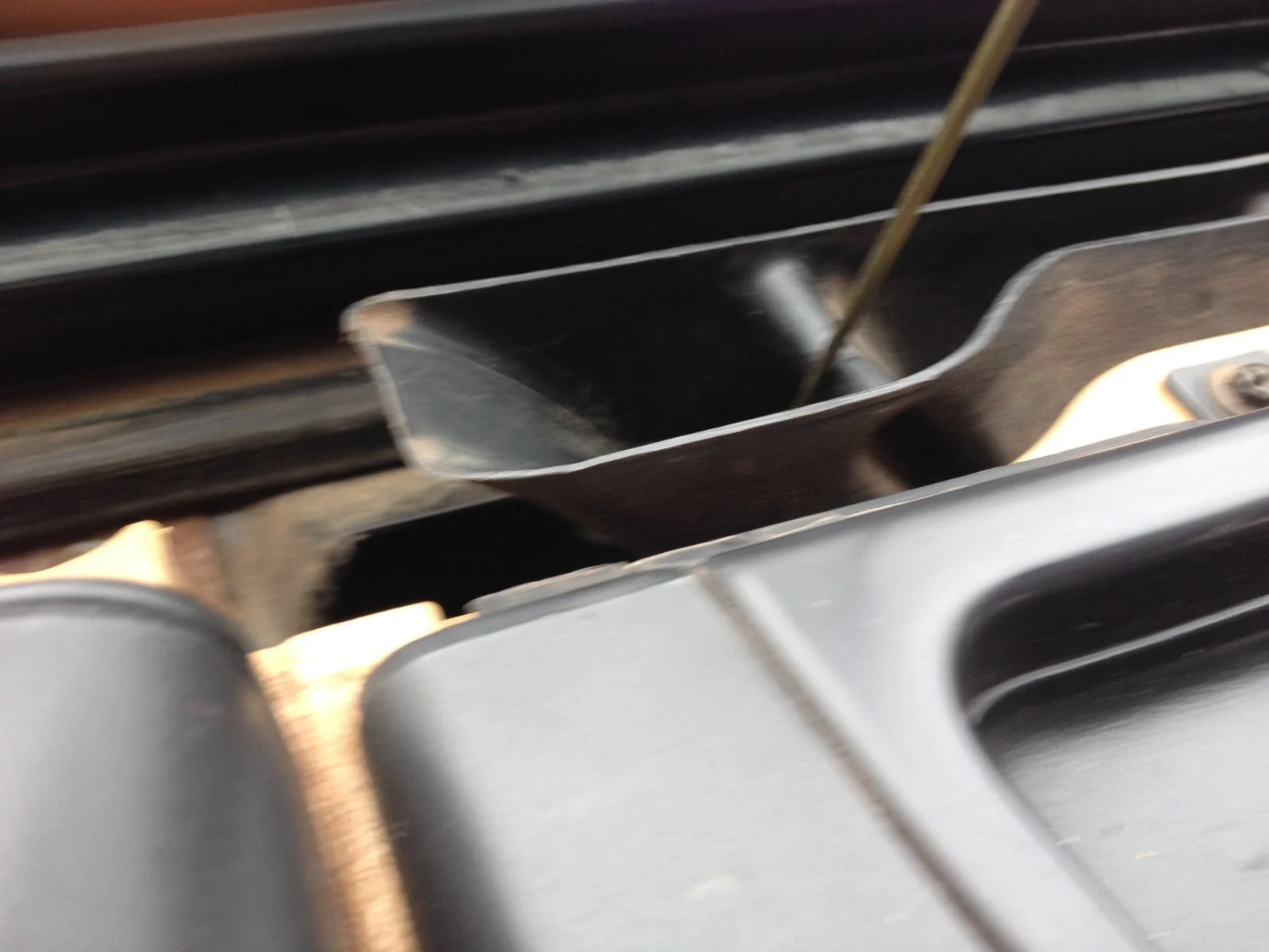

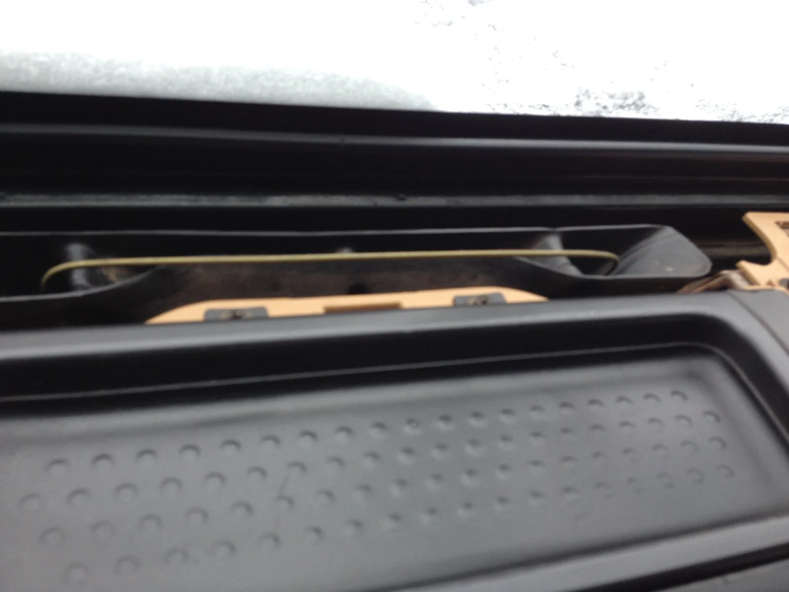

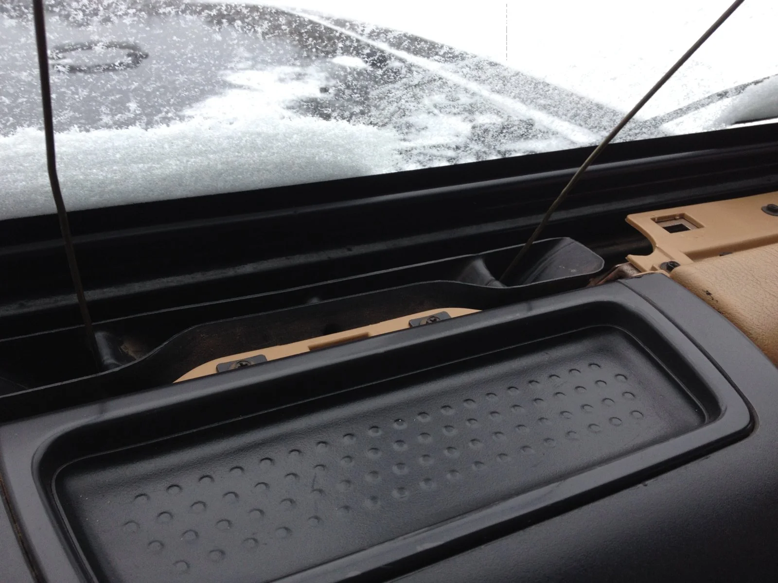

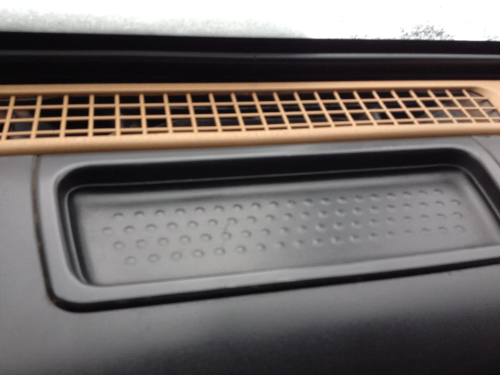

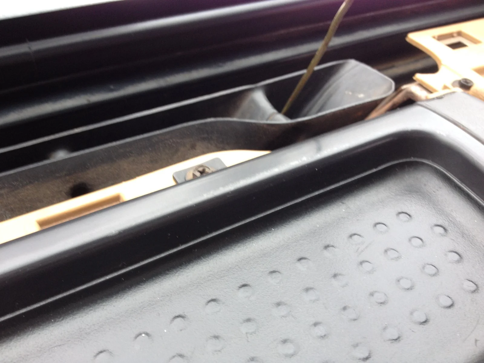

I didn't know my defroster was broken until I replaced my radio and found a coat hanger in my defroster vents.
I pulled it out, and put the top back on the dash, only then I found the hanger was there to hold the defroster door open.
I bent a new hanger and now have defrosters again.
Reactions: Elbo and Reign Mack
I read this a couple of years ago and thought well yea , he has the defroster but nothing else. Out of frustration with no defroster I just put the " Coat hanger trick " to use and wow . everything works ! Thank you UPJOHN !
