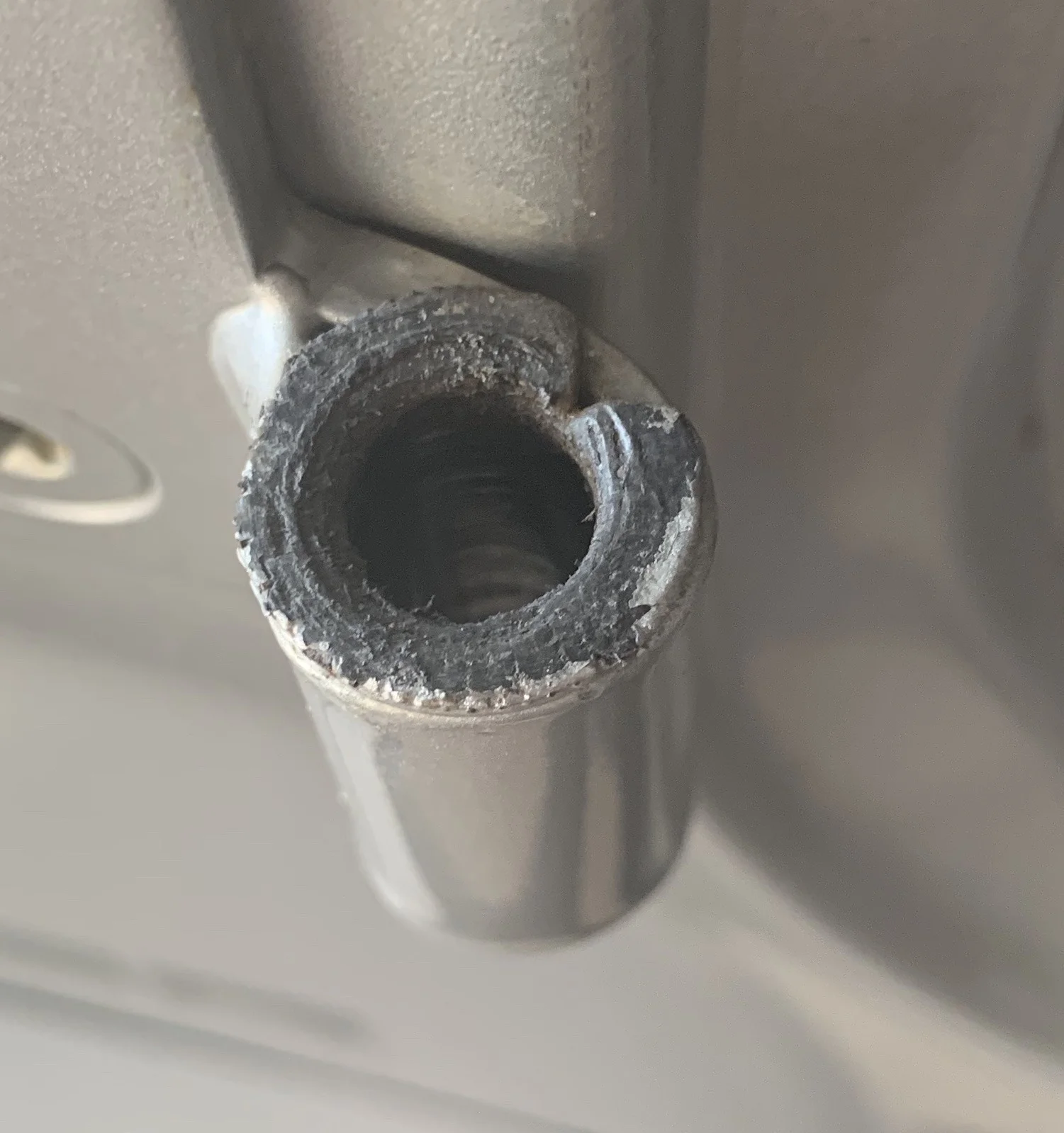

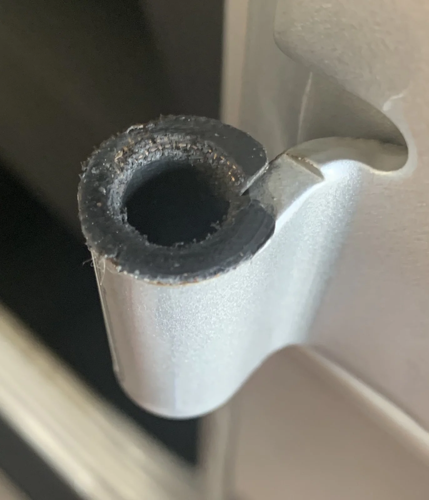

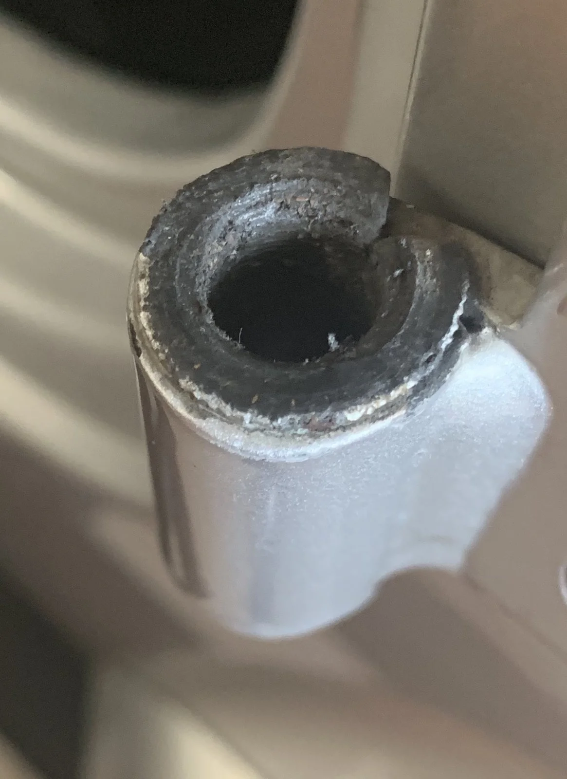

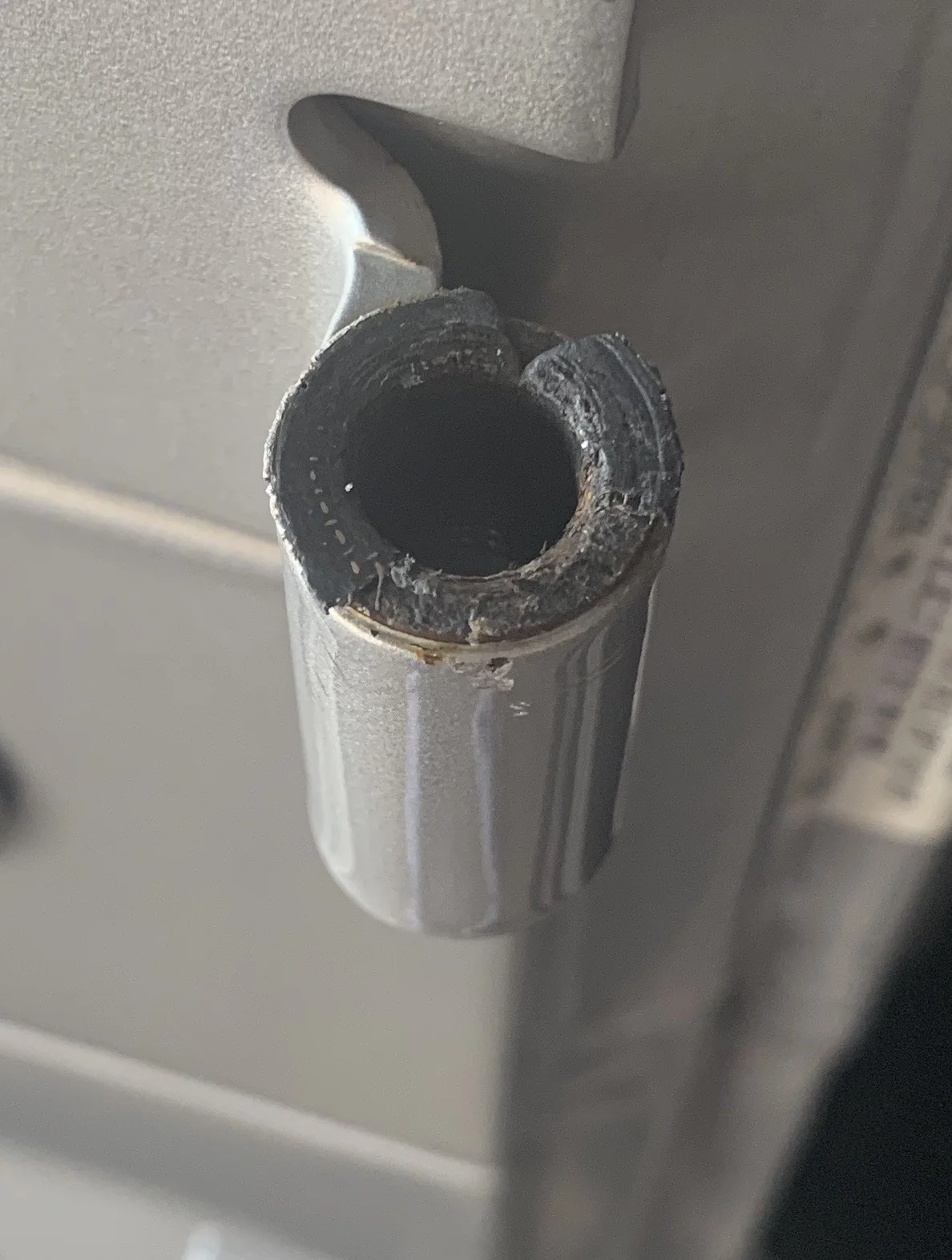

The doors on my 2005 Tj come right off and operate smoothly but I'm wondering if I should replace with the Quadratec delrin bushings as more of a preventative means. if I replace now the old ones might come out easier than if I wait a few years when they may "need" to be replace. Who has installed the Quadratec bushings? Would you do it again?

my current bushings:
82226
82227
82228
82229
