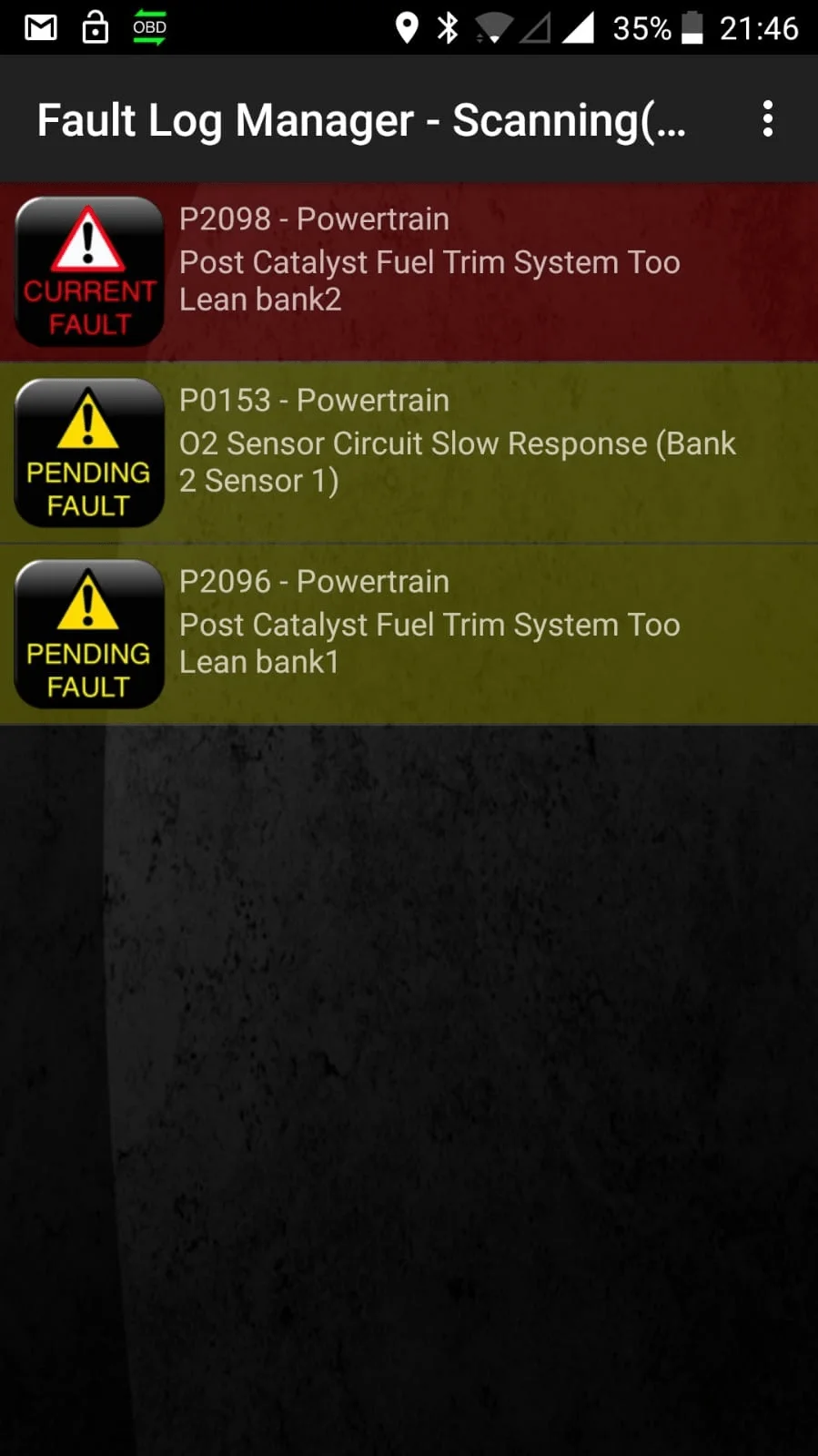

Hi there,
I have the same problem as you and am still in the process in sorting it out. But thought I would let you know that I took my 05 Wrangler to a dealer for a ECU update and when they plugged it in there was no update available. I'm going to try and replace all my 02 sensors and see if that helps (previously just replaced the one with the specific error code). Fingers crossed.
The sensors arrived pretty quickly from RockAuto so I will replace them this weekend.
Also arrived is a OBDII scanner which works really well!
http://rover.ebay.com/rover/1/711-5...0001&campid=5337789113&icep_item=251488093341
It shows the following codes:
86260
It also allows me to see live voltage data from the sensors, but i'm not actually sure what I should look for
When I was at Jeep they printed out the diagnostic step by step for me to pass onto a mechanic. Unfortunately I don't have scan tool to test it but you might have more luck with your OBDII scanner. It lists the voltages of the O2 sensors in there. Hope it helps!

Well, replacing all 4 sensors does not seem to help so far.
It still throws p2098 and p2096 whenever I go on a long drive of 1+ hours or so...
Guys...be dead sure 4 the bolts are snug at the cats..dead sure..,or it sucks in cold air and confuses the computer that’s reading upstream and downstream .
