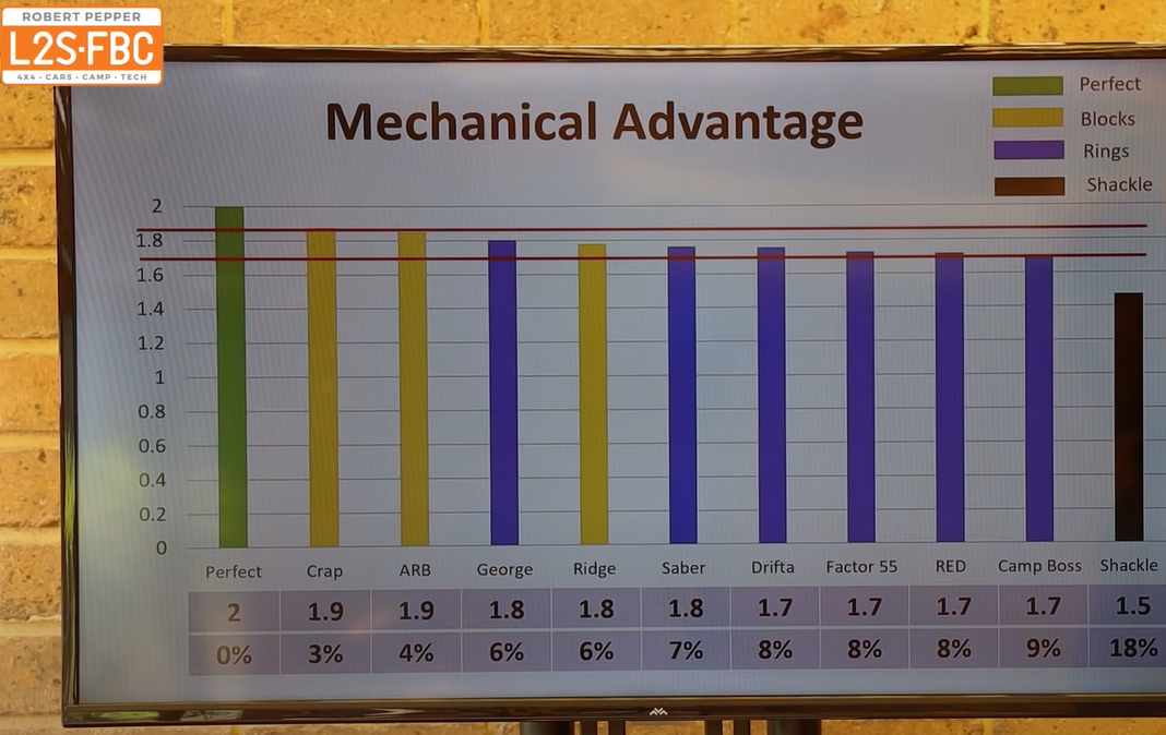

There is a video on Youtube that shows an increase in friction over a standard block, reducing affective pulling power...
Other than that, I haven't used one myself so can't say.

Yes they're not as friction-free as a snatch block is but they still work "well enough" where larger diameter like 3/8" synthetic ropes are concerned. I'd rather have one of those than not if I didn't already have a snatch block.

My snatch blocks are heavy as crap so having a lightweight aluminum ring is somewhat attractive, even if if reduces the mechanical advantage from 2 to 1.8. I just ordered 4 Wizard soft shackles to dump some weight from my recovery bag.
