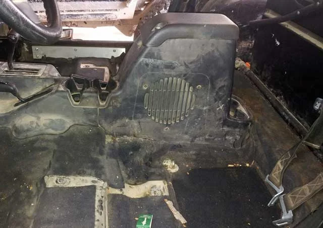

Look at the sides of the console. If it came with a subwoofer it'll have slots cut into it. If it didn't come with a subwoofer, the sides will be solid.
This is my previous OEM console that came with a subwoofer.
My console has the slots cut into it, but it has the white plastic insert instead of the subwoofer insert. And the build sheet shows it did not come with the upgraded sound system option. 🤔
