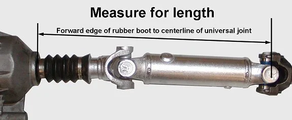

Also, unless you are just getting Tom Wood to estimate driveshaft length, you are going to have to install the SYE before you order the driveshaft in order to take the required measurements.

I was under the impression that Tom just needed one measurement and he would send both SYE kit and driveshaft?
This is from their website
“For the SYE Kit and Drive Shaft package, we just need the length measurement.”

Hmm, I didn't know about Tom Wood doing that. Makes sense I guess. But you have to make sure you aren't moving your transfer case at all. If you get rid of a transfer case drop after installing an SYE, that would change things. I would tend to just get everything figured out and send them the length at the end.

Taking your advice getting everything figured out first then send drive shaft length at the end. Ordering JB conversion sssye kit. Thank you once again.
