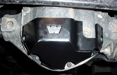

I'd probably start with Warn's differential guard. It is strong, works extremely well, and absolutely will not interfere with your steering system. I don't run it now but I have at both ends of my couple of TJs and it works well to protect your differential.
This one. Heck I just remembered I'm still running one on the rear of my present TJ. I tossed a big heavy cast-steel cover that wouldn't seal well and replaced it with a stock cover plus this.

The half guards like what Jerry pictured works fine, costs a lot less, and does not create any interference issues. I have Rugged Ridge's version on my front Dana 30. Think I paid $60 for it.

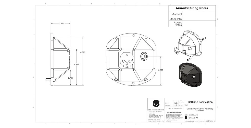

If you are looking for actual hard data. Good luck. Ballistic fab is he only company I know that goes above and beyond to provide actual hard data like actual measurements. I'll get you the measurment info tomorrow for their Dana 30 cover. And they will add it to their website.

If you are looking for actual hard data. Good luck. Ballistic fab is the only company I know that goes above and beyond to provide actual hard data like actual measurements. I'll get you the measurment info tomorrow for their Dana 30 cover. And they will add it to their website.
I am a man of my word. Measurable data. And I had them add it to their website. I got to brag a little.
https://www.ballisticfabrication.com/products/dana-30-diff-cover-welded
If not the OP, I hope this helps someone with a Dana 30 looking for actual info. Not saying it is the slimmest, as I do not know what the factory cover measures. But atleast we have a measurment to start with.

Anyone happen to know the stock Dana 30's measurements to compare to the ballistic fab one? Or if those measurements would clear stock suspension? I can't believe they are the only company that has a blueprint for their product. Very cool, fouledplugs!
