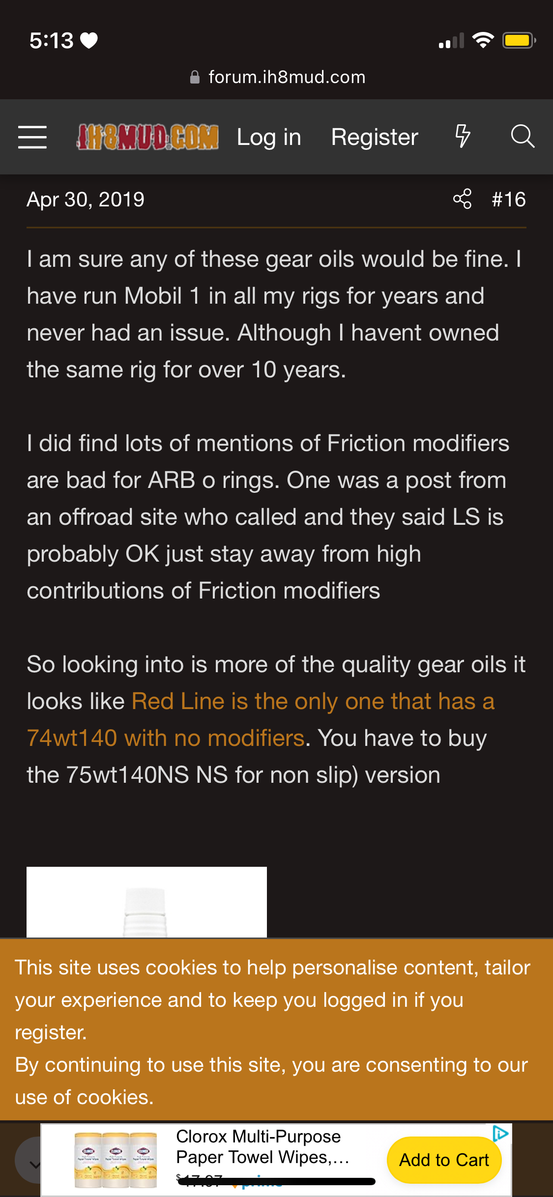

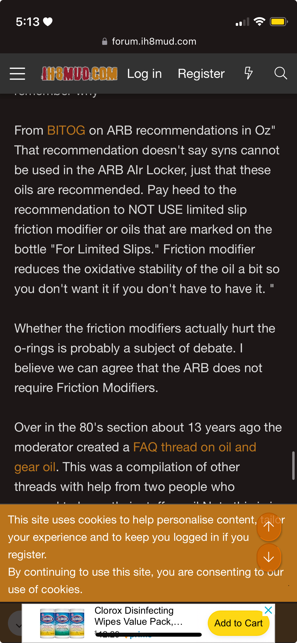

I just bought some gear oil for my differentials it’s 75-140 with limited slip additives in it. I don’t have a limited slip I just have stock rubicon axles with air lockers. Is it a okay to put it in the diffs,, is it going to do damage to the air lockers or the differentials? Should I return what I got and get something without the additive in it?
The gear driven Rubicon LSD won't know or care that the gear oil has a friction modifier in it.
I've never seen anyone claim that.

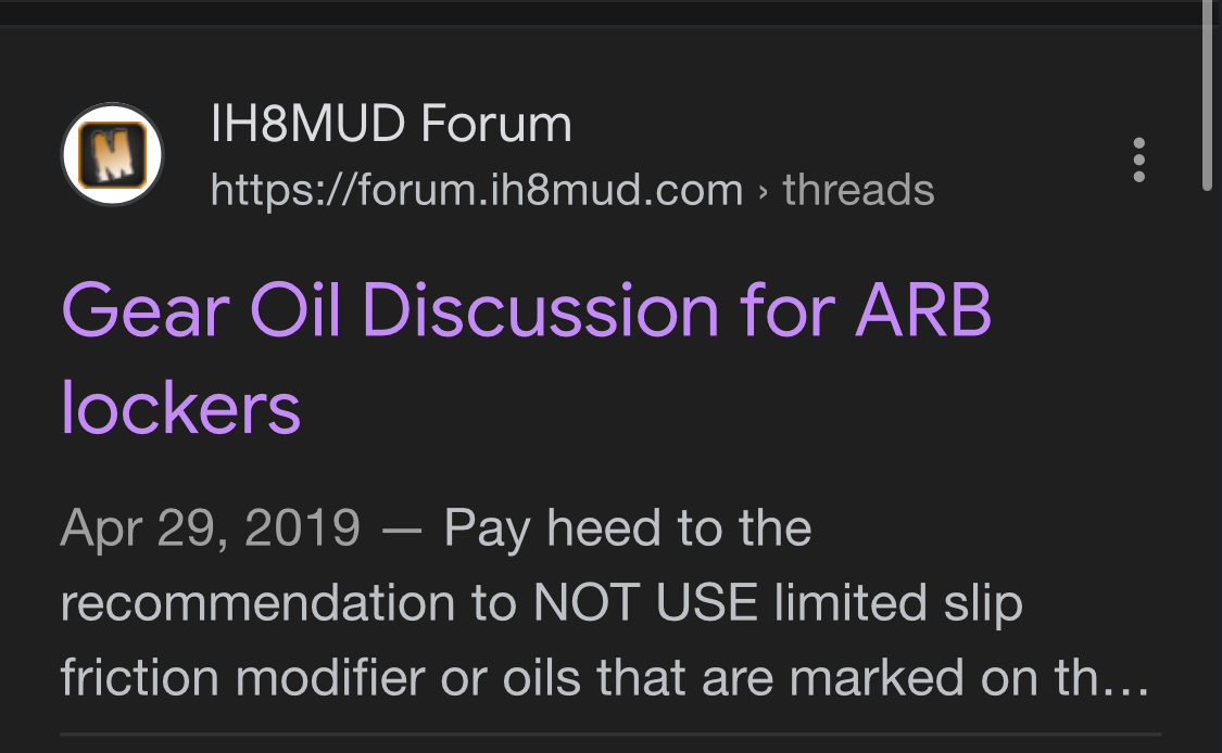

This is what I’m referring to, I know jeeps don’t have arb air lockers but the seals are probably the same.
There seems to be so many opinions on this I’m just not sure where to go lol
That is the first I have ever seen that. Most gear oils these days have friction modifiers. My Rubicon lockers had those oils for at least 150k miles without any issues with seals.
If this were an actual problem, there would be actual widespread reports of it.
Awesome thank you I was just looking for some people that had experience with using the additive. Thank you!
