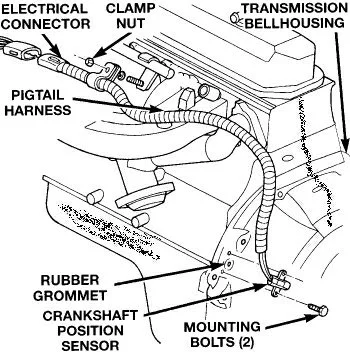

You could replace the cheap things like start plugs, distributor cap and rotor just for maintenance and to rule them out. However, there's a chance it could be something like the CPS (Crank Position Sensor) or another sensor going bad.
The Crankshaft Position Sensor (CPS) located on the transmission bell housing. Often this part is also referred to as the Crankshaft Position Sensor (CKP) CPS/CKP failure is very common. The CPS/CKP can stop working with no warning or symptoms and the engine will not run or the engine may randomly stall for no apparent reason.

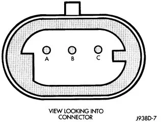

CPS Testing
Crankshaft Position Sensor Connector (CPS/CKP)
TESTING PROCEDURE 1991 – 2001 4.0L H.O. engines
1. Near the rear of intake manifold, disconnect sensor pigtail harness connector from main wiring harness.
2. Place an ohmmeter across terminals B and C (See Image). Ohmmeter should be set to 1K-to-1OK scale for this test.
3. The meter reading should be open (infinite resistance). Replace sensor if a low resistance is indicated.

The 2000 and 2001 will have the CPS in the same location on the bell housing, but the wire connector is near the Transfer Case, not as shown in the diagram below. Simply follow the wire from the sensor to the connector.
