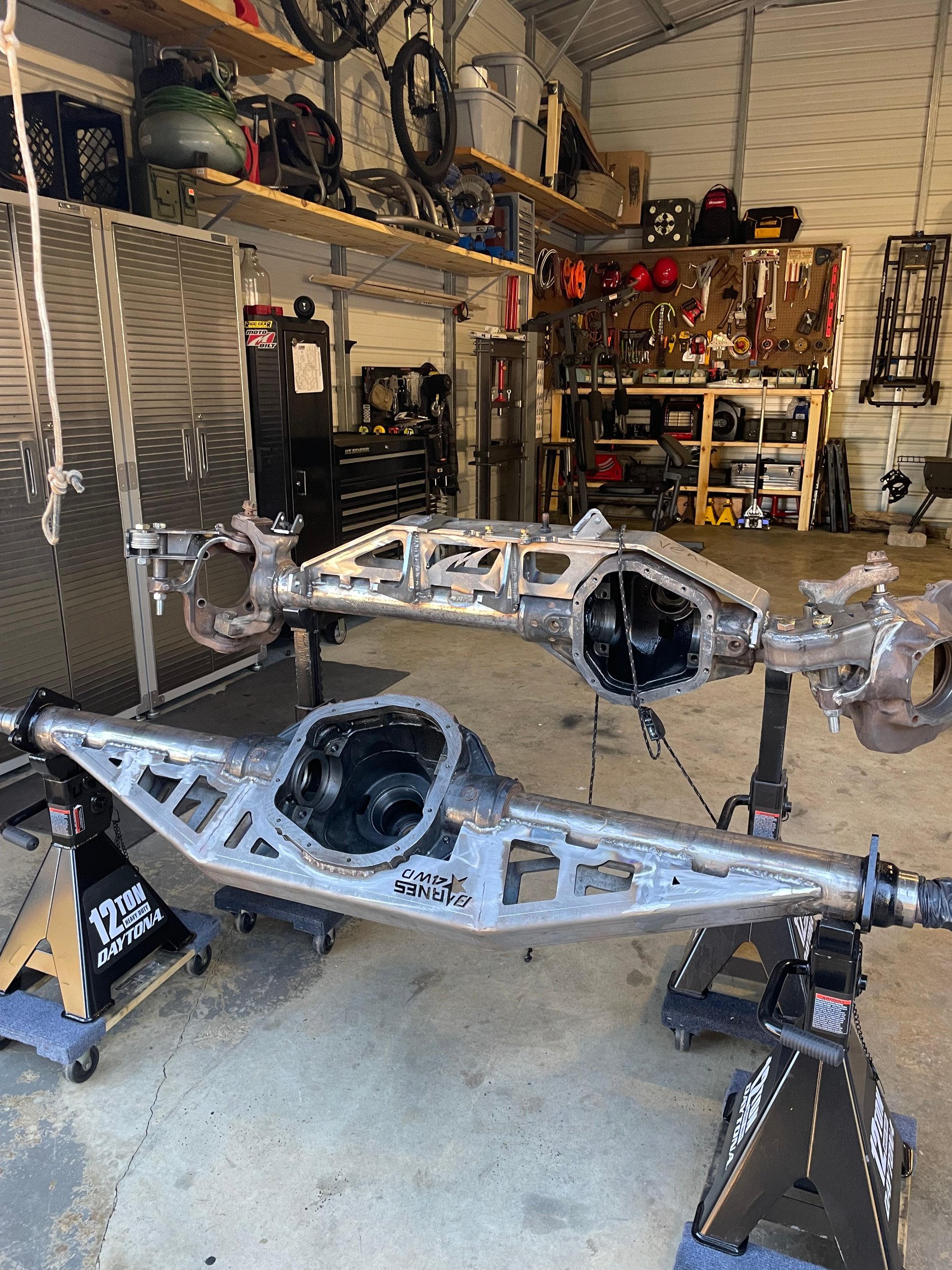

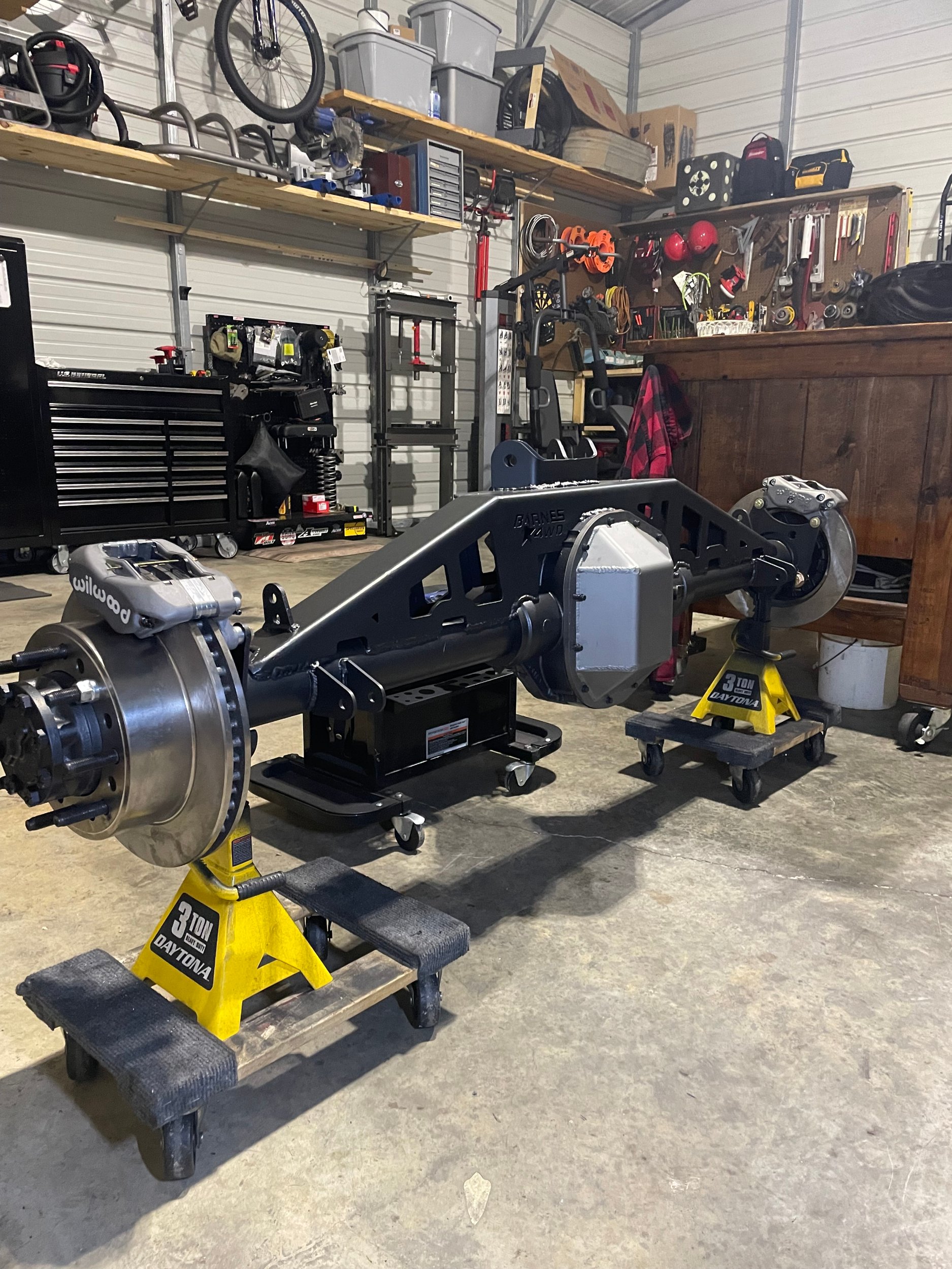

This is my wife's rock crawler, She loves wheeling!! That's a good woman.
She posts her TJ in action on Instagram. @daisycutter_plus3
Build list:
RCV, 35 spline M300
Corbeau Recline Trail Seats
Master Top Bimini
Terraflex Oil Pan skid
Busted Knuckle Front Double Axle Seals
4 link front and rear
12” motobilt stretch, WB 107"
40” M/T Baja Boss x stickies
Dirty life 17" beadlocks/Apex bleeder valves
4.0 with big throttle body, injector rehab large injectors, header, Aluminum Radiator
Dynaflow exhaust
42RFE Auto trans
4:1 transfer case
Advanced adapter Rubicrawler doubler
JE Reel drivelines
Yukon 1350 joints
14” ORI STX Struts
3” radflo bump stops
Rear Currie rockjock anti-sway
08 SD axles
Full PSC hydro steering
4 link front 2” Wideopen design links 7075, Johnny joint 1.25”
4 link rear 2” wideopen design links, Johnny joints 1.25”
Front Dana 60, 5:38 nitro gears, all other internal are Yukon, Grizzly, RCV M300 35spline, billet unit bearing, motobilt truss with PSC mounts, TMS high steer knuckles for hydro, wide open design steer links 7075
Rear Sterling 10.5, 5:38 Nitro gears. grizzly locker, 35 spline, Barnes truss, Yukon bearing/install kits
Busted knuckles willwood light weight brakes
Busted knuckle ball joint delete
Motobilt aluminum full cell
Powerbass 1000 sound bars and 2-8” subs.
Armorlite full tub liner
Midland GMRS radios base unit and 2 handhelds
Main disconnect for engine bay
8 gang auxbeam with breaker and isolator.
2 sets of rock lights
Genright cargo rack
Warn winch 10k
Agency 6 hook
Motobilt bumpers
Optima battery
Motobilt Rear Rotopax mount x2
UTV clamp on side trail mirrors
Custom Roll Cage
OEM Half doors
