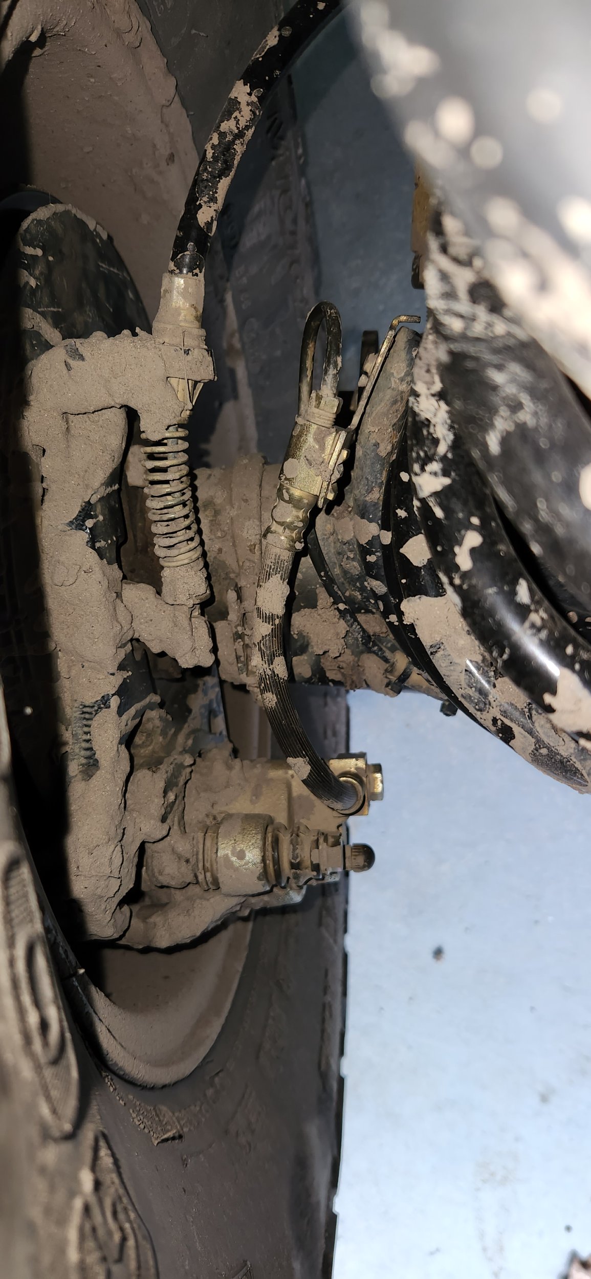

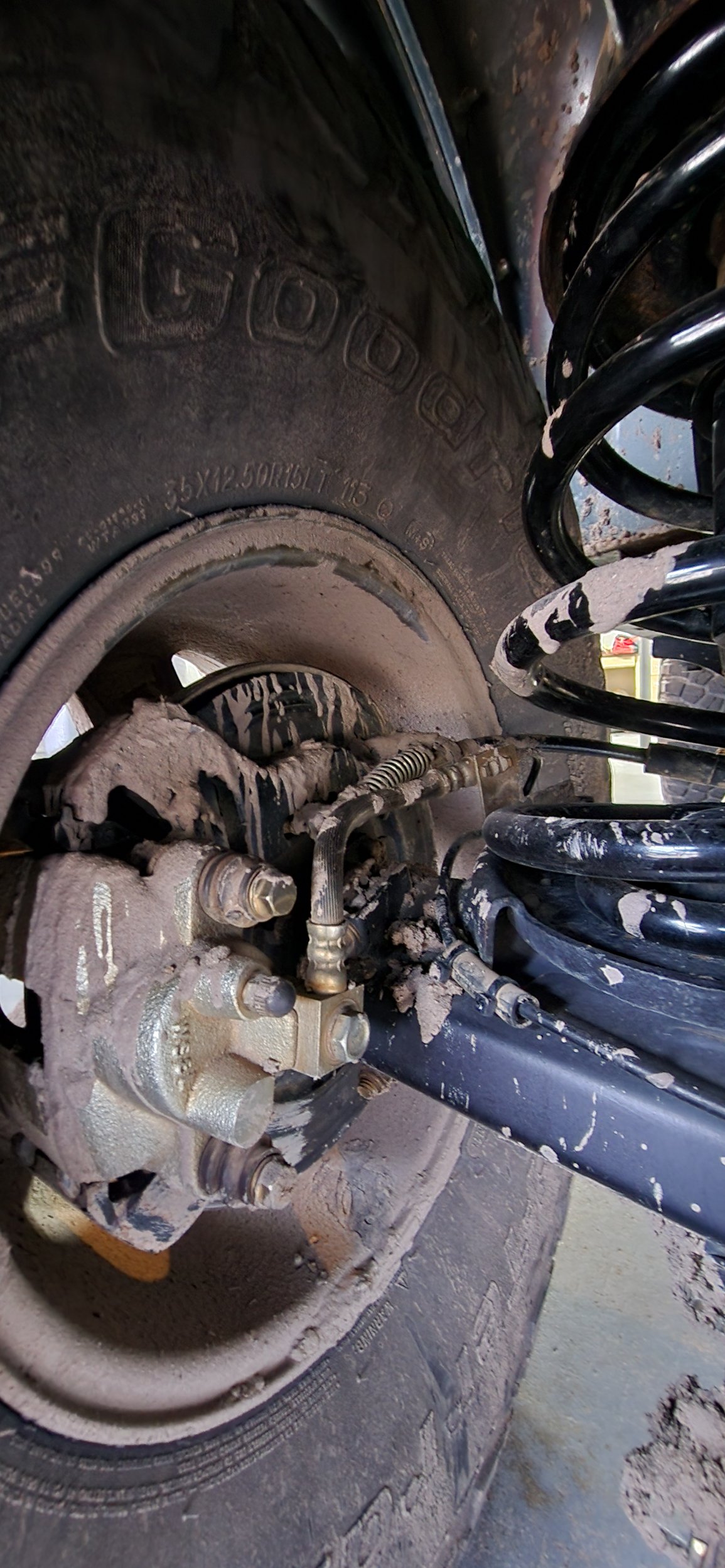

Two months ago I installed the BMB disc brake conversion kit on my 01 TJ 4.0L w/Dana 35
The kit includes everything you need although i purchased 3/8" longer wheel studs to accomodate the thickness between the drums and discs.
The entire installation was about 3.5-4 hours taking our time.

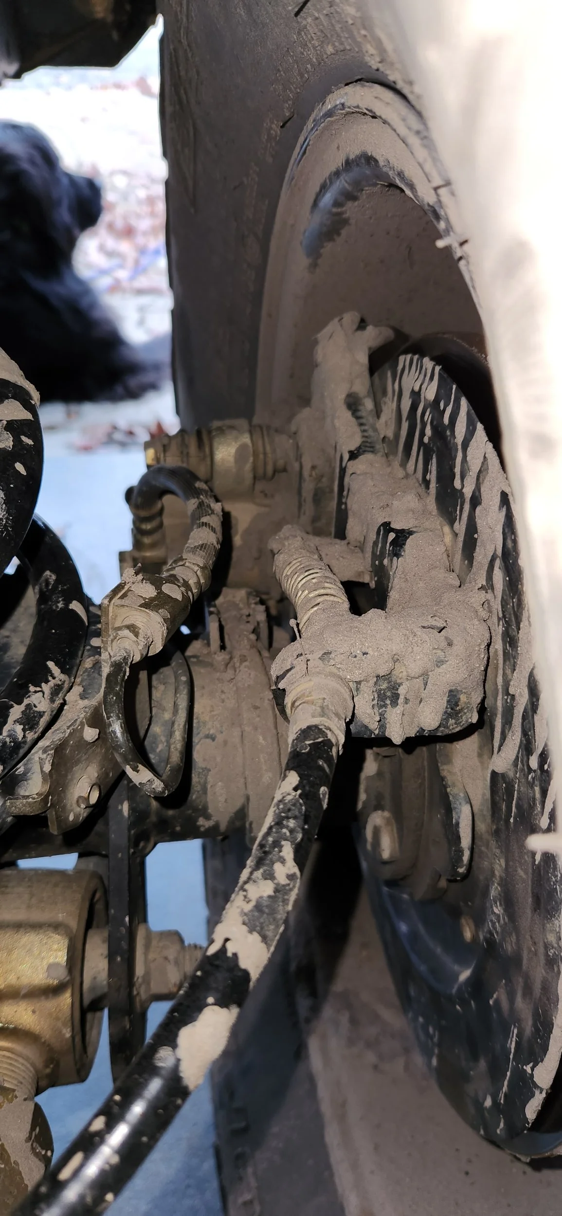

I installed the Crown conversion kit, it's basically all ZJ parts. The kit was complete and installed very easily. I saved a little by buying the kit without E-brake cable and then sourcing them on my own. Very pleased with it so far.
