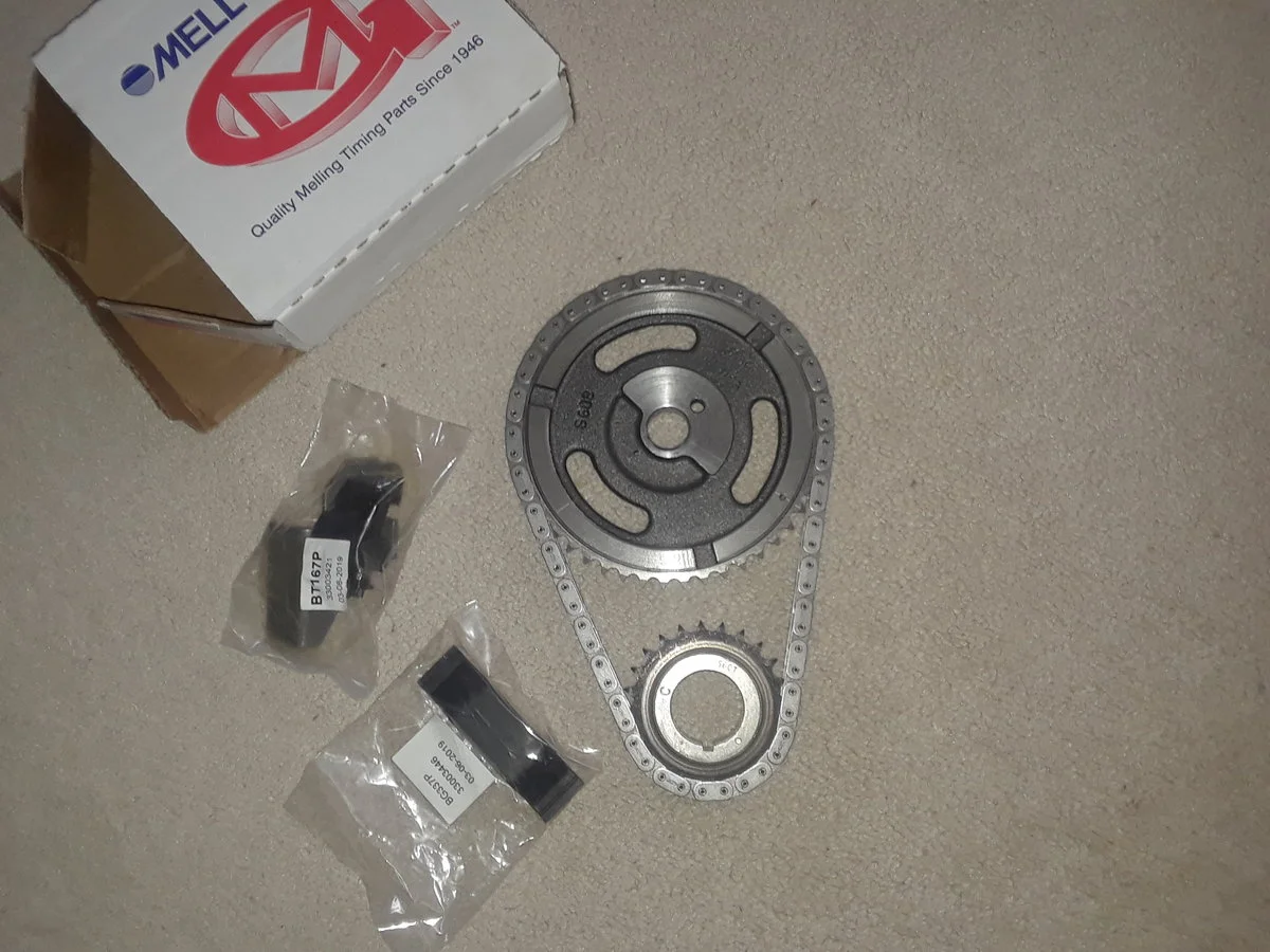

@GASnBRASS I think so, 175k miles and I got a cyl #1 misfire along with a too rich condition last week. Runs terrible when cold, think it's a timing issue
So I'm replacing the timing chain and gears, prob should replace distributor as well
So I'm replacing the timing chain and gears, prob should replace distributor as wellView attachment 124796
That seems like quite a bit of work without having tested anything to prove what's wrong. Run the crank around to TDC, pop off the distributor cap, and see how much crank movement you have before the distributor starts turning the other direction.
Hey thanks, @PatMc I knew there was a way to check for timing chain slack but just didn't know exactly.
I will do that first thing tomorrow in fact. 👍
I don't have a good way to measure the degrees , ill have to figure that out. But going by what I can see, it seems more than 3 degrees.
I'll research that and check the degree of slack. Thanks for your help
There will always be some slack, but shouldn't be much more than a degree or 3 of slack. How many degrees are you seeing?
I figured it out. The timing chain shows consistently 7.5-8 degrees slack. I checked it several times.
So the new gears and chain are going on, ill check the slack tolerance in the FSM
Thanks for the tip @PatMc 👍
