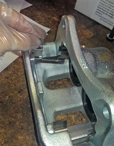

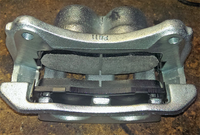

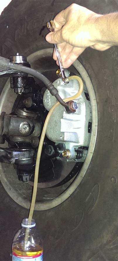

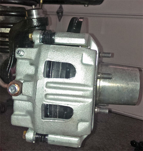

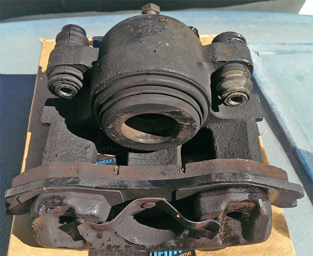

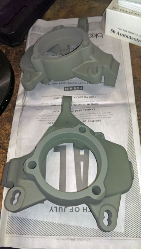

Here are some photos from the Black Magic Big Brake kit plus one very ugly photo of my TJ's original single-piston caliper lol. It's a great kit that is fun to install.
Certainly looks like a high quality kit. Definitely has to be a huge upgrade over stock.

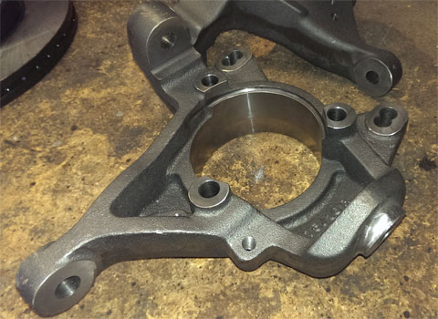

It is mostly bolt on except for the parts that aren't. That is the same knuckle that a company used to "copy" our stuff. Those knuckles have a big problem for lots of folks who actually take their rig wheeling. Due to the fixed upper ball joint and the need to set the distance between the two tapers by tightening the lower tapered nut onto the lower balljoint stud, that enlarged the hole by more than a small amount.
If you ever look at the parts in a set of Spicer Ball joints, you may have noticed the gold threaded adjuster. That gets threaded into the bottom hole of the knuckle and torqued down onto the tapered pin. That makes the hole very large and really weakens that part of the knuckle which is also the part that carries the weight of the rig. If you work it hard offroad, you can easily rip that out and turn a good day into a very bad day. The best we've ever been able to do is just glob enough weld in there to try and stick the pin to the hole enough to get them back to camp and on the trailer.

If anyone is interested, I have a set of the early XJ knuckles.
I was planning on going down that road, but I've decided to save my pennies and go with the Black Magic Big Brake kit.
  • USA Proud
Reactions: L J and JMT
Depending on price I would be. I have a few sets in a local junk yard it seems, waiting for pricing.
