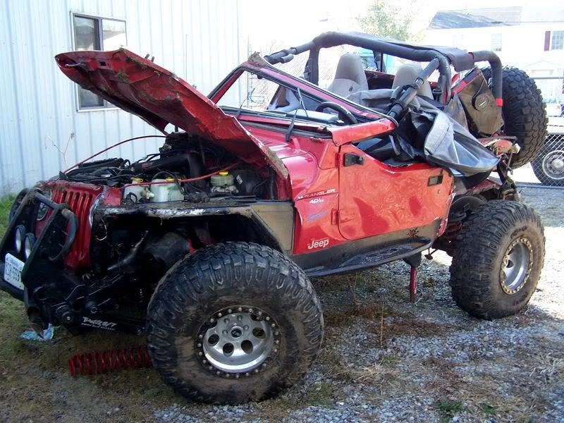

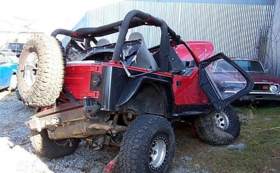

They were in a rolled Jeep so have some cosmetic scratches on the exterior
That's the same way I found my half doors. 😬

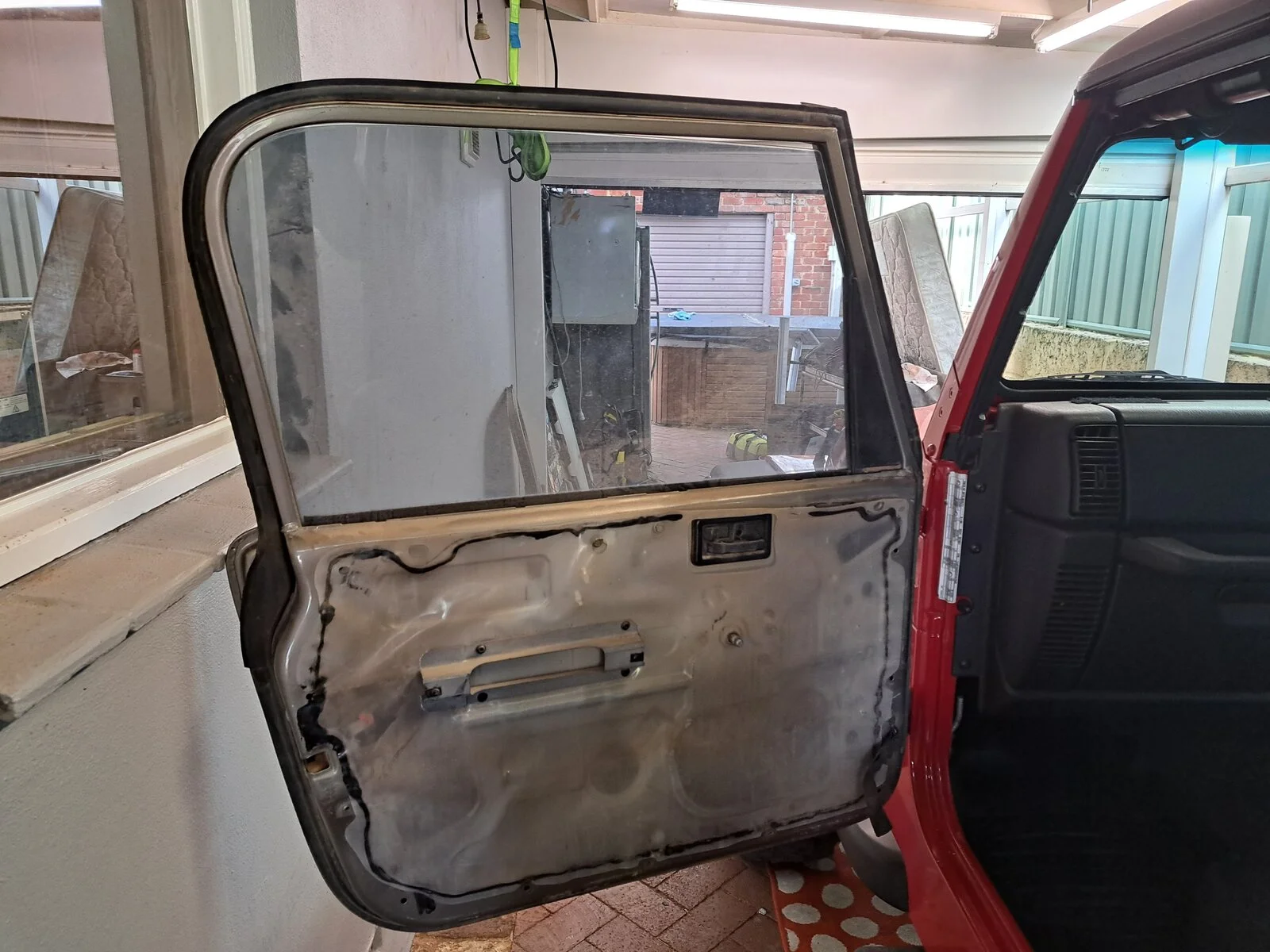

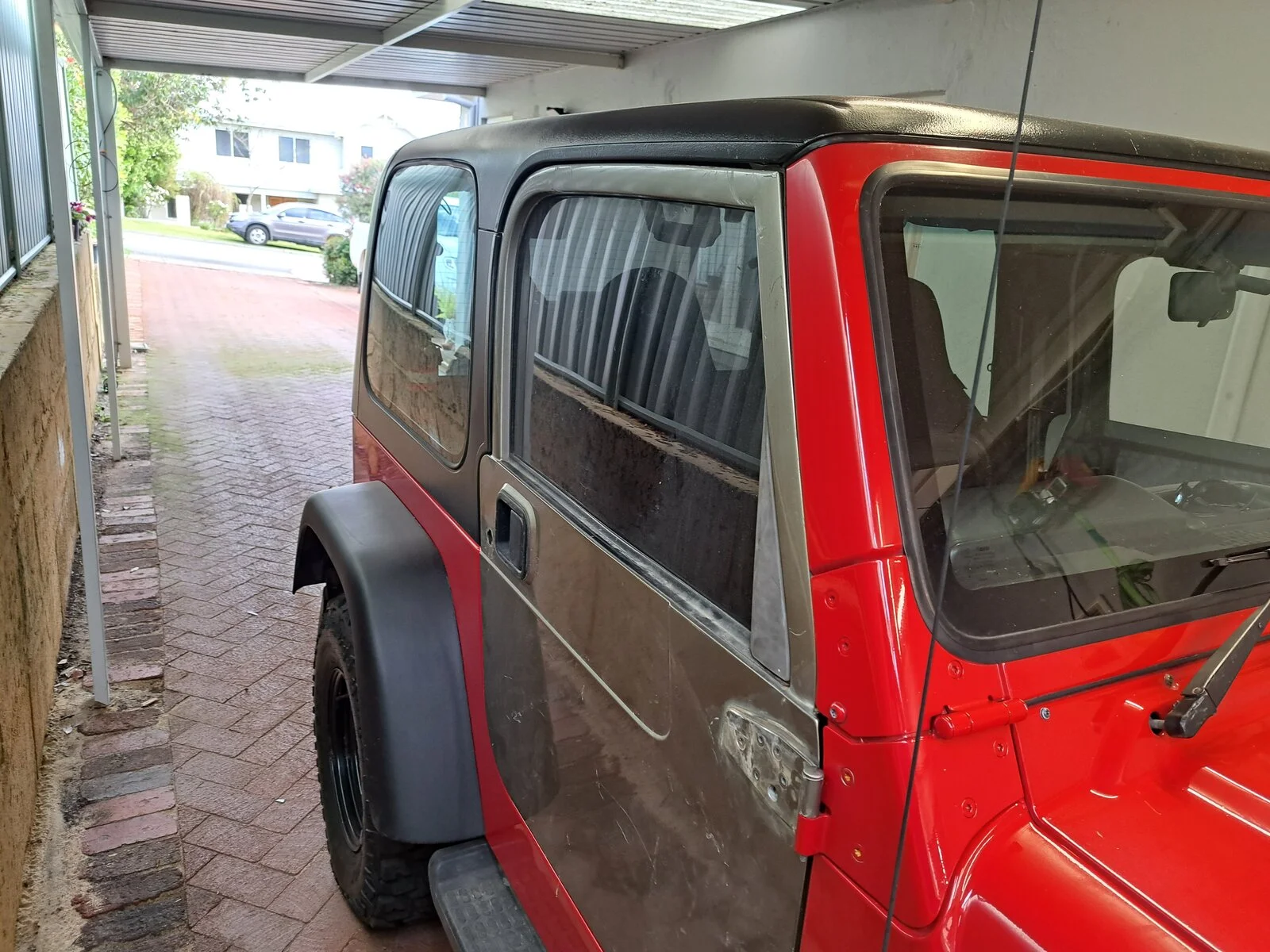

Couple of pics of the drivers side (RHD) door from the outside and the passenger side from the inside. As you can see, pretty dusty and a few small scrapes on the exterior but will come up a treat once repainted. Inside...not so much! I'm thinking of building up a card using that expanded PVC sheet material as per some of the tutorials on Youtube. Wreckers here in Australia want more for the door cards than the doors themselves cost and freight from the US is prohibitive.

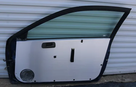

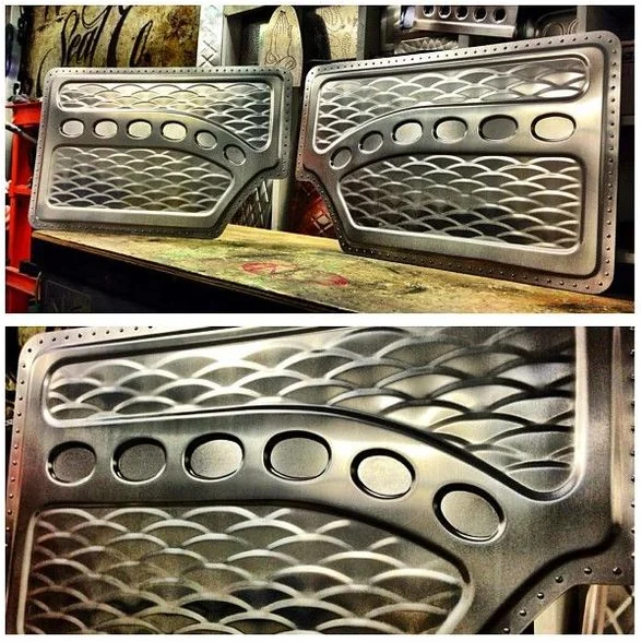

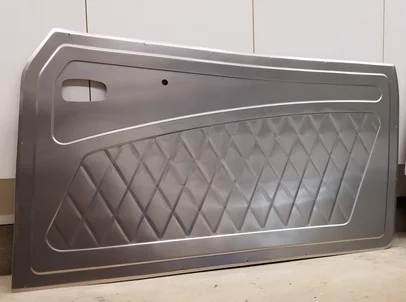

What my friend did was use aluminum, but this was in a hot rod, and he was getting a little fancy (he has the tools).
Simple aluminum, or get fancy.
