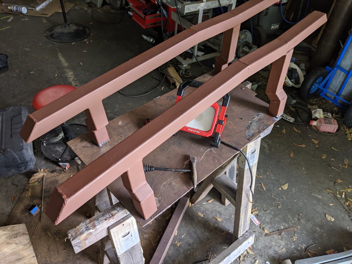

Got em primed this afternoon. Tomorrow, I should get them top coated and decide whether to weld them in or make clamps to bolt them on.
I like the idea of having them be removable, but I also like the structural rigidity of having them welded on. Decisions...

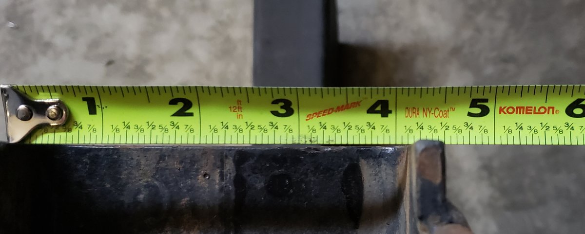

06lj
Jul 14, 2018
1,433
Arkansas
I couldn't remember how tight or loose they fit. I went out to the garage and slid one of the brackets on. It fits like a glove with no slop at all. The inside measurement of the bracket is 4 3/16".
Reactions: JMT

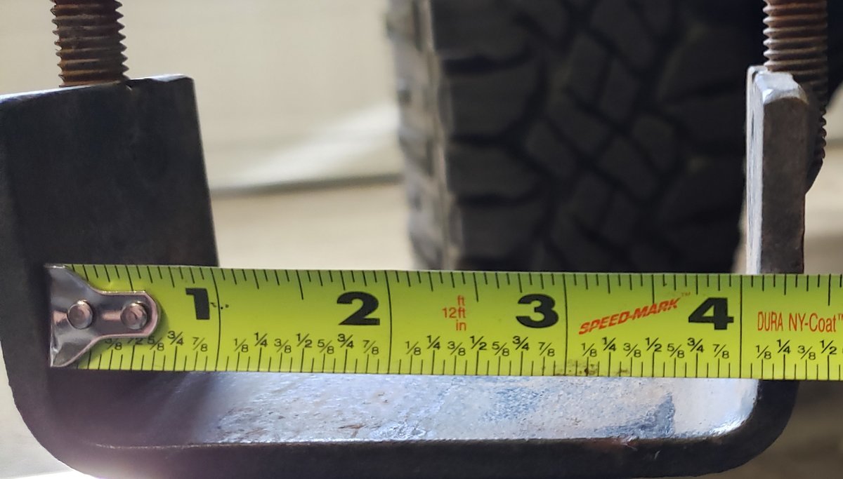

500
Deauville, LA
Just measured mine again, they are 4-1/16" and have the same 1/16ish slop on multiple places on the frame. If you can, get a measurement inside to inside on the "u" part and see if it's the same as the open part of the clamp.
I'm gonna go with what I have anyway. Like I said, I'll just add some weld beads as a shim if needed
