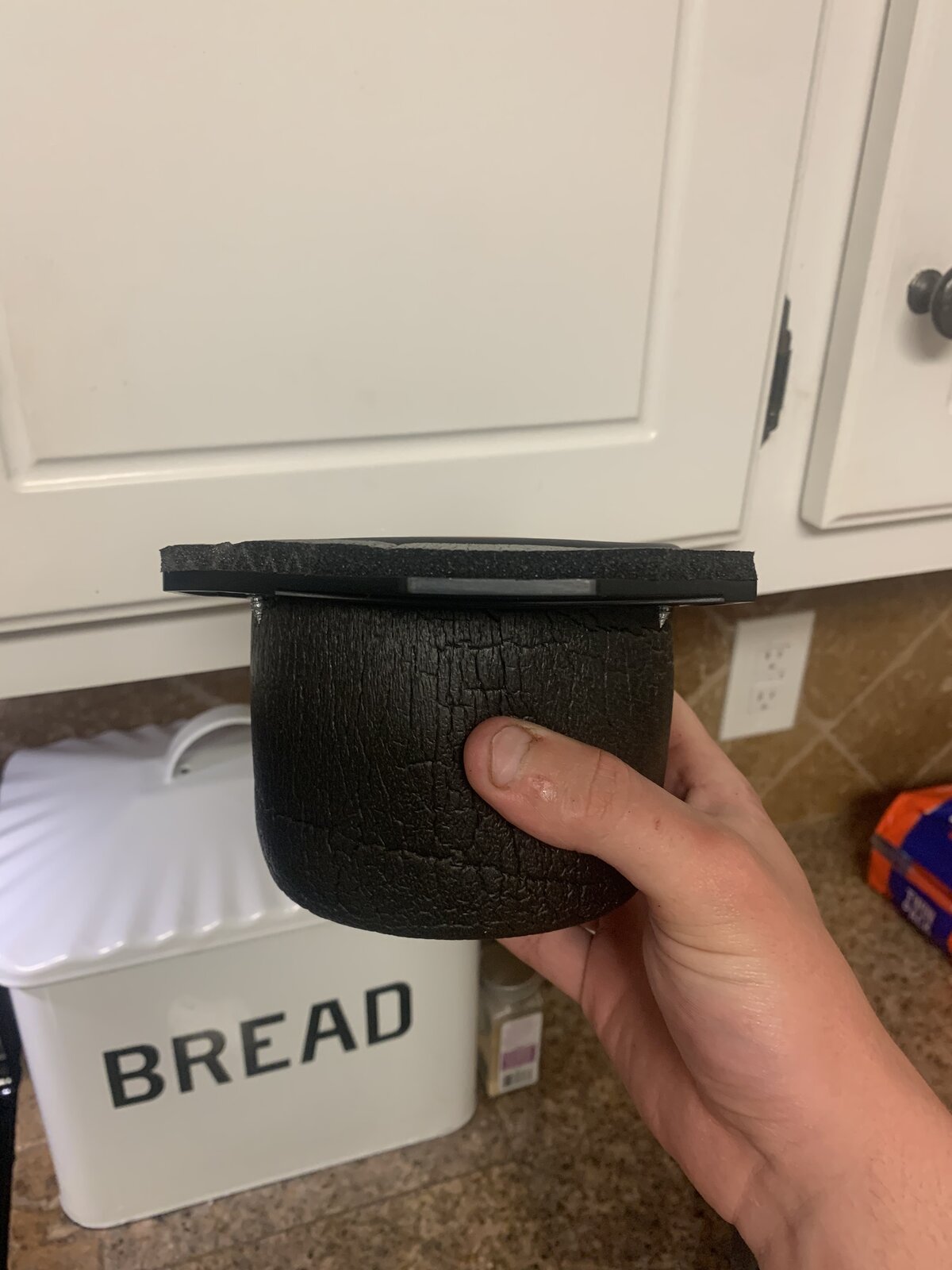

What’s your guys thoughts on this idea?
DIY speaker pods, even better than than the real thing? We all know that sealed enclosures this small don’t do well, including the pre made dash pods. You lose a lot of bass due to the small volume inside. This is alleviated by the “port” in the back on these. The reason you need these is so the sound doesn’t get lost behind the dash and is projected outward. To further enhance this, you might add a 5.25” foam ring as I may in the future.
Went with higher end infinity reference speakers due to high sensitivity rating which will be perfect for the Jeep. Will update with a sound clip once they’re all in tomorrow. Plug and play with wiring kits from crutchfield. Speakers are currently on sale as well, been waiting on them for a while so I snagged them while I could.
Is there really bread and butter in those containers? :unsure:
p.s. Stop biting your fingernails and let them grow out.
p.p.s. Nothing will make little speakers produce decent bass.
Surprisingly yes, they do contain both bread and butter.
Not gonna happen.
You are correct, it’s just more for a full range of sound.
That is exactly how I did mine, FWIW. No idea how good/bad it may be vs "real" pods or open speakers. The foam rings on the frontside however, gave me a real volume increase.
As for the fingernails, paint them the color of your choice - then you won't bite them! ;)
I know it’s better than open speakers, but not sure vs actual pods. I believe these are a bit larger than the pods and plus they now have the hole in the back. I may test by covering the hole on one and see which performs better.
Maybe I should start a thread about my fingernails 😂

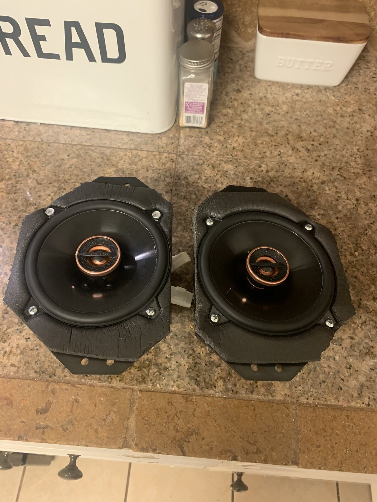

Got them installed today. Did one side of the dash ported and one not.
Ported: more richness to the sound, more full sound. Piano sounded 100%
Sealed: very punchy, some sound gets lost in translation, mainly certain piano sounds are nonexistent anymore
Made both sealed and called it a day. I’m curious about your roll bar pod porting?
