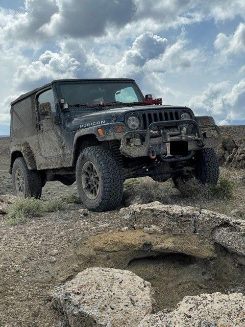

I do agree building around a 35 first would be wiser. The photos you posted is nothing extreme enough to want 37s.
Like Starkey said he goes everywhere he wants on 35s. Judging by his pics he might end up in the "tons and 4ds" club but he's learning how capable his rig is now and improving driving skills.
