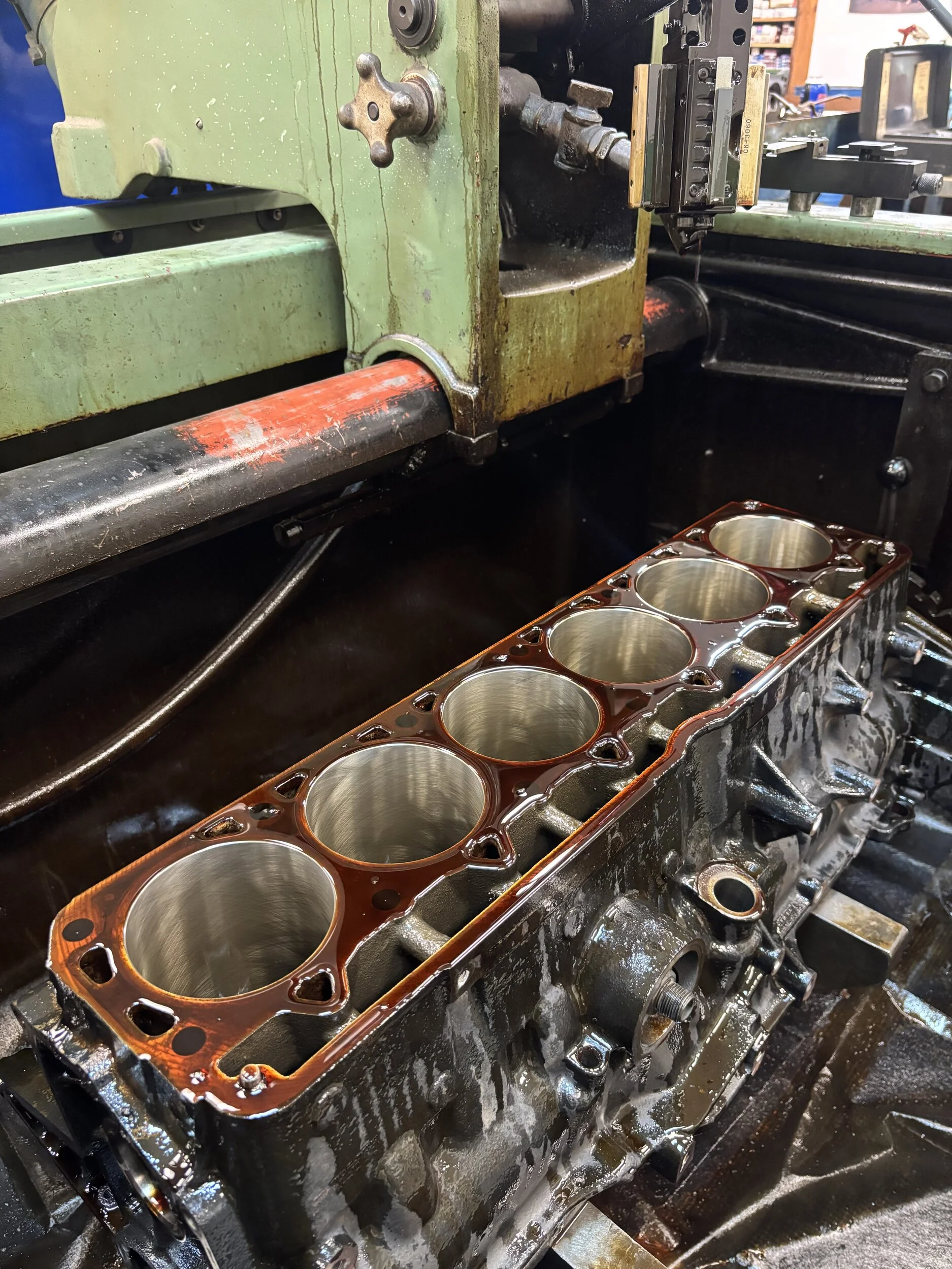

Engine is at the machinist. Bores are coming out beautifully. He found 3 bent exhaust valves (minor, but noticeable), so those are getting replaced.
