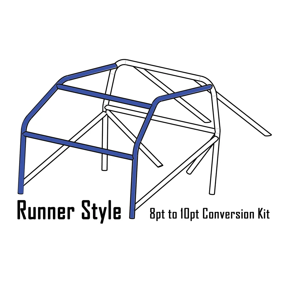

Here is a front cage add-on thru the dash kit. I don't know anything else about it other than what is on their page. So if you order one you'd be the ginny pig.
https://swracecars.com/product/10-point-cage-conversion-dom-jeep-tj-1-3-4/
Includes halo hoop, dash bar, (2) windshields bars. Tubing not notched
5-point harness when I start serious crawling (need cage first). Factory belt for now. No plans for high-speed off-road.
