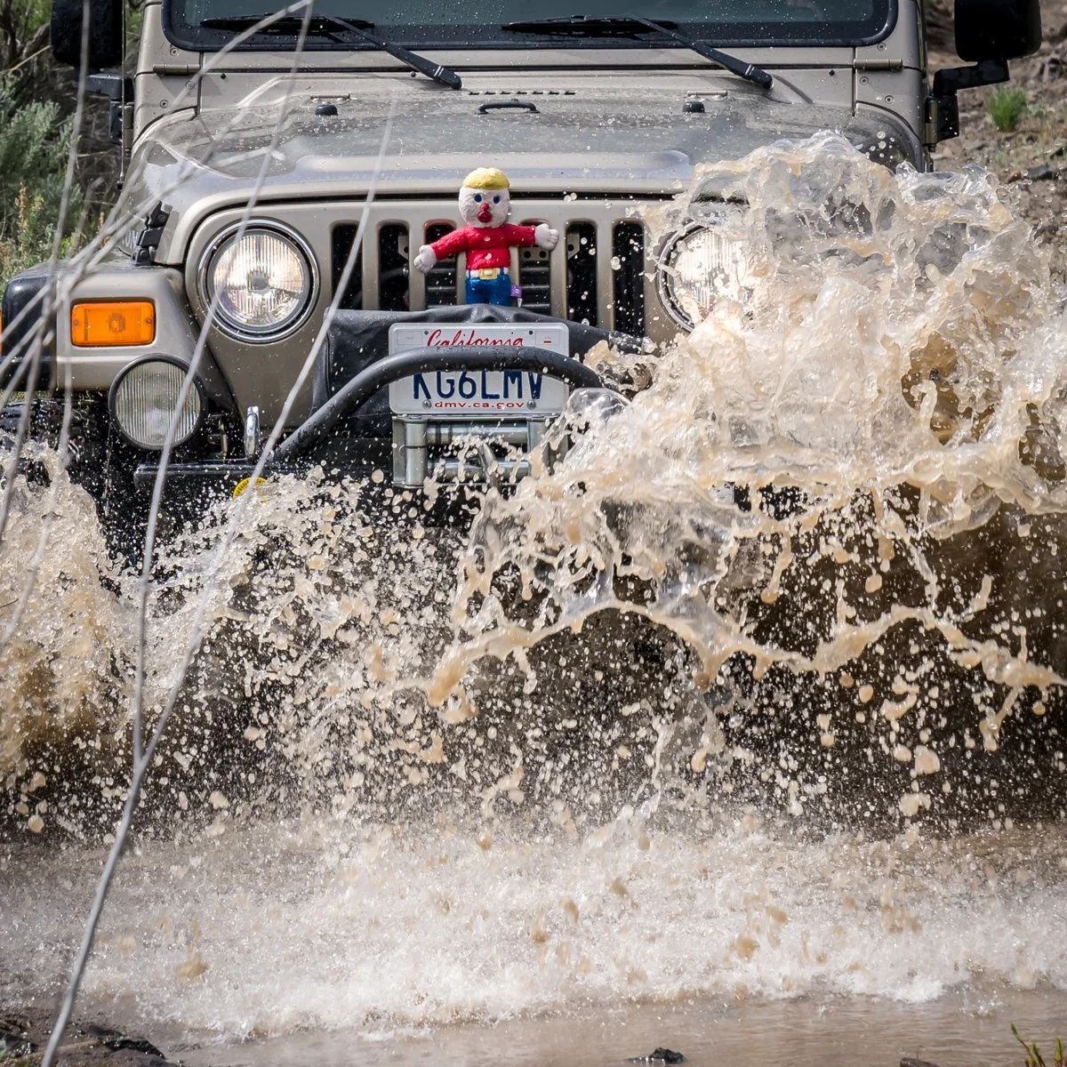

I've noticed no ill effects from my "grill insert." He's been in that spot through two hot summers and no engine overheating yet.
