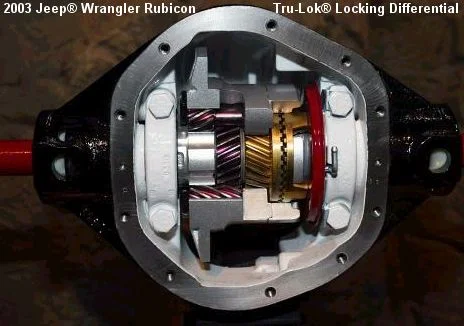

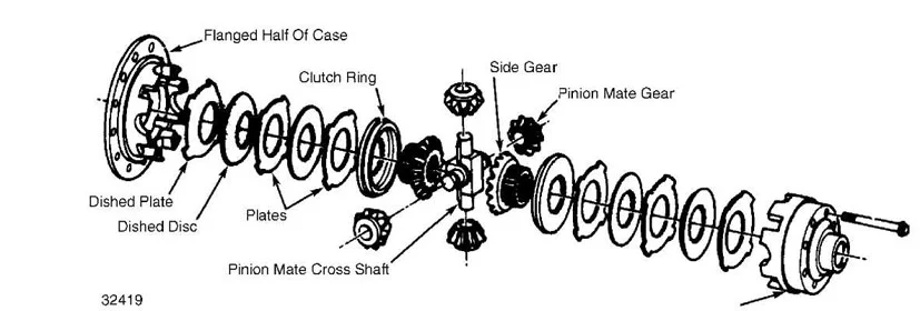

If I remember correctly, the Rubicon limited-slip is a gear type (like a Detroit Tru-Trac) while the non-Rubicon models got a clutch-pack limited-slip (like a GM Positraction). I think it was only the clutch-pack type that needed special lube.

I was able to find this: The Rubicon TJ had a Tru-Lok in the rear, it's a gear type limited slip combined with a manually selectable locker and does not need special lube. The non-Rubicon models had an optional Trac-Lok that is a clutch type limited slip and does need special lube.
Trak-Lok
Tru-Lok
Reactions: Steel City 06

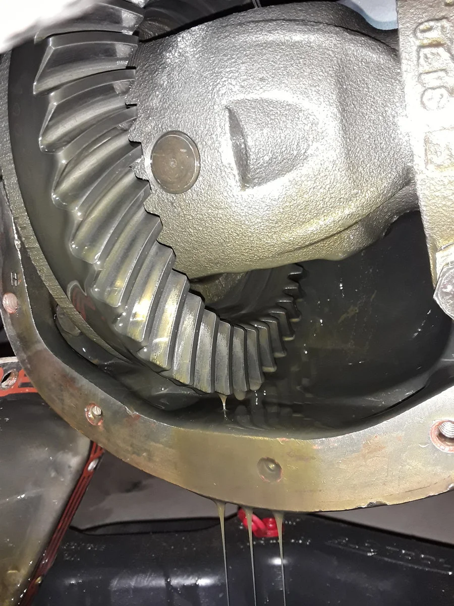

if you get a gear oil labeled that it's for limited slip differentials, you don't even need the additive and this all becomes a moot discussion.
Either way, you'll know when you pull the cover off because the carrier that contains the spider gears on an open differential is bell-shaped,
while the limited slip carrier is more cylindrical.

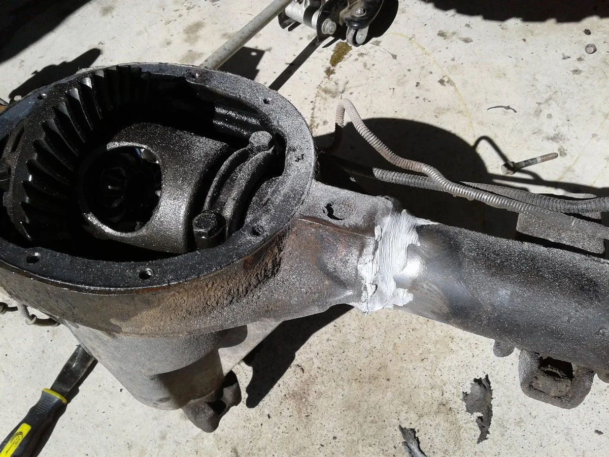

Thanks to the OP for the question. The PO of my 02 TJ put a Dana 44 under my Jeep, and I was wondering how I could tell what I had in it once I pulled the diff cover. Now that I've seen the pix of seemingly every variety of rear end, I'll be able to answer that question. 😺

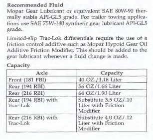

Do you know the exact Fluid Capacity for the Dana 30 and the Dana 35? (For 80w-90)
181 FBI refers to the Dana 30, 194 RBI refers to the Dana 35.
Converting the liters to quarts, it looks like 3.001 quarts. I wouldn't have guessed that was enough, but that's the numbers.

The best way to know for sure is to pull the rear diff cover. An open diff looks different from the factory trac-loc like shown above.
Yes, the Dana 35 can get the trac-loc from the factory. Mine came that way. I replaced it with a Detroit TT when I had it regeared.
