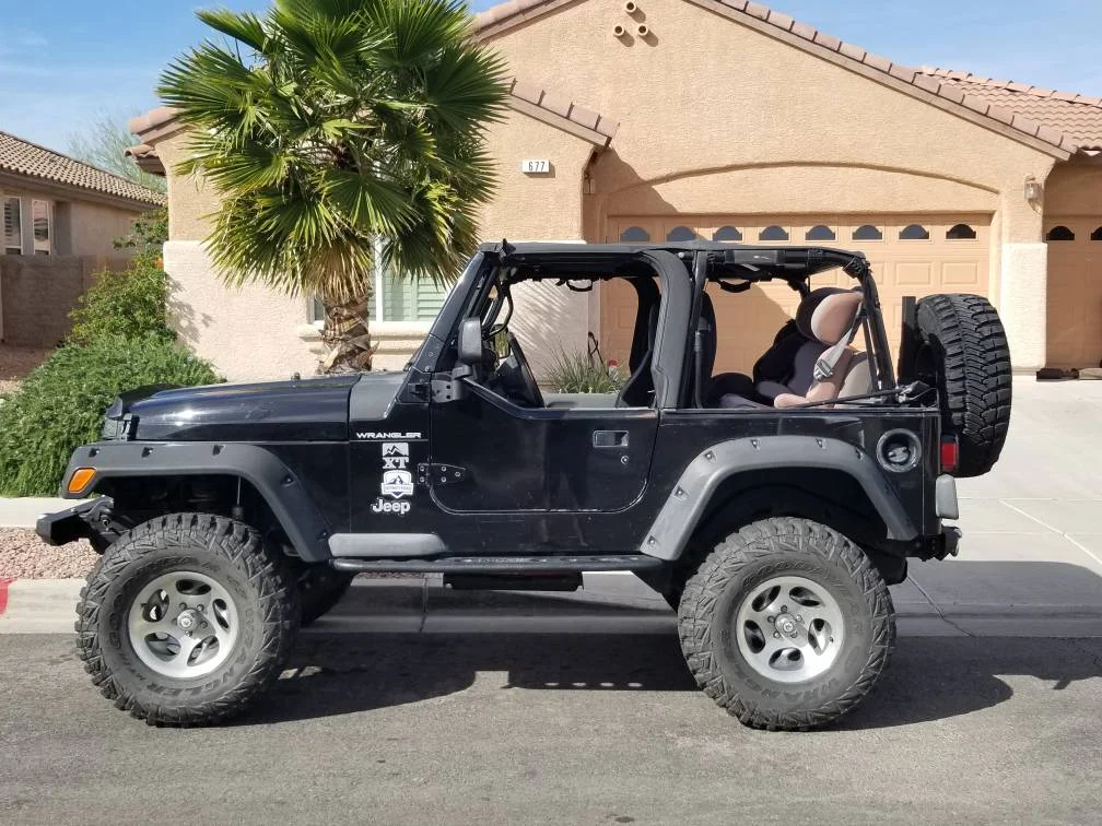

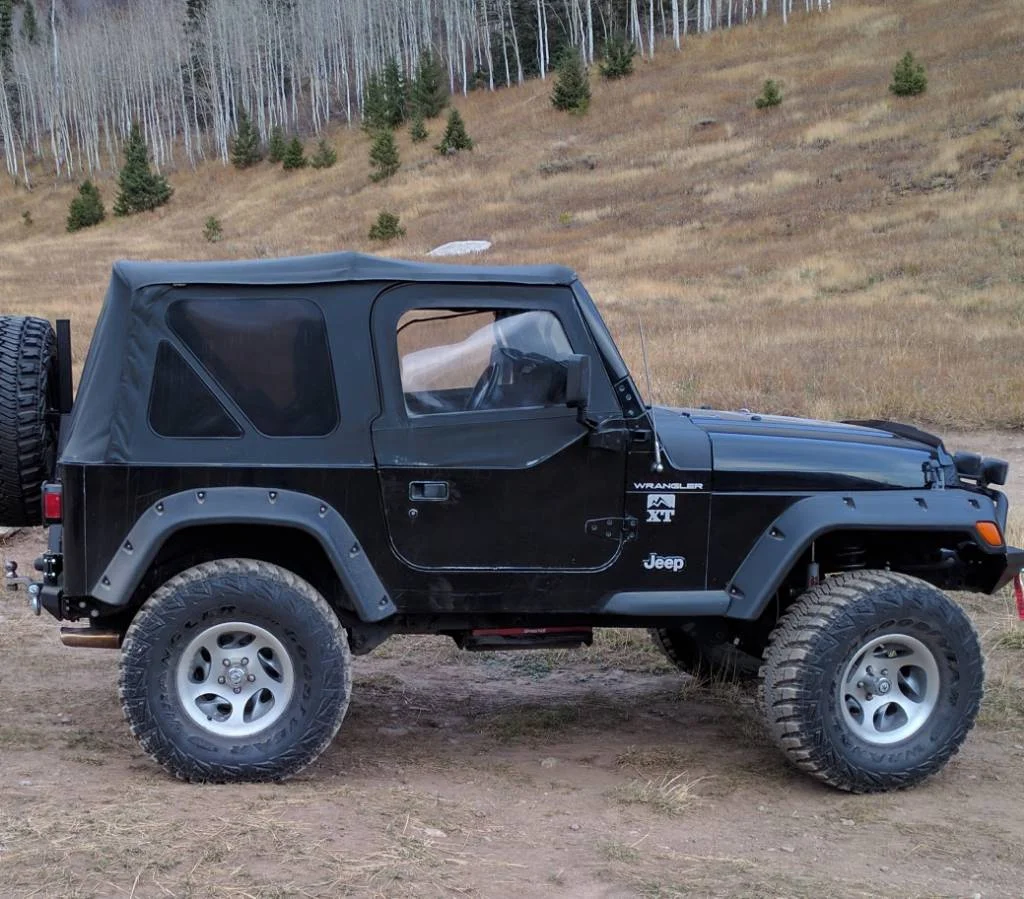

So my Jeep has a 6 inch rough country kit (don't hate) and it used to sit perfectly level with even space between the tire and fender, front and back. Then a V8 landed in my engine bay and it squarshed my suspension down in the front and ever so slightly raised the rear. Do I just add a coil spacer to account for the difference or look for a stiffer set of 6 inch front coils or what? I'm not sure what the best way to go is.
Before:
After:

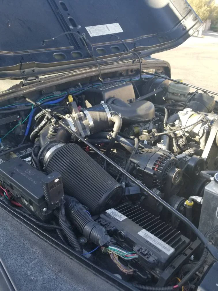

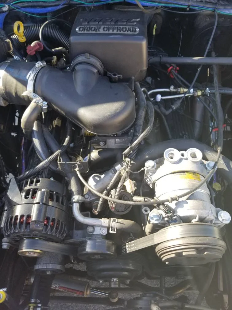

Here are some poor lighting engine shots
Sent from my SM-N950U using Tapatalk
Yeah, I'm going to say that the best option would be to find some springs for the front meant to handle more weight, but I'm not sure you're going to find many that are 6" in height, since that's a pretty uncommon lift on our TJs. That being said, I'd put some coil spring spacers in, but to be honest, it looks pretty level to me in those photos. Of anything it looks like you could use an extra 1/2" in the rear.

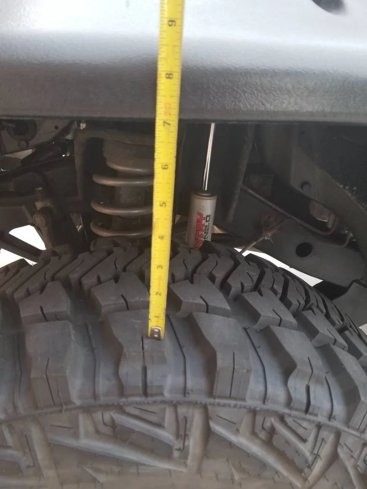

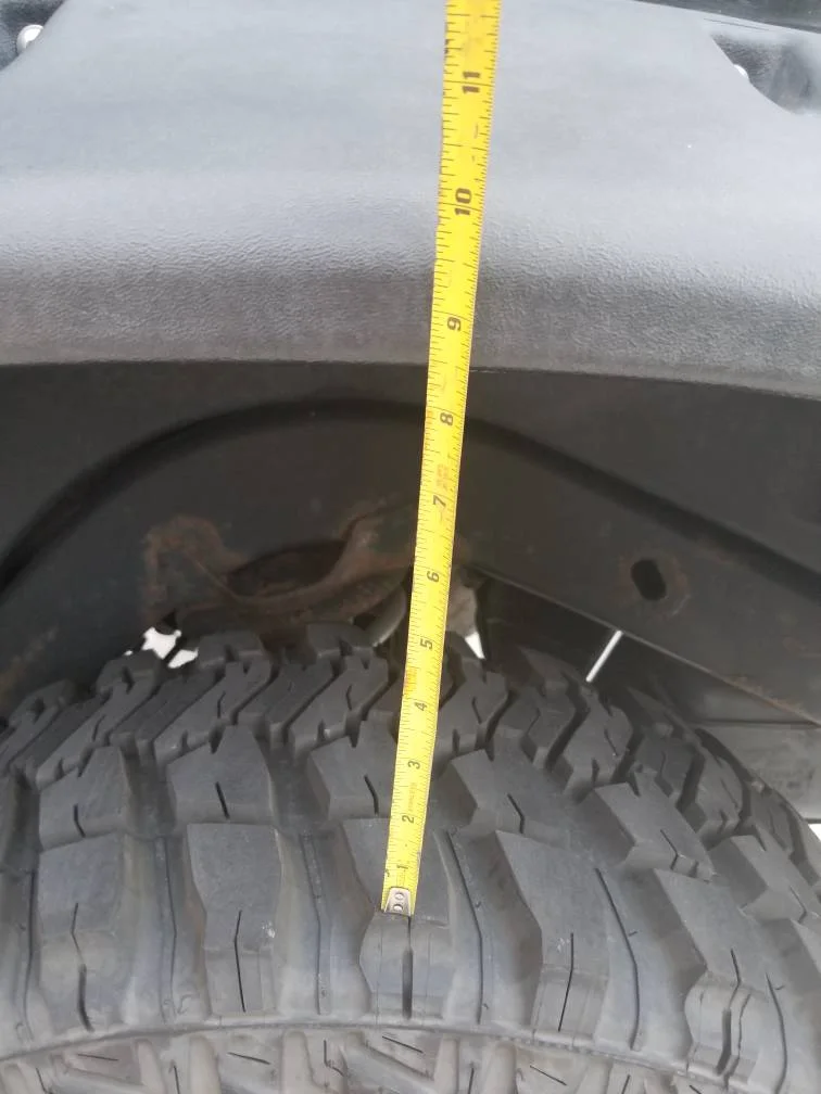

My assumption is that companies set coil rates for the 4.0. I have yet to see aftermarket coils specify 4 vs 6 cylinder. A spacer would help, it looks like you have one already. I would measure from flat ground to bottom of the frame to see how much rake you have. Going to be far more accurate than measuring at the flare.
Nice engine install, bro! Also, love, love, love those wheels!
Got to agree with Chris; that looks pretty level to me. If you are happy with the current ride, I'd either stick with the way it is or do spacers. Going to stiffer springs (if you could find them in 6" lift) will...well...stiffen the ride, which may not be entirely desirable.

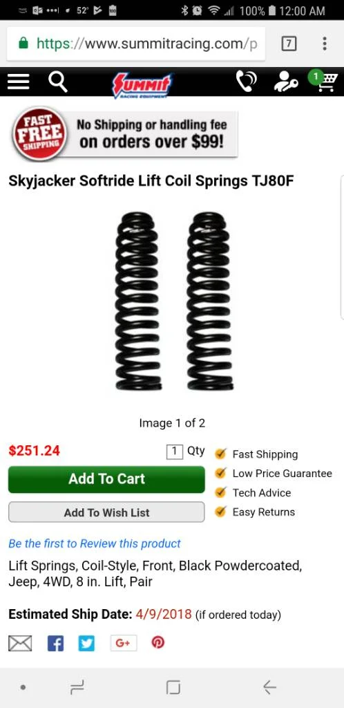

So I didn't realize I had a spacer already, never really paid attention so thanks for pointing it out. So assuming I have rake based on frame heights and the distance between the two measuring points I can calculate what it would take to level me out. I wonder if I could remove the spacer and go to these 8 inch coils instead
Agreed. It looks completely level and if anything looks higher in the front (despite measurements proving otherwise. Is it more noticeable in person?
That’s what I’d be looking into, 8” springs for the front, or a 1.75” spacer with the 6” springs would be just fine
The top picture is pre V8 where it was level. The bottom two pictures are the change with the v8

The rake doesn't look bad. If it really bugs you, measure that current spacer (looks like about 1.5") and see if you can get a spring to make up for it. Maybe those 8" springs with a 3/4" puck in the back?
Looks like a child seat in the back...do you carry much weight back there besides that? Some rake is preferable IMO, for loading stuff and not dragging the rear. I was expecting to see a lot more rake than is in that photo...

What is your current ride height, front and rear? Measure the springs, including the spacer.
