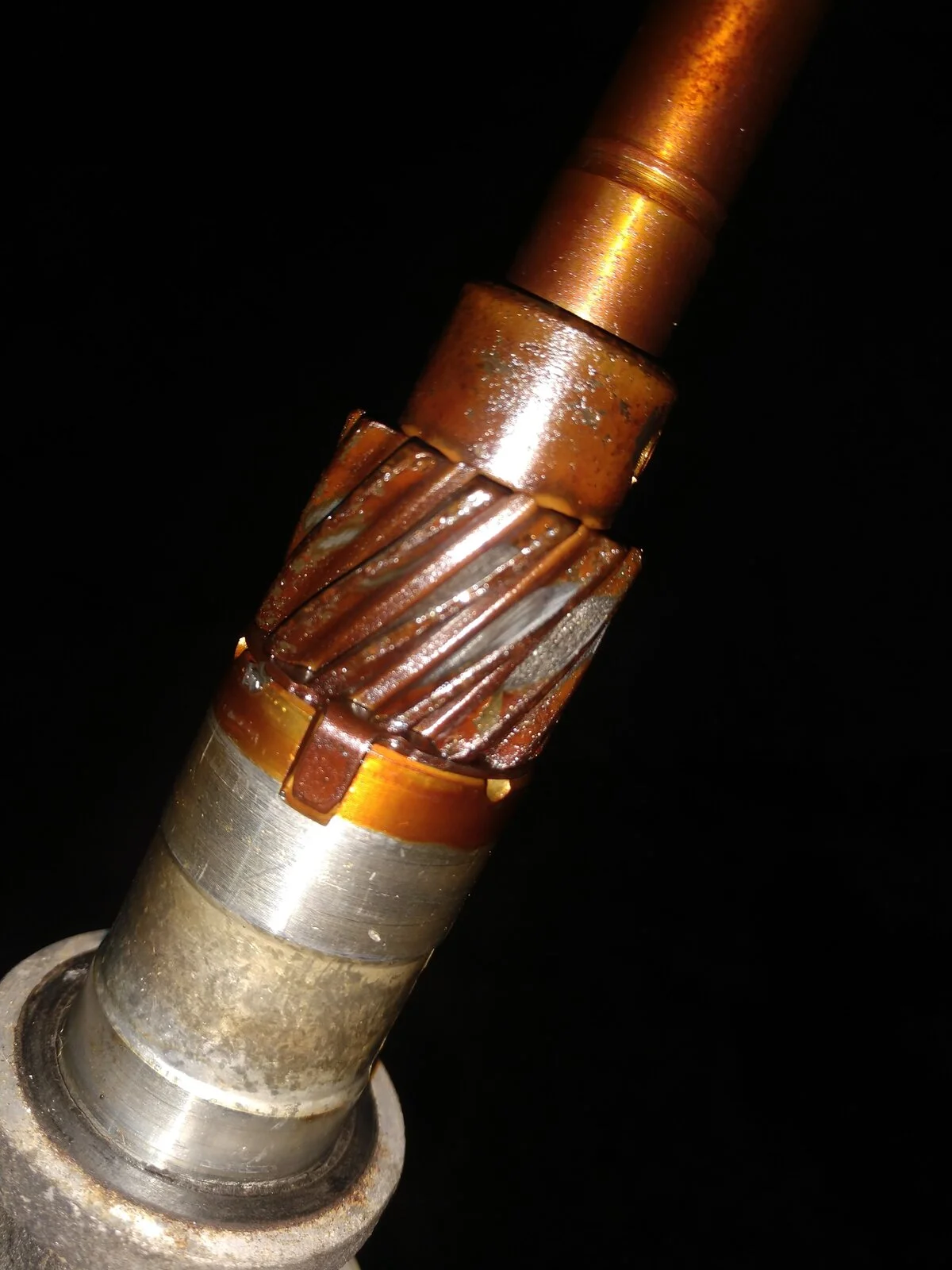

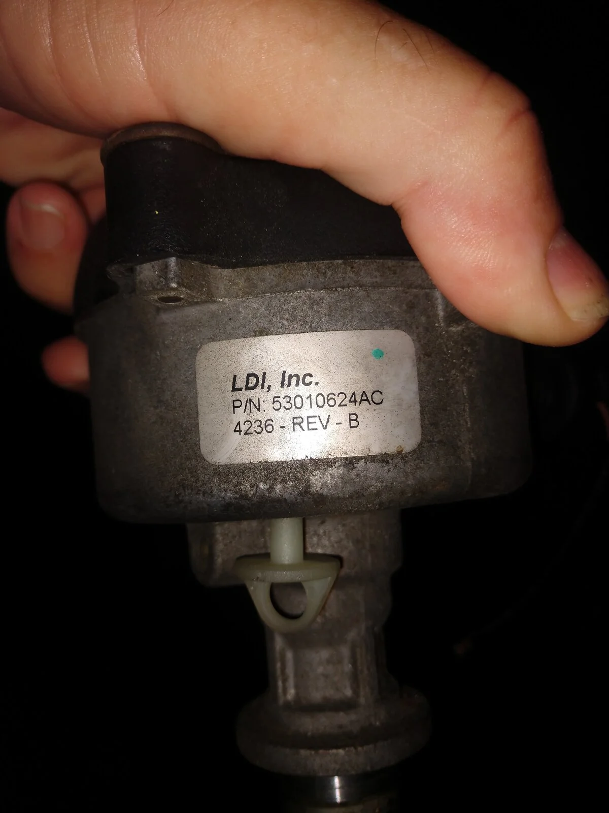

Thanks for your response. I have not changed the oil recently. It is over due. However, I bought all the supplies yesterday to do an oil change and I will do that this morning. I have run traditional Pennzoil 10W-30 motor oil, but am changing this time to a synthetic blend 10W-30. I did not think that the gear on the OPDA was chewed up. Some wear, but didn't look that bad to me. I changed the OPDA because I had read all the posts on the forum and did not know if it had ever been done.... ounce of prevention, plus I was having low oil pressure. I never heard the "squealing monkeys". I did not really look at the camshaft when I changed the OPDA. I just assumed a new OPDA would fix the problem, plus the gear on the OPDA I took out did not look that bad. Pictures of the old OPDA that I replaced.

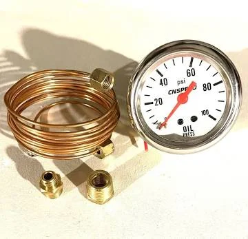

as he said get one of these
Plastic hose is fine and screw it into the block in place of the oil sender. Any time oil pressure is in doubt on all years tj this is the first step.

If you are questioning the cam gear on a 05-06 TJ with the history of their issues, then the only way to confirm is pull the OPDA and take a look at the cam gear or drop the oil pan (not recommending this option) to take a look.
OPDA wear is not indicative of the cam gear. That's the simple answer for the F'ed design we got in the 05-06 design...
